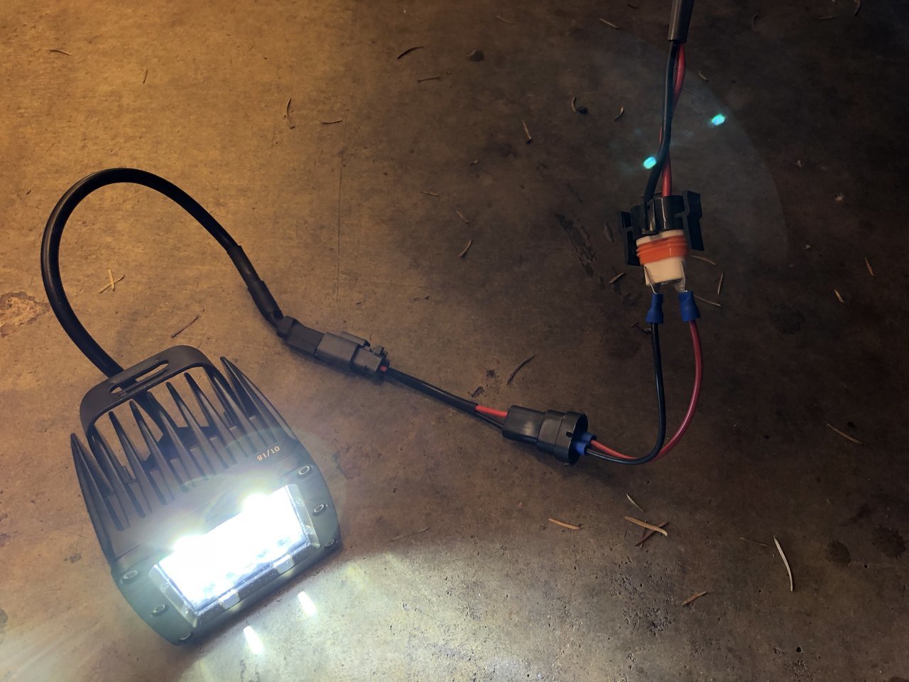

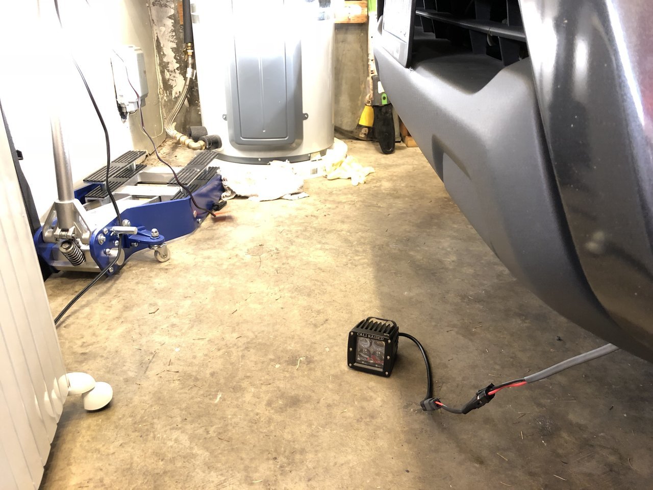

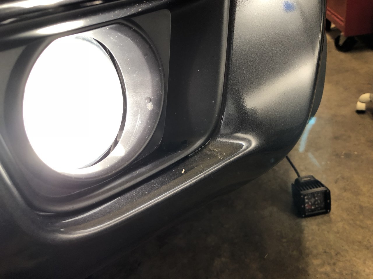

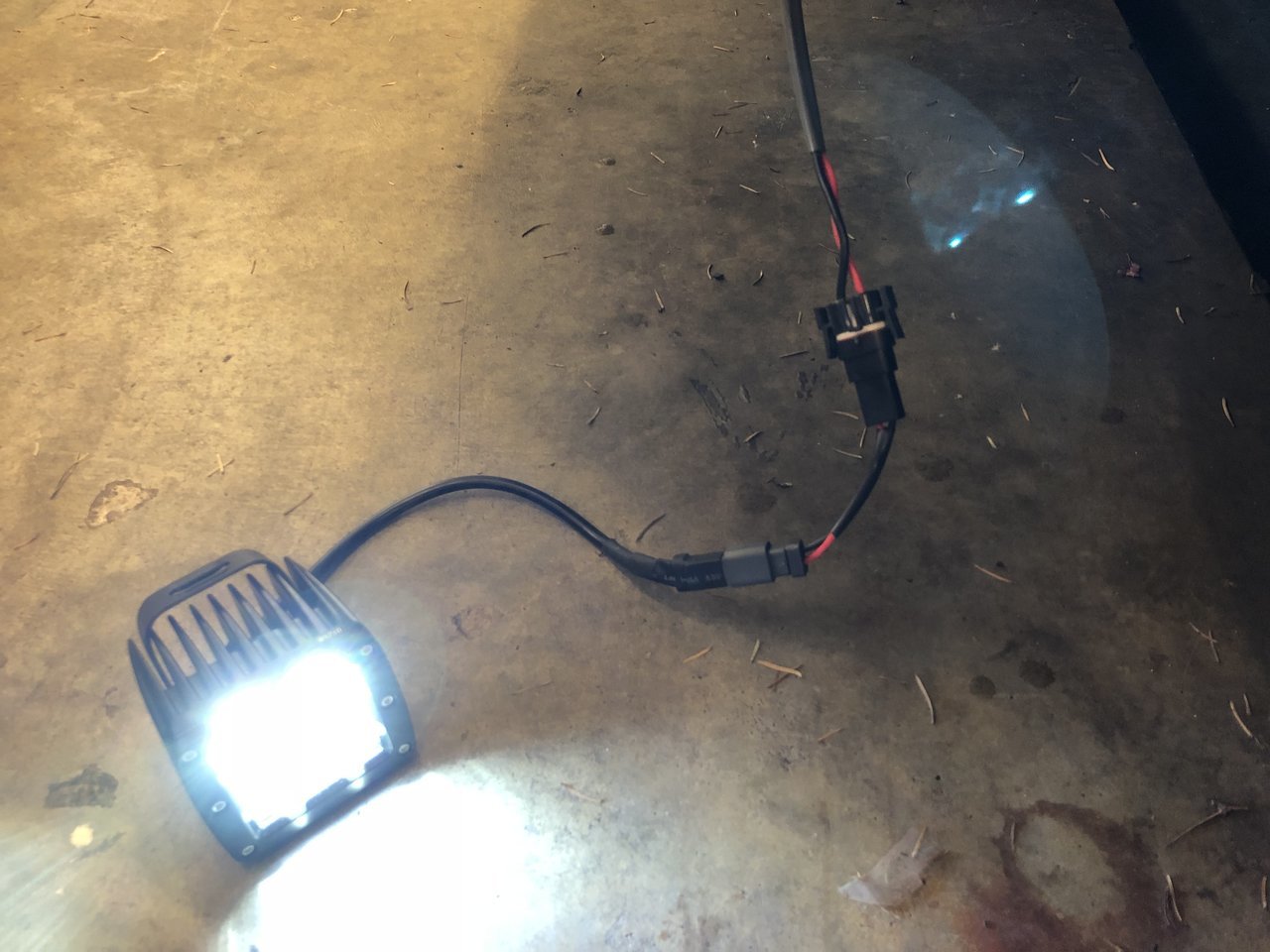

    Well this is shit. They don’t work.
    Excuse my freakishly long fog harness as it was a prototype.
    Fog on, LED hooked to fog circuit not on.
    Other side so you can see it is hooked up but not on.
    I’ll cut the adapter and swap the polarity.

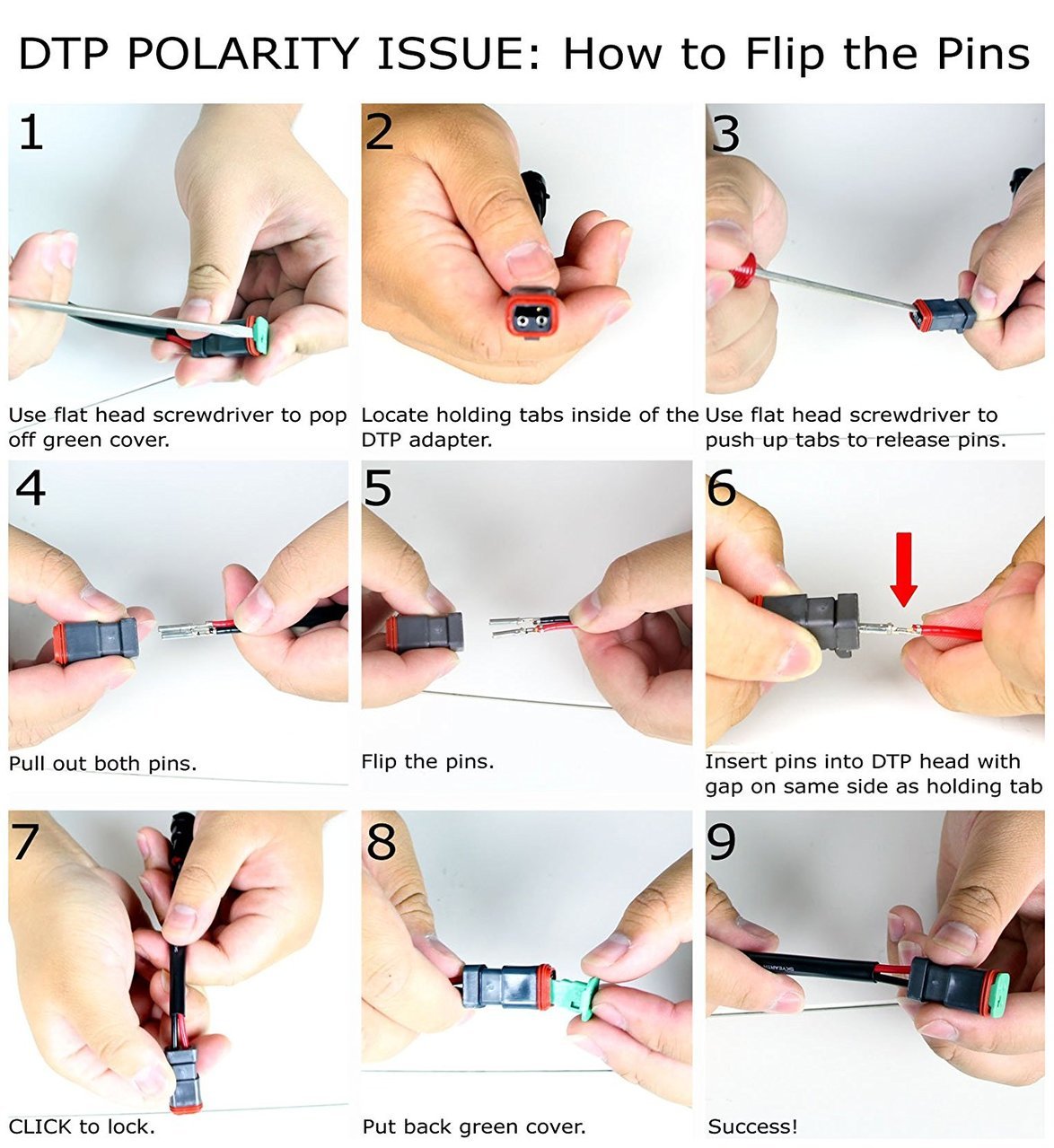

    Hello,
    Use this picture as reference. This issue happen every once in a while. Toyota for some reason makes the fog light harness different on every truck. So sometimes they are just flipped. If change it like in the picture you should be fine. Let us know if you have any questions.

    DONT cut. Deutsch connectors can be unplugged and wires switched.
    Use a small flat tip screw driver to pry the green cap off. Once the cap is off, you will see one tab on each connector holding it in the housing. Use the screw driver to push the tab away from the connector and pull the wire out the back a little. Do the same on the other connector then pull both wires out the back. The rubber grommet may or may not come off with it. Then just put the wires in the other spot on the housing and push the grommet back in place and put the cap back on.

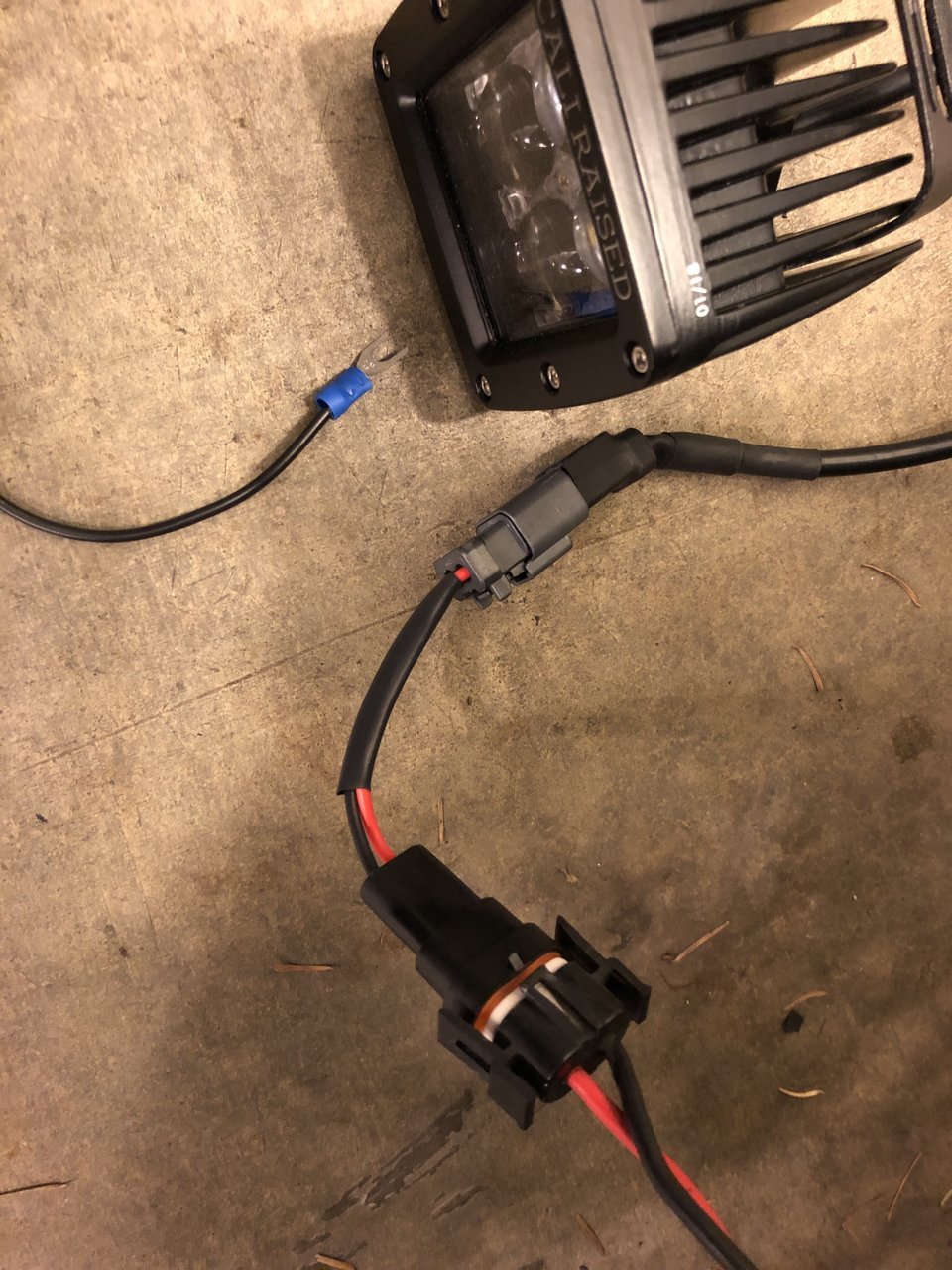

    Closer look it is pretty obvious why. They are wired backward. Red connects to black.
    Built some connector wires to reverse the polarity.

    Here’s our instructions for it

    Crap. I took the time to type it out and you had a friggin picture.

    Jumper wires removed. Instructions followed to swap polarity. Fixed in under a minute.
