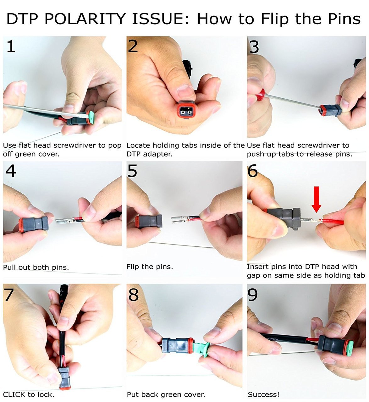

    Ya I followed the pictures and it was sorted

    Just got my fog lights installed today and I had to do this for my 2010. No instructions, so thankful to my girlfriend for finding this thread. Easy to do since I have some experience with wiring.

    I just had to do this today to get my LED fog lights to work. Pretty disappointing they didn’t come wired the proper way.
