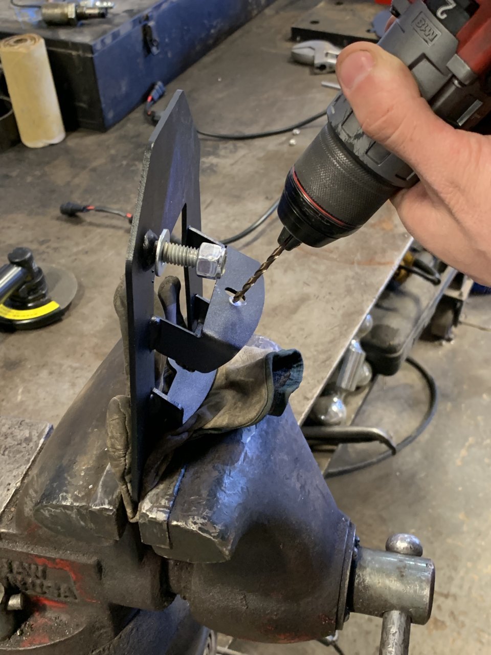

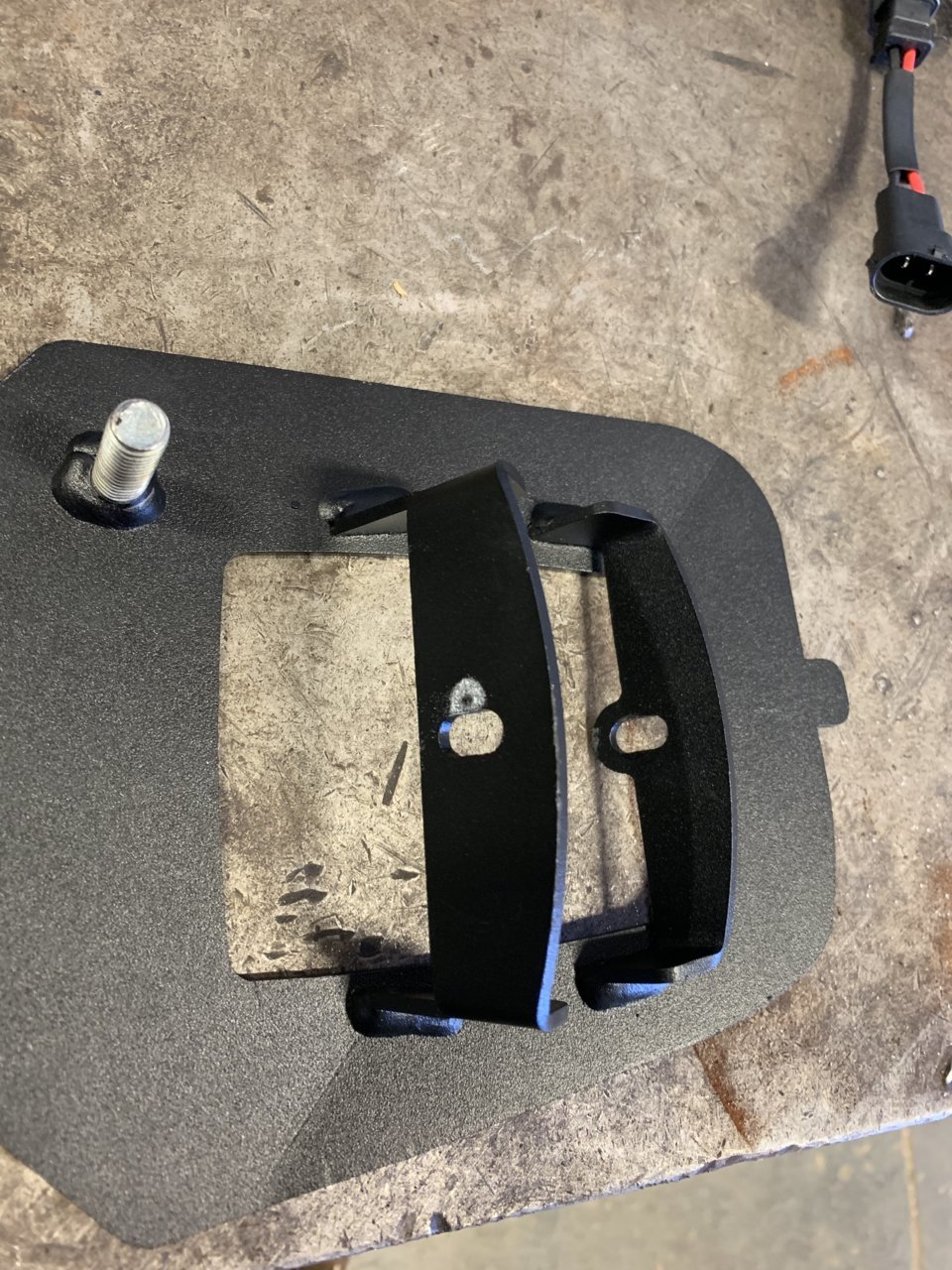

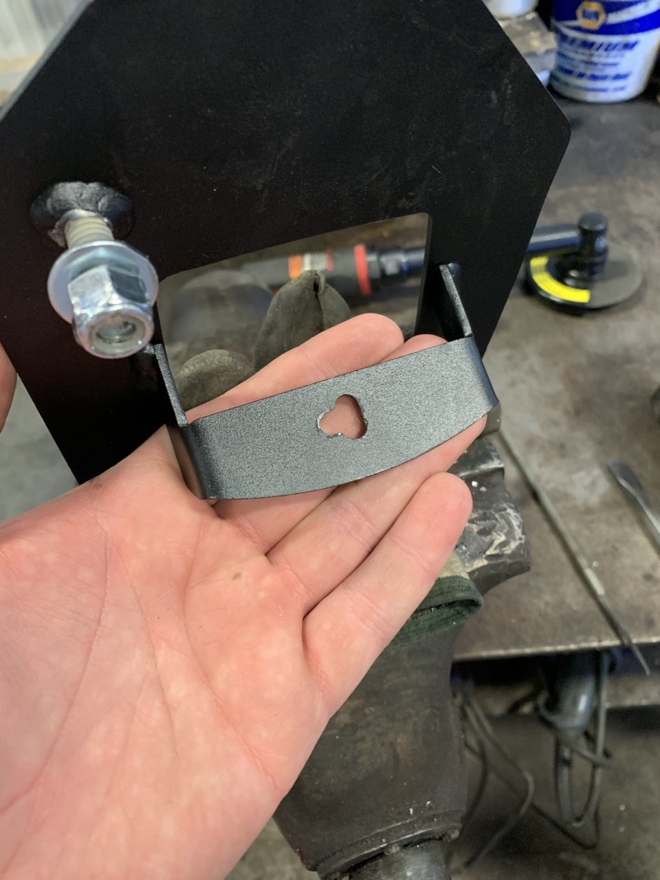

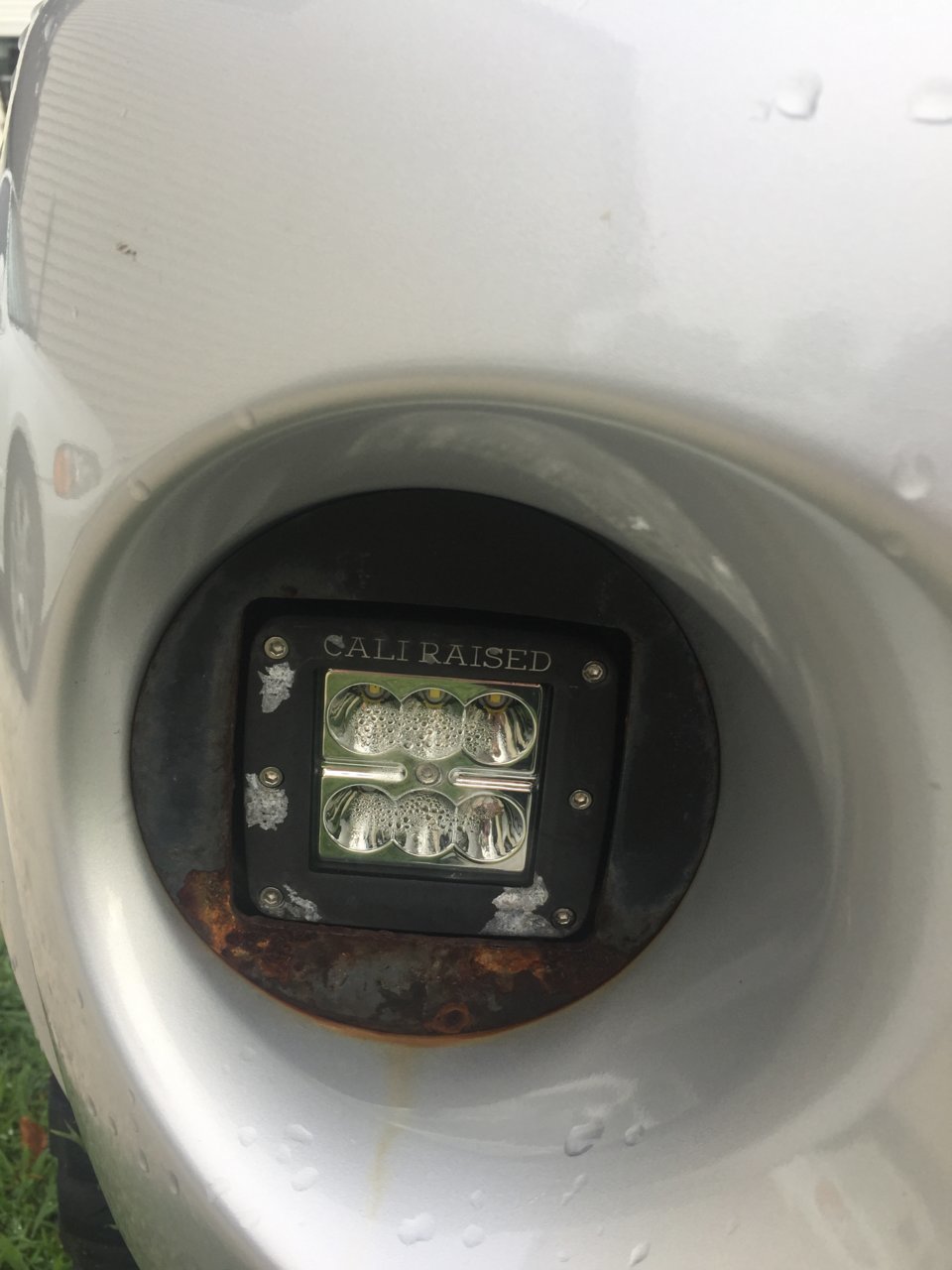

    Welllllll..... it took time... but they’ve been modified to allow for the rear of the light to adjust up so the light can shine more down. I had to add washers to the inside of the light for something to create some traction for the nut to grab. I repainted the Cali Raised Bracets with Flat Black Rust prevention paint. I marked where i wanted the new holes with a soap stone, drilled my new holes, and spent way too much times messing with a chain saw file. I should’ve gone to Home Depot and gotten a metal cutter for my Dremel but i was low on cash. But here you are. These baby’s dont move. I pushed and tugged and bopped them every which way to try and get them to come lose and they wont. Over all worth it. I had fun playing with the install.
    I will say the big fall back of these, i wish Cali Raised LED didnt make it so difficult for those that want to use these as everyday fog lights to do so. I understand they are not street legal. I am taking that risk on my own when i install them. It’s more a risk to have a bracket that has to be overly modified to not be a danger to other drivers. I spoke with local law enforcement and they said there was nothing illegal to them about the post modification i made to these because they are not a danger to other drivers and fall under the amber color that is legal here in Arkansas. Food for thought for Cali Raised. Make the brackets with lower light positions.
