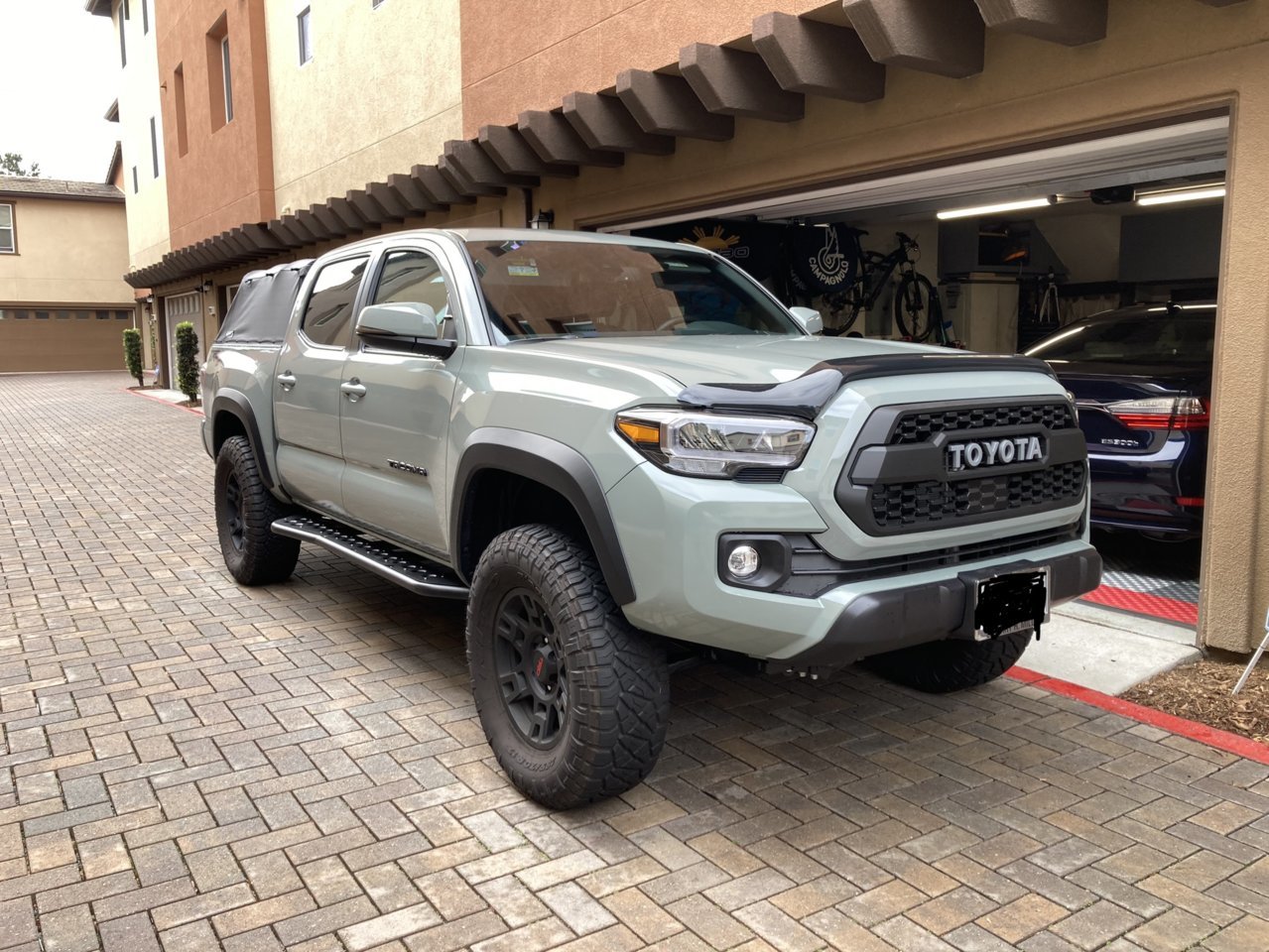

  15. Jan 5, 2023 at 10:26 AM
    #95
    crashnburn80
    crashnburn80 Vehicle Design Engineer
    Jun 6, 2015
    #156893
    14,751
    Kirkland, WA
    2003 DCSB TRD OR
    Replacement lights for the fog location. Not fog lights.
    Stock Pro Fog lights
    CaliRaised pods lights
    A fog is a wide flat beam with cut offs to illuminate the width and edges of the roadway. This is so you can find the shoulder in poor weather at slow speeds while not blinding other drivers and not causing the light to reflect back at the driver, often referred to as cutting under the fog. The spot patter does not illuminate the edges or width of the road way, it will not help you find the road in fog, it does not have cut offs so it will blind other drivers and will cause reflective backscatter at you the driver. Aka, they are not fogs.
    20somethingwidataco likes this.
  16. Jan 5, 2023 at 10:43 AM
    #96
    Cocotaco
    Cocotaco Member
    Dec 19, 2022
    #413546
    15
    I see your point. But CaliRaised sells a fog lights and a ditch lights.
    I opt on the ditch light cause I will be placing them on the hood.
    The 2nd pics attached, could that be a ditch light installed on the original fog lights?
    I’m just trying to understand cause I am new to this expensive hobby beside my cycling lol
    But I am all ear and open for so many suggestions for my future mods!
  17. Jan 5, 2023 at 11:12 AM
    #97
    Cocotaco
    Cocotaco Member
    Dec 19, 2022
    #413546
    15
    My bebii for future mod!!!

  20. Jan 5, 2023 at 1:19 PM
    #100
    crashnburn80
    Jun 6, 2015
    #156893
    14,751
    Kirkland, WA
    2003 DCSB TRD OR
    The 2nd pic is the lights they sell for the fog location, not their ditch lights.
    Lots of info in the lighting thread I linked earlier or the aux driving beam thread.
