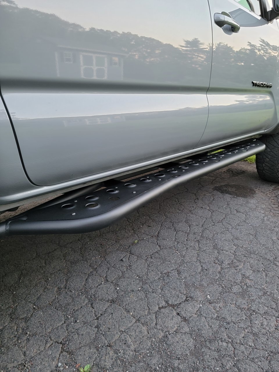

    I ordered the 0 degree ones so my wife can use as a step. I got them bare metal and had them powder coated locally. The only problem I had on the install was the 14mm frame bolt hole was off by about 1/8" on the driver's side slider which shifted it just enough to where the other holes didn't line up. I just installed it without the 14mm bolt for now. Other then that they're solid and look fantastic!20210605_201158.jpg

    Same with mine, a round file fixed fhat.

    Sliders look great!! thanks for supporting us.

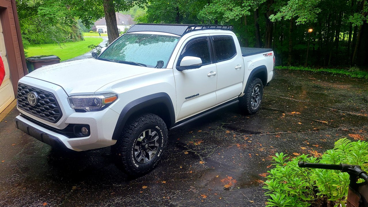

    Caliraised sliders.

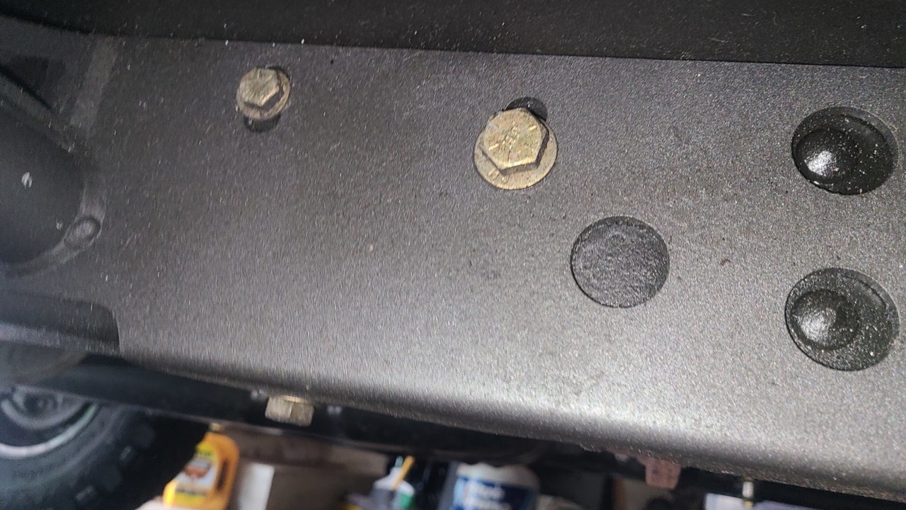

    This was the only hole that didnt line up well enough to get the bolt in. Passenger side, near the rear support. The smaller of the two bolts.I took a round file to it for a little bit and it was just fine. But THATS IT. Everything else fit fine, just follow directions. It was a left to right thing i had to adjust. Didnt seem like a big enough deal at the time to take photos as i was installing them.
