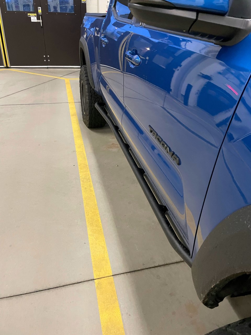

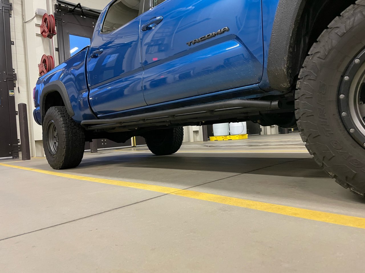

    I recently bought some rock sliders from Cali Raised LED. They’re the Trail Edition 25° w/ bump out. They're really low profile. I love the look :D
    As far as the product itself goes, it seems to be pretty high-quality. However, their resources for self installation are a bit underwhelming. They did post a video on YouTube walking through the install on a double cab short bed, but there are enough differences from the long bed that it’s a bit confusing if that’s what you have.
    The text based walk-through on their website is not great. I’ll leave it at that.
    On top of that, there was no parts list included in the packaging, so I had no idea if I had all the parts I was supposed to or not.
    All that being said, I finally got them installed. I didn’t record the process, but I did record a walk-through after the fact to illustrate some of the differences and show where the bolts go on the double cab long bed (this might vary slightly depending on your year of manufacture).
    I’m happy with the final product. But the install was a bit of a pain given the complete absence of quality DCLB install resources.
    Hopefully this is helpful for others with a DCLB.

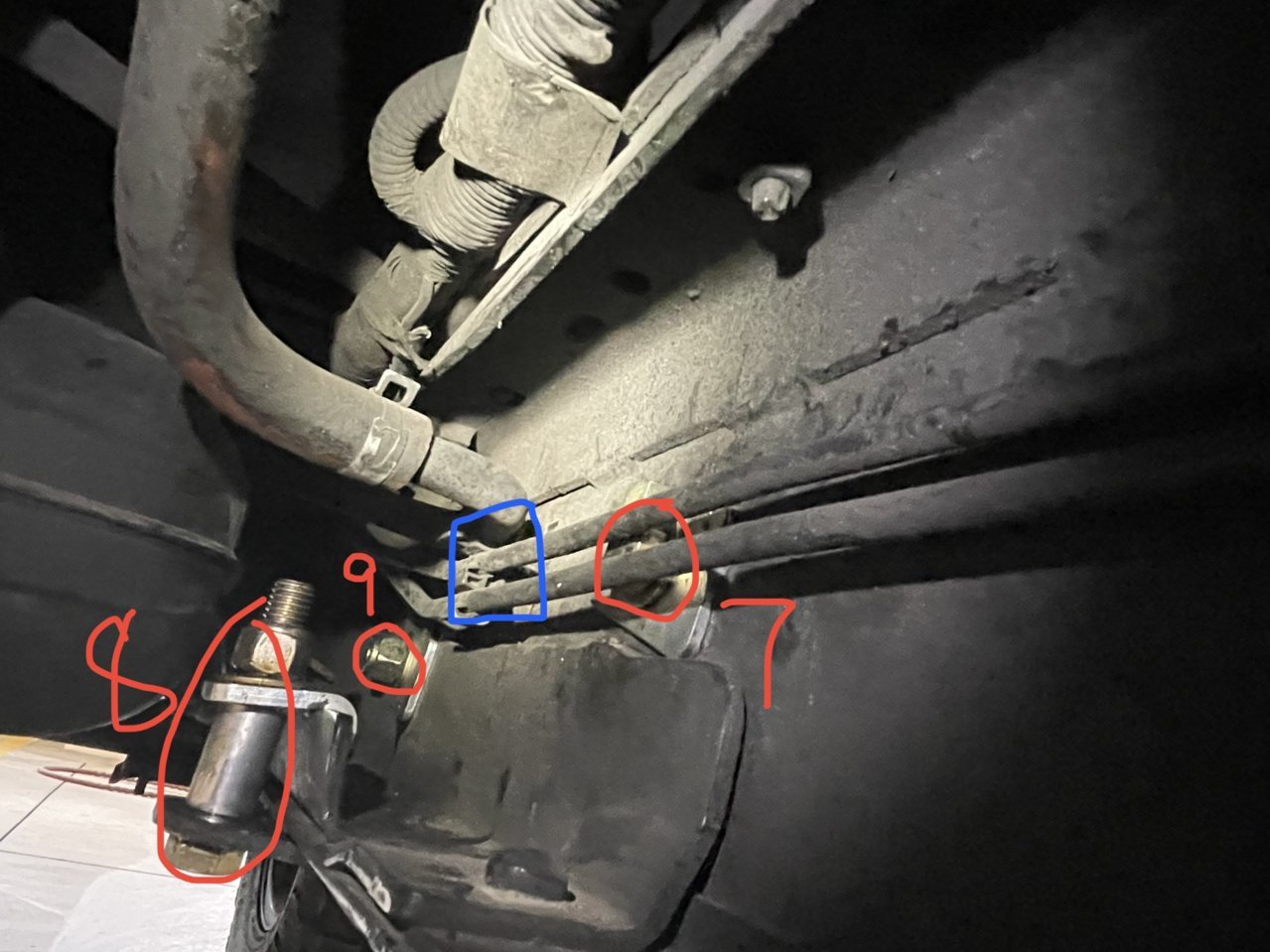

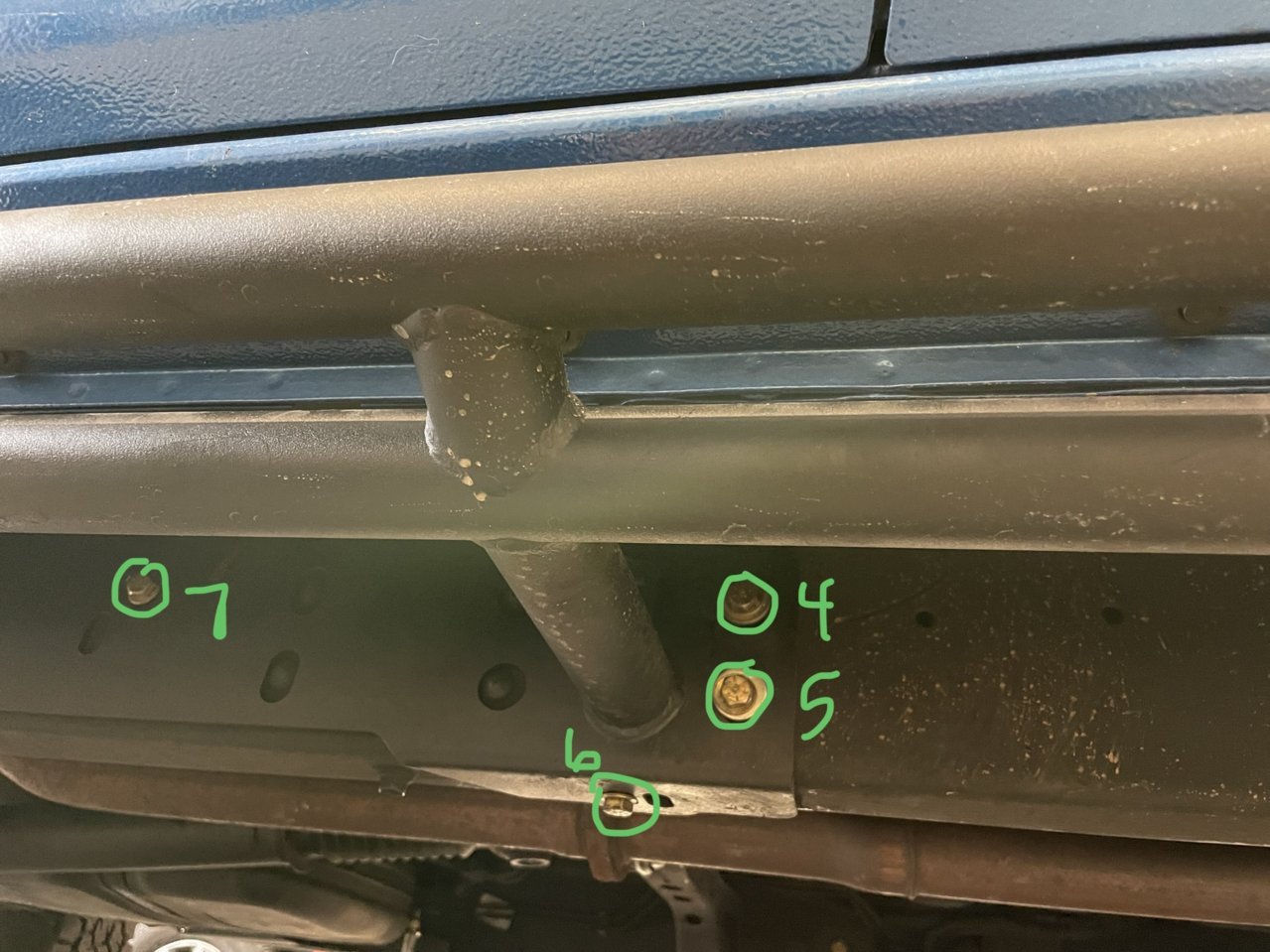

    ***EDIT to add photos***

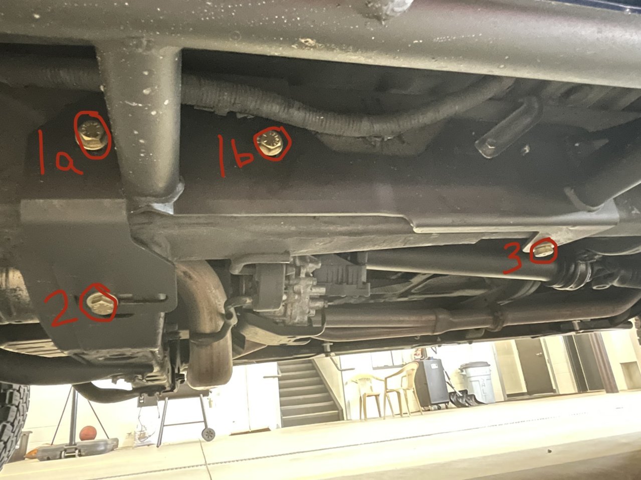

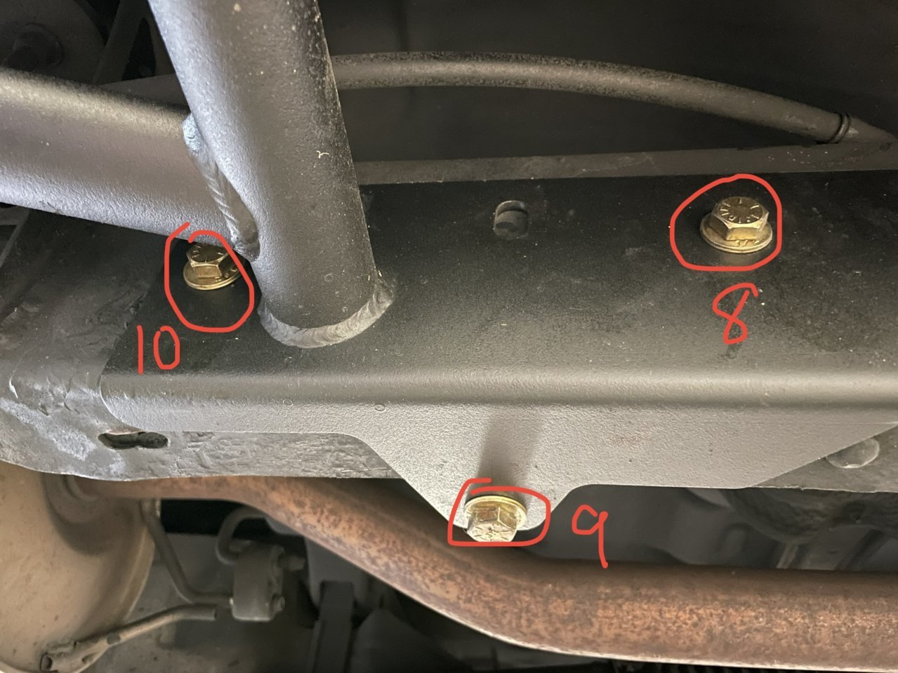

    Keep in mind, this is a 2016 DCLB. There may be some additional holes that line up on other model years, but these are all that lined up on mine.
    Driver's side, photos are in order from front to back.
    Bolts are NOT numbered in order of installation.
    Bolts 1a and 1b are the bolts that screw in to the "handle" backer plate inside the enclosed portion of the frame.
    Bolt 2 is the bolt that screws into the backer plate that you place inside the frame cross member.
    Bolt 3 is the shorter of the 2 "clamp" bolts that clamp to the lip of the frame.
    Bolts 4 and 5 are the smaller bolts and require both a small washer AND a large washer.
    Bolt 6 is a smaller bolt and the first one I installed.
    Bolt 7 is a large bolt with backer plate installed backwards to accommodate the brake lines along the inside of the frame (photo to follow).
    Bolt 8 is the larger of the 2 "clamp" bolts. Only 2 clamp bolts are needed per side for the DCLB vs the 3 mentioned in the Cali Raised video for the DCSB.
    Bolt 9 is another large bolt with backer plate.
    View from the inside of the frame for driver's side bolts 7, 8 and 9. The blue square is the mounting clip for the brake lines. You have to pop it off the frame to install bolt 7, and once bolt 7 is installed, there isn't enough clearance to replace the mounting clip. This is the one I mentioned padding with a rubber buffer of some kind.

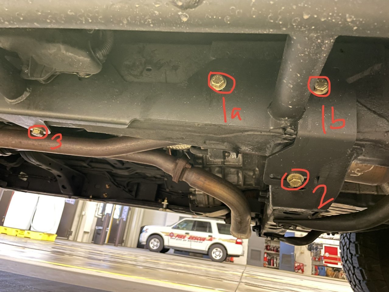

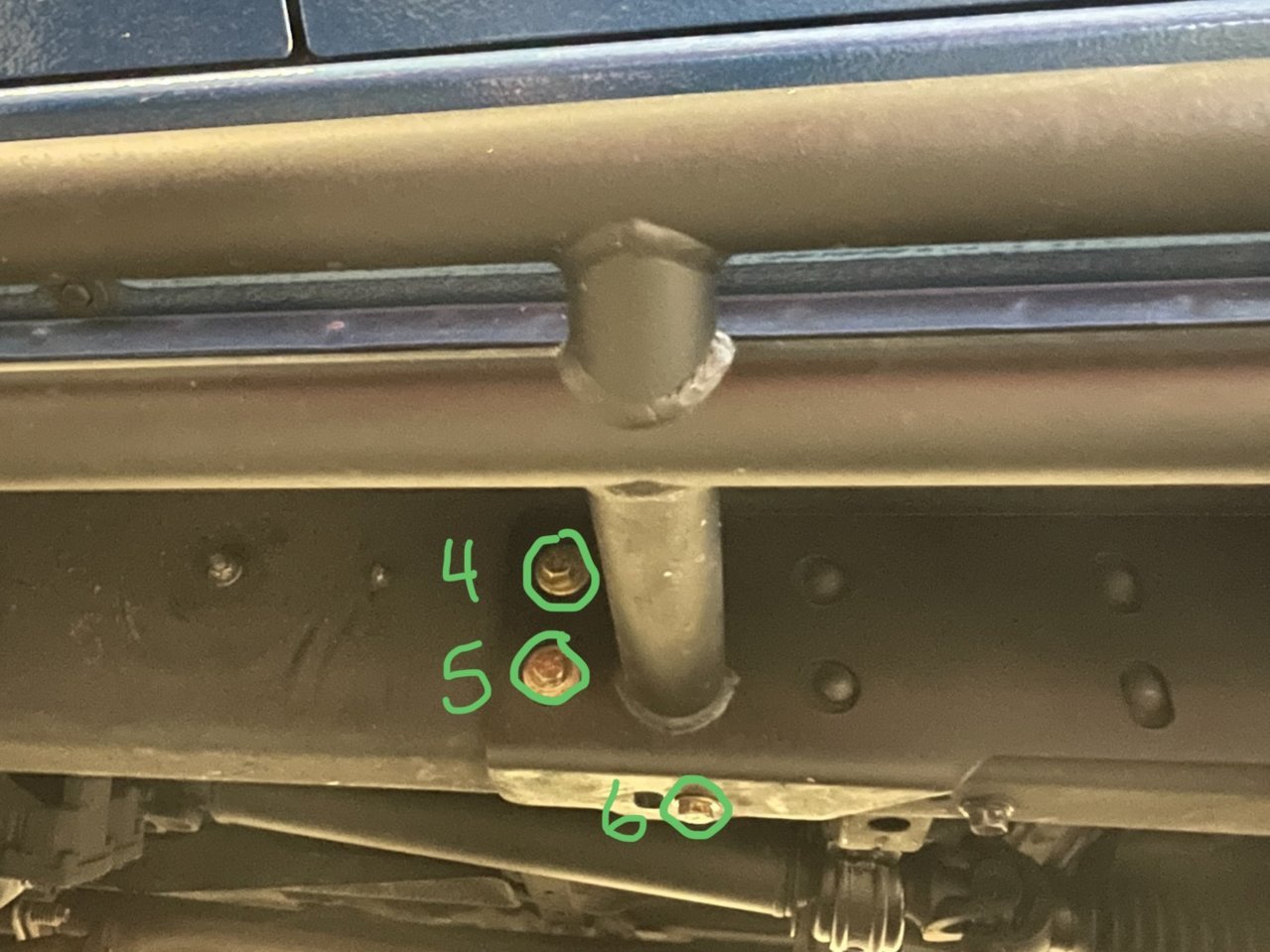

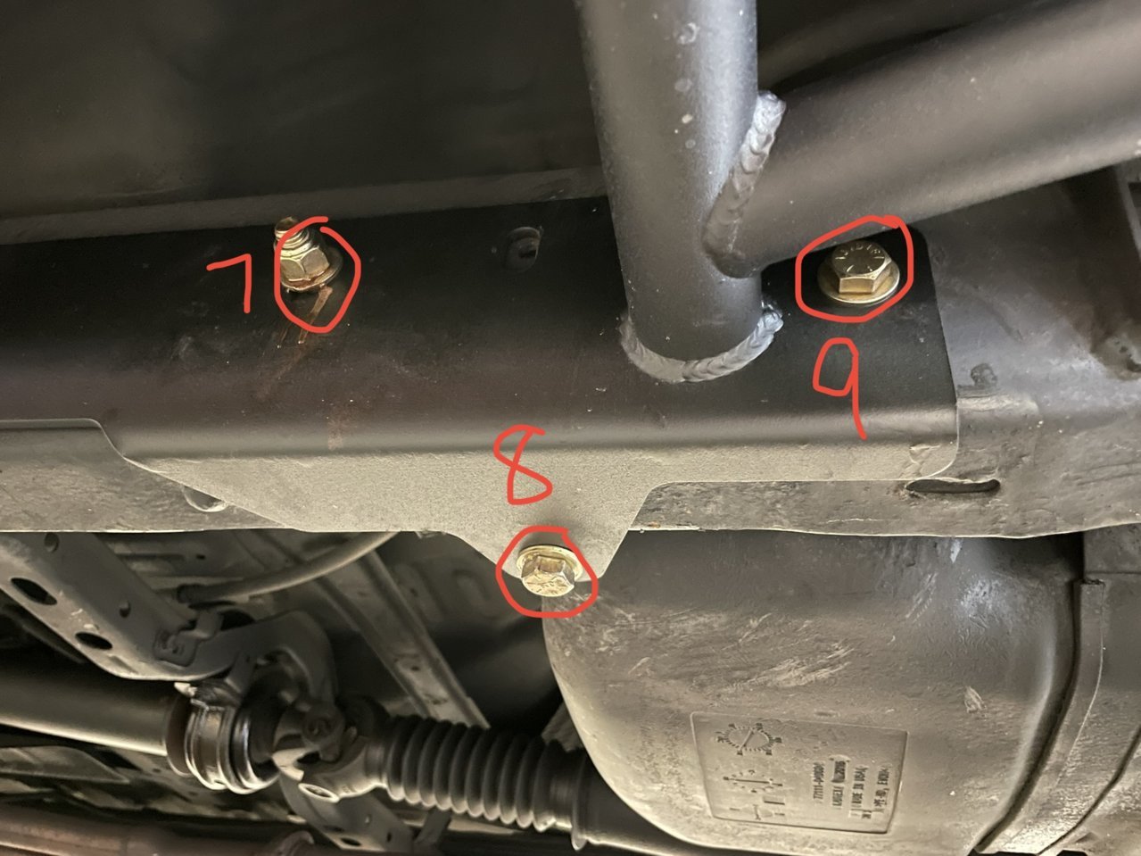

    Passenger's side, moving from front to back...
    Bolts 1a and 1b attach to the "handle" backer plate inside the frame.
    Bolt 2 attaches to the backer plate that was slid into the frame cross member.
    Bolt 3 is the smaller of the 2 "clamp" bolts.
    Bolts 4 and 5 are smaller bolts with both a small and large washer.
    Bolt 6 is a smaller bolt (the first I installed on this side).
    Bolt 7 is a smaller bolt.
    Bolts 8 and 10 are larger bolts with backer plates.
    Bolt 9 is the larger of the 2 clamp bolts.
