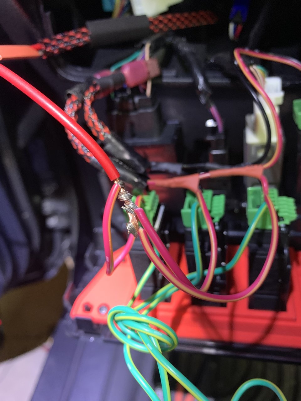

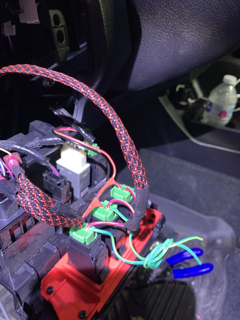

    What is that sorcery called?

    I know VLED's had some like it. Others on Amazon. Just gotta look. When I searched for T-Taps, it shows as T-Tap Electrical Connectors.

    They are awesome. I’ve been using these types of connectors for the past year. Super easy, effective, and cheap

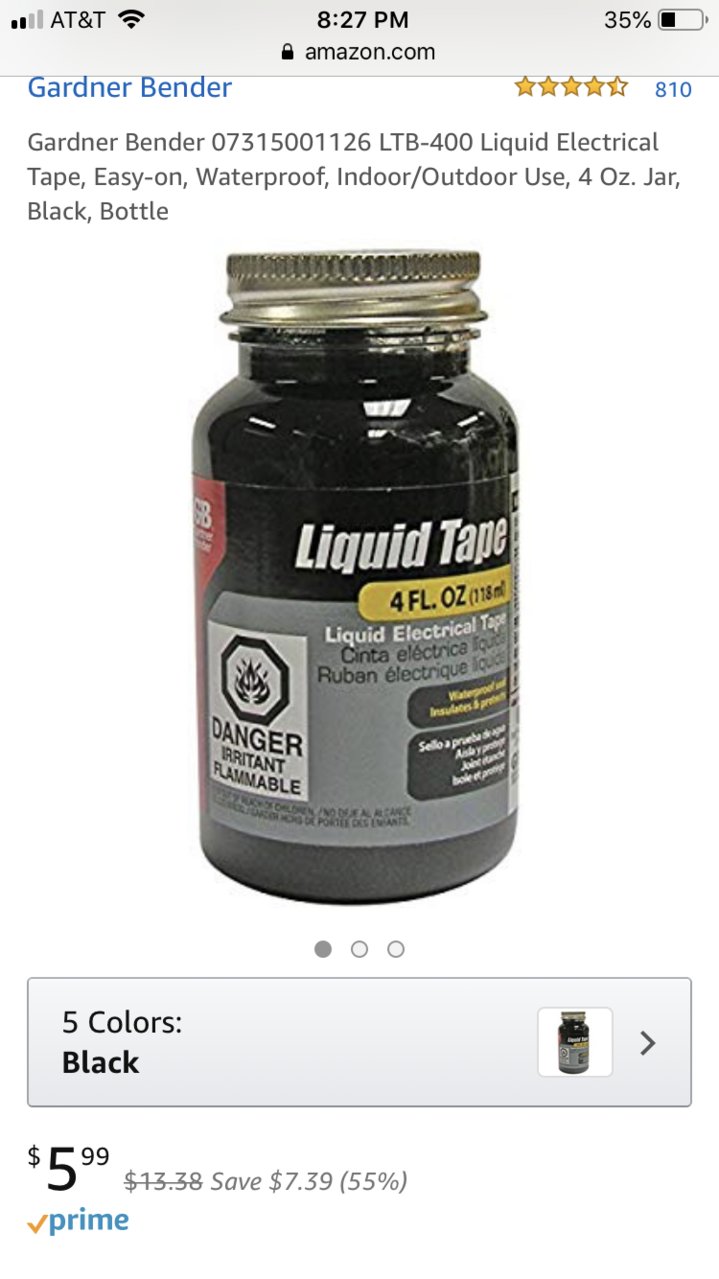

    You guys do what you want, but cutting insulation with scotch-locks is a bad idea. Wires should be properly soldered with electrical solder, then heat shrink with the glue inside. Or, especially for these small little guys you're dealing with, soldered and then coated with liquid tape, possibly even heat shrink over that. The heat shrink adds some rigidity to the connection to keep it from flexing too much. The liquid tape obviously keeps moisture and corrosion from taking over.
    I may be an over-do-er, but, I have never had a properly repaired connection bite me in the ass. I have seen a lot of crap repairs though.
    I also restore old Jaguars, so Lucas has taught me to be really picky.:annoyed:

    Would this stuff work?

    Exactly what you want^.

    BTW, IIRC, Lowes sells that GB liquid tape, as do most auto parts stores. The self sealing electrical tape is good too, but harder to find, and more expensive.

    I’m gonna try some. $6 for some piece of mind ain’t bad and I plan on doing a little more electrical down the road.
