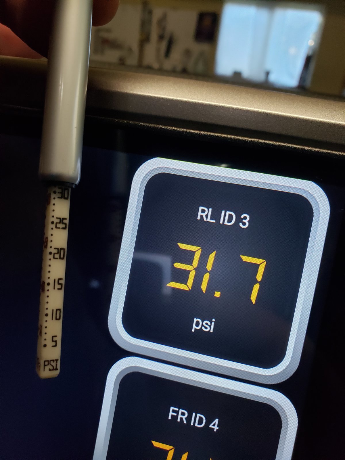

    I have 3 cars, total 12 sensors, same bike pump, same pressure stick, plus obd2 app to see tpms control unit (pressure, temp,etc).
    Good enough?
    I'm confident.
    P.S. here is for the science. 2 different sticks measured at LF tire (ID2)
