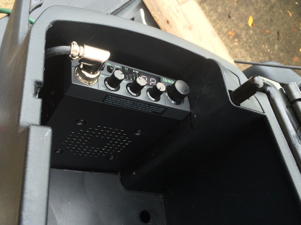

    Got most of the CB system set up this weekend. Still need to run the antenna cable and hook up ext speaker. I'm probably just going to place the speaker under the driver seat.

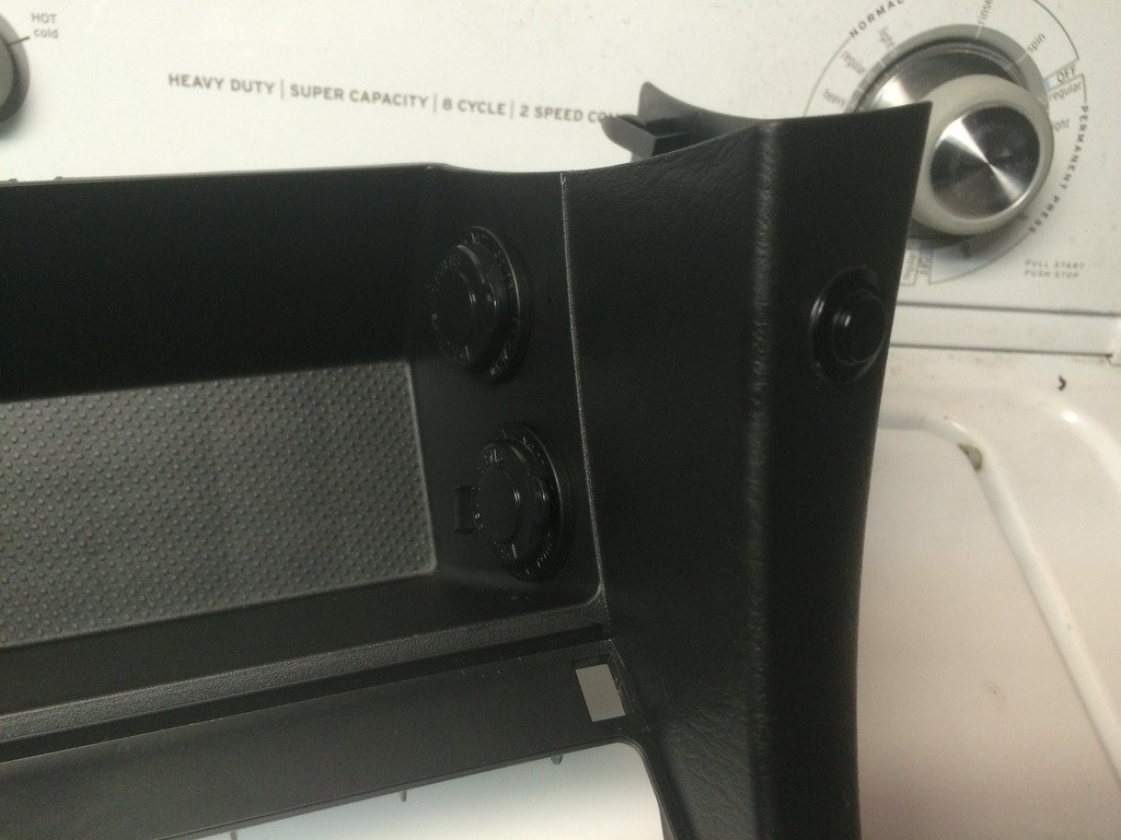

    Moved the 12v power to the little cubby. I left the covers on for now till I figure out what I'm putting there. Tomorrow I'll do the 12v constant hot mod and wire in the push switch to control the USB outlet to prevent parasitic drain. Removing the outlets to get to the plugs was a major pain in the ass.

    Well I fucked up. Don't place your outlets like this. Went to install today and there was "ZERO" room to fit. Not sure what the hell I was thinking I thought I checked for clearance but obviously not. The switch was fine with minor trimming. Lesson learned the combo of losing day light, tequila, and a nagging girl does not mix well when finishing up a project. :anonymous:

    That sucks, but the combo was pretty funny. Is there just no room to reinstall? Or the wiring? All of the above?

    The bottom outlet would work with minor trimming. The top one was totally flush with the support underneath. I still can't believe I did that! It was one of those moments I guess, you live and learn! Covered up the holes with black duck tape for now. I ended up just putting the outlets in the place of the original ones and had to drill them out an extra 1/8" to fit. This was my original plan just figured I could fill up the blank space with something like a battery monitor or something by moving the sockets.

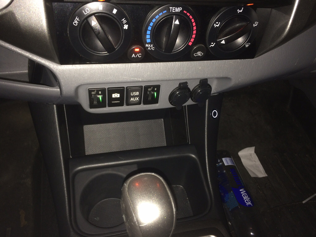

    Here's a pic of the after. Blue sea 12v socket and dual USB port. Have them wired so that the USB is controlled with a push switch. Hopefully tomorrow I'll mod the relay so it's constantly hot.

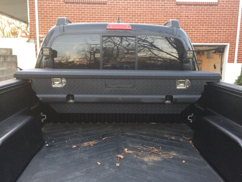

    Finnaly installed the Dee Zee tool box bumper.

    Looking good! Compressor is super clean.

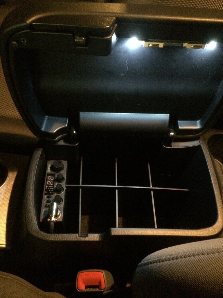

    Finally finished the CB install. Got the SWR to right below 2. Maybe 1.8 is this ok? Or do I potentially have a grounding issue?

    I would try to get it lower or under 1.5, ideally around 1, I would think. Probably getting some resistance at the mounting location. Throw a multimeter on it and check it out.
