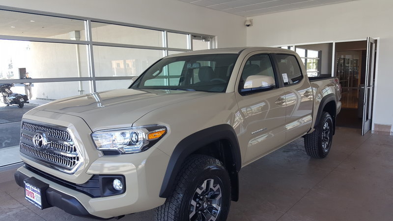

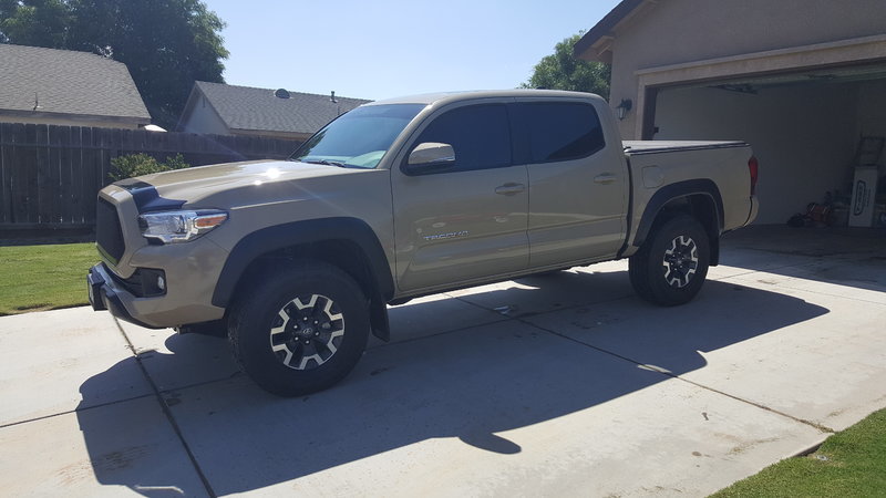

    This is my truck the day I picked her up.

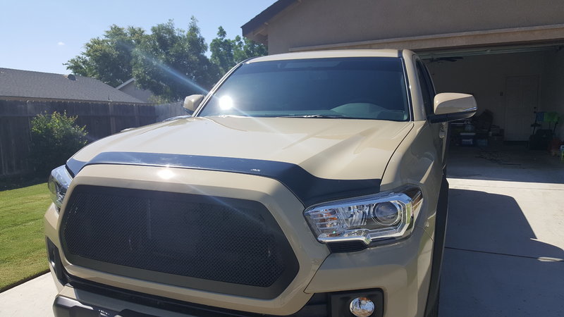

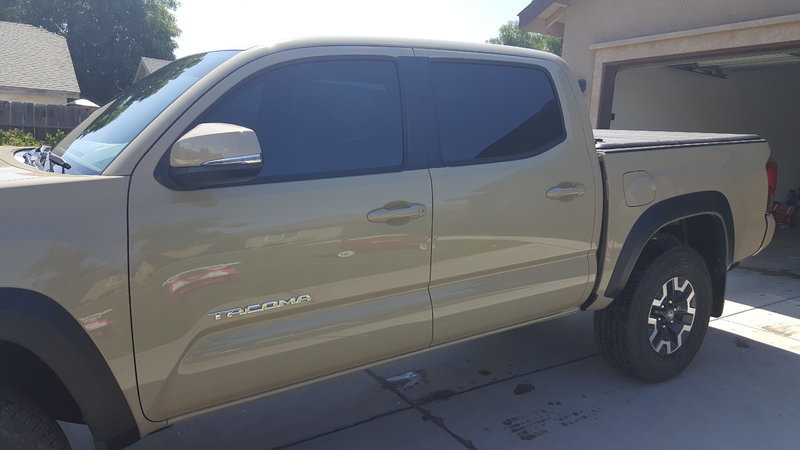

    This is after id done a couple of things to it. Im not a big plasti dip fan so i swotched out the grill with a T-Rex upper class grill. The reasoning for this was to rid myself of the ugly chrome monstrosity toyota felt the need to place on the front of this truck. I also have plans on fitting a light bar behind it at aome point with the fine mesh patteren of the grill the light should have no problem lighting the road. As you can also see i have a bug guard on the front. This was more of a superficial mod because although i love the color of this truck the black helps break it up a little. I also have 20% Ceramic tint all the way around as well as 5 inch strip across the front window.

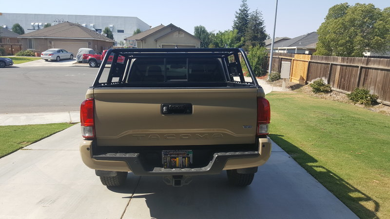

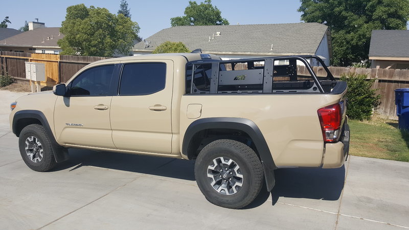

    This would be my CBI overland bed rack. I ditched my Extang bed cover for this because the bed rack will suit my needs better. The rack provides me with more storage options as well as a place for my roof rop tent I will be getting in the future.

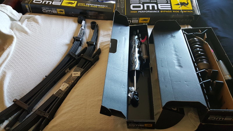

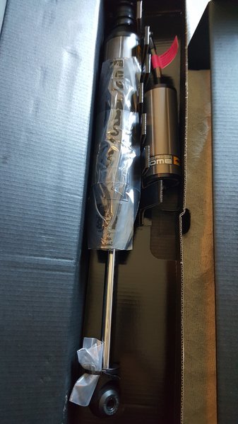

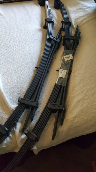

    20160621_114627.jpg 20160621_114650.jpg 20160621_114653.jpg 20160621_114659.jpg

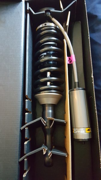

    OME BP-51s these bad boys were put on my truck yesterday, i will post pictures after a put a few miles on them so i can also put up a min review.

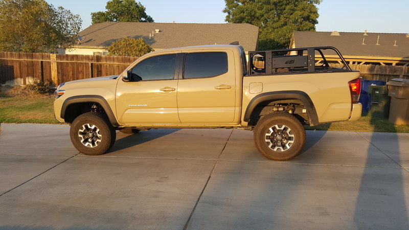

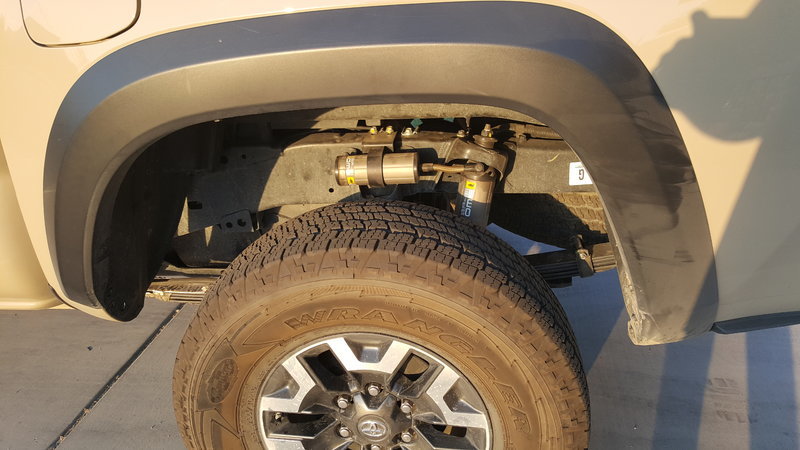

    The OME BP 51s have been installed and have about 200 miles on them, they really smooth the ride out. The lifthe is around 2 and a half inches...I kept them at factory settings
    This is a shot of the rear set up.
    And here are the front coil overs also had specialty products UCAS installed today.

    did you measure truck before lift, i talked to Arb, because i was concerned with some other measurements on TW, people were getting 3" or more. The tech from ARB said the kits ship adjusted for heavy load (ex front bumper and winch) and per the manual, they should be adjusted to get the 2.5 inch, which beside giving more droop, will also ride better according to him. Also the 3rd leaf would have to be removed from Dakar pack.
