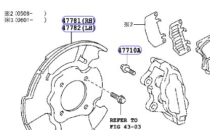

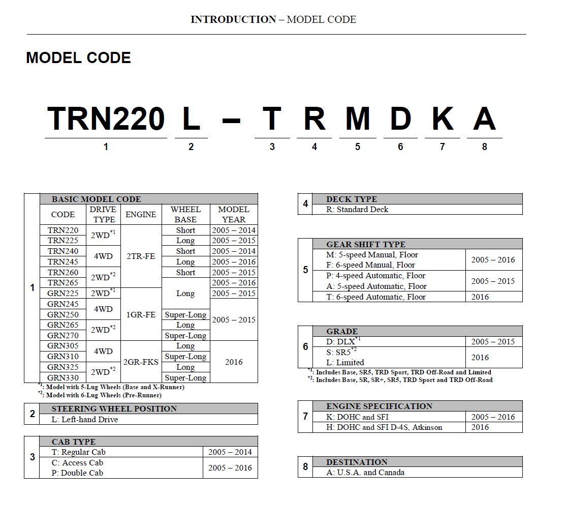

    I may have found you a part number, I just need to know your model code.

    Should be GRN-245 - 4WD Access Cab. I believe all 4WD models should use the same caliper/spindle.

    It’s listed on the VIN sticker on the drivers door jamb.

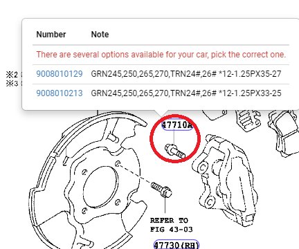

    It shows two part numbers. I'd say call the dealer with your VIN and see which one is correct.
