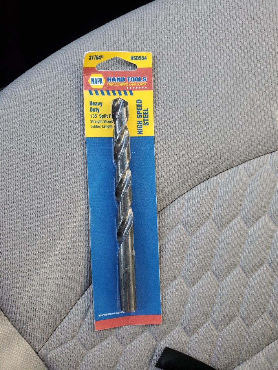

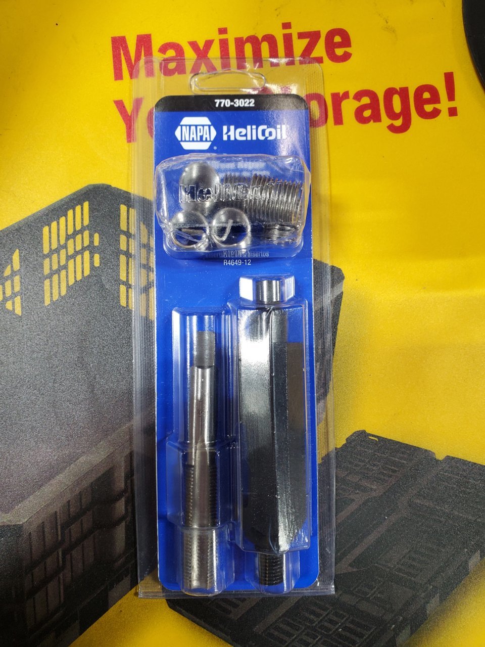

    I just had the same problem on the top bolt for the drivers side caliper on the steering knuckle. I picked these up at NAPA. Going to try and do the repair on Wednesday. Anyone ever attempt a Heli-coil?

    I've used helicoils many times with 100% success- although not on this application. Make sure to use the proper drill size for the helicoil tap.
    If I have the space I prefer the solid style thread inserts (not a "spring" like a helicoil) but they're not available in all metric sizes, and not easy to find locally. I get them from McMaster

    Thanks for the info. Another forum said 31/64 inch drill bit for this application. I've got a buddy who has done a lot of helicoils for aircraft maintenance who is going to help me out with this.

    That's good, because this is not a location where a 1st time helicoil installer is likely to have sucess. Drilling with that big of a bit and getting it absolutely perfectly straight is going to be tricky. If it ends up even very slightly crooked, the knuckle is junk.

    The package, or the tap, or both, will list the bit size. It will be difficult to get the hole straight if you don't do it in a drill press as said above. You may want to consider starting smaller and working your way up to the specified bit size as this will help with alignment. Helicoils are extremely common in aerospace because aluminum is so common.

    Appreciate the tips. Was going to attempt to drill while installed, but am going to pull it off and drop it in the drill press. The old bolt is about 7/16" - I am drilling to 31/64" - I think it should be alright, only going up 3/64" in size. Heading over at noon. Will let you guys know how it turns out.
