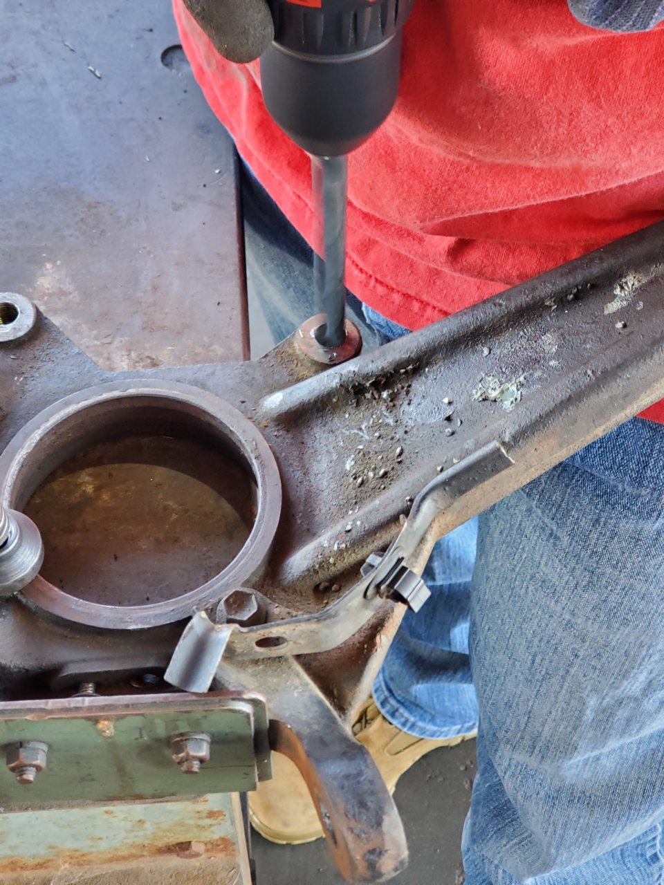

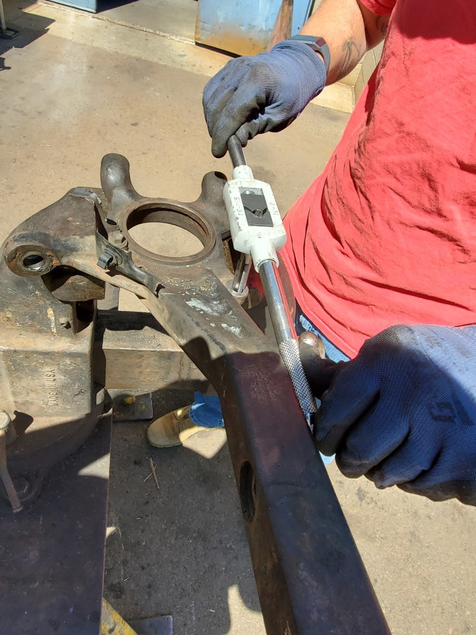

    If I were doing it, I would remove the hub & bearing, remove the knuckle, anchor the knuckle to the drill press table with bolts in the T slots, align the hole with a pointed center, drill it out, put the pointed center back in the chuck, start the tap in the hole with the pointed center in the end of the tap, and turn the tap with a wrench. Of coarse, if you have access to a milling machine, that would be even better.

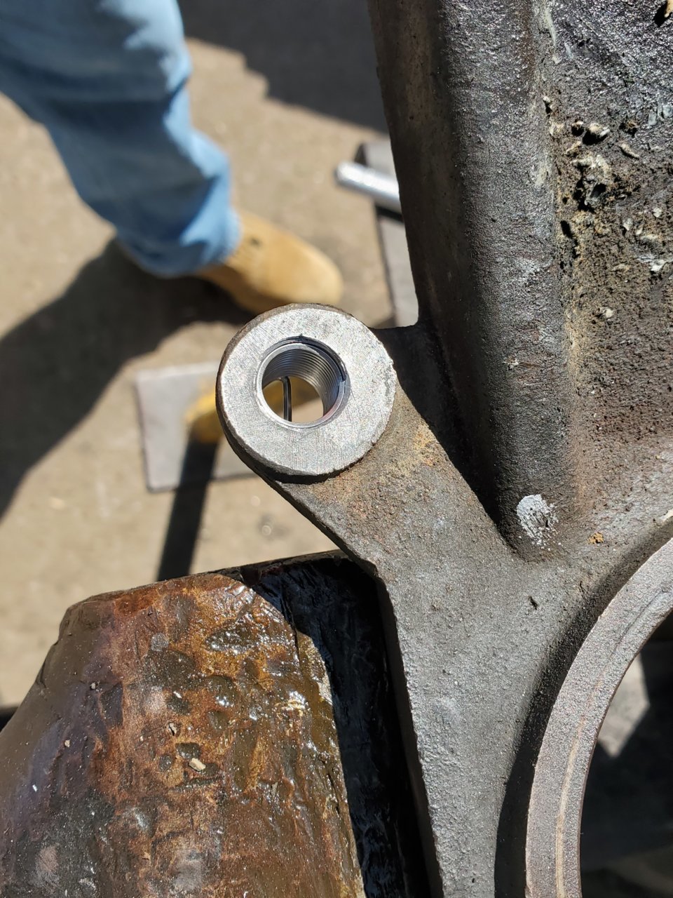

    No drill press available. Made due with a C Clamp and the 31/64 drill bit. Was patient working the tap into the ear on the steering knuckle. Ended up going in straight. Everything bolted in as expected.
    $80 for the helicoil kit
    $15 for the 31/64 drill bit
    Tuition paid regarding the judicious use of air tools.

    It looks like you did a great job with the heli-coil. [​IMG]
