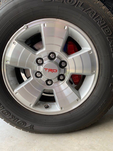

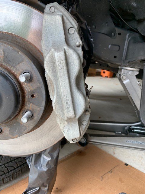

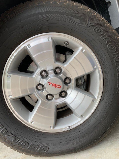

    Painted calipers using G2 paint kit. Before and after pics below. +5HP =;-)

    Is this spray or brush on?

    It is brush on. It went very smoothly. I bought some other better quality brushes. 2 coats of paint. 1st was very light.

    Will this work on rusted brake calipers?

    Wire brush then apply.

    Brake cleaner, wire brush, brake cleaner, wire brush, repeat.
