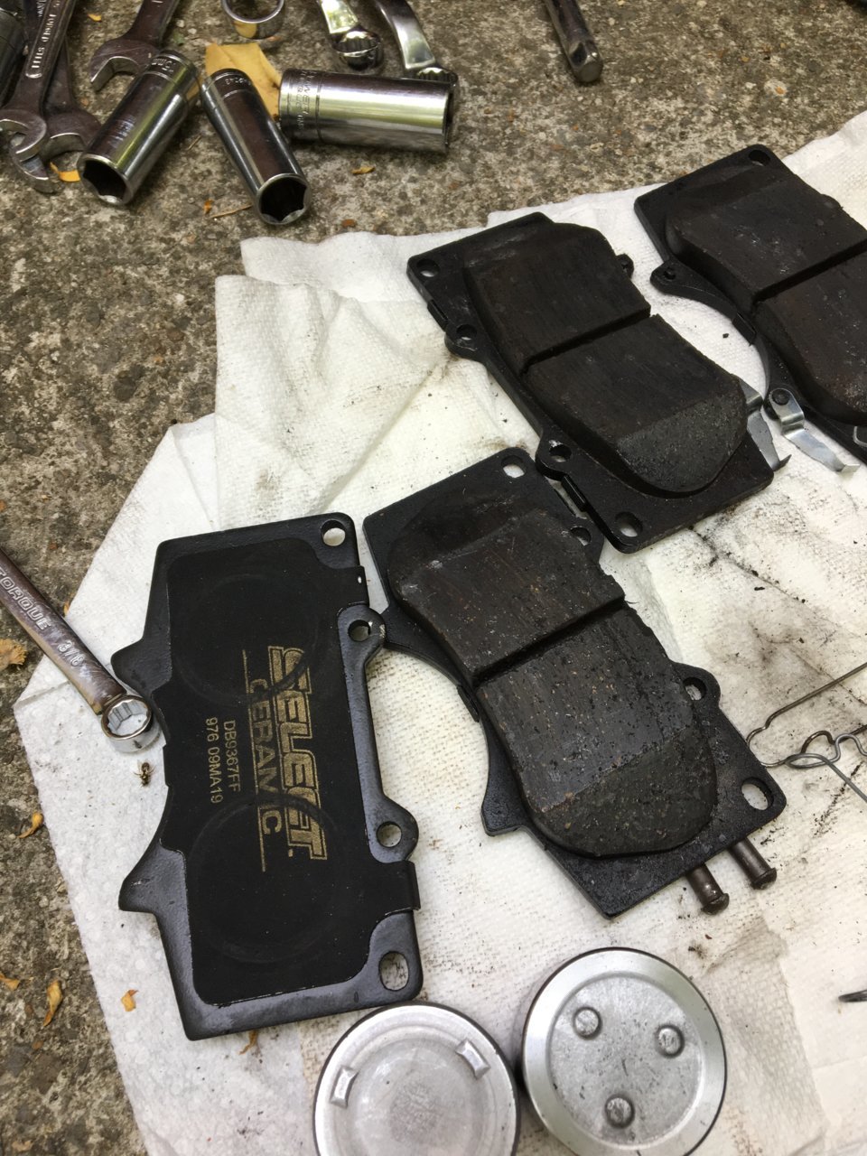

    Installed new ceramic pads on front . Truck will go a mile or two with perfect brakes then all a sudden the pistons won’t release(both sides) tried everything that I could think of, installing new brake hoses right now but not really thinking that’s the issue. Took calipers apart, no scoring or bad spots , just a little dirty but cleaned them up and still same issue. Anyone had this problem? They’ve been bled correctly but still sticking. This last go-round it was the inner Pistons on both sides that were sticking. It’s just weird to me that both calipers are doing the exact same thing, could it be the pads?

    Pads. Also why do the Pistons have different machine marks on the bottom of them?

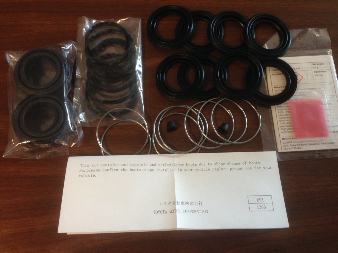

    Multi piston calipers are high maintenance - time to get a Toyota re-seal kit, clean out the insides and rebuild them. The outer-caliper fluid cavity collects grit and dirt, and none of it flushes out even when doing a brake flush (I supposed you could put a vacuum directly on the individual caliper though) - the grit eventually gets under the seal/caliper surface and causes the seal to clamp around the piston(s) more than intended, causing uneven pad wear.

    Caliper kits from the dealer are only $20 for everything to do both sides. Make sure you take your VIN number in with you as there was a change in midyear 2006.
