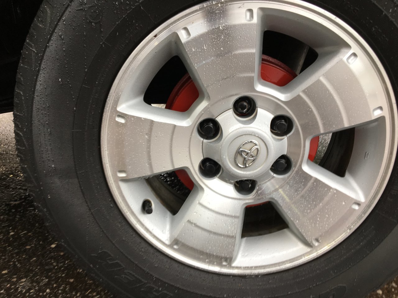

    Did a little drum and lug nut Painting while I was at it but I’m not sure how I feel about the red ceramic paint. I may switch over to dark gray to match my decals
