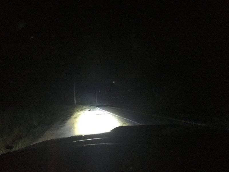

    Just the 4D bar on.

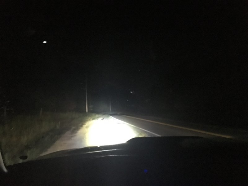

    Lights + Fogs

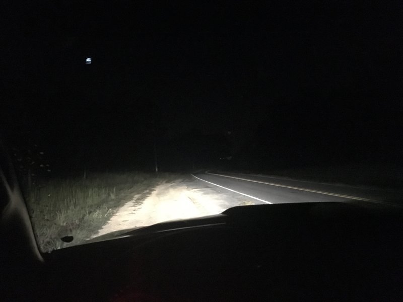

    Brights + bar
    I'm hoping to aim the light a little better. It seems that it doesn't really shoot out very far like I expected. I guess that is also part of the spot bar instead of spot and flood.

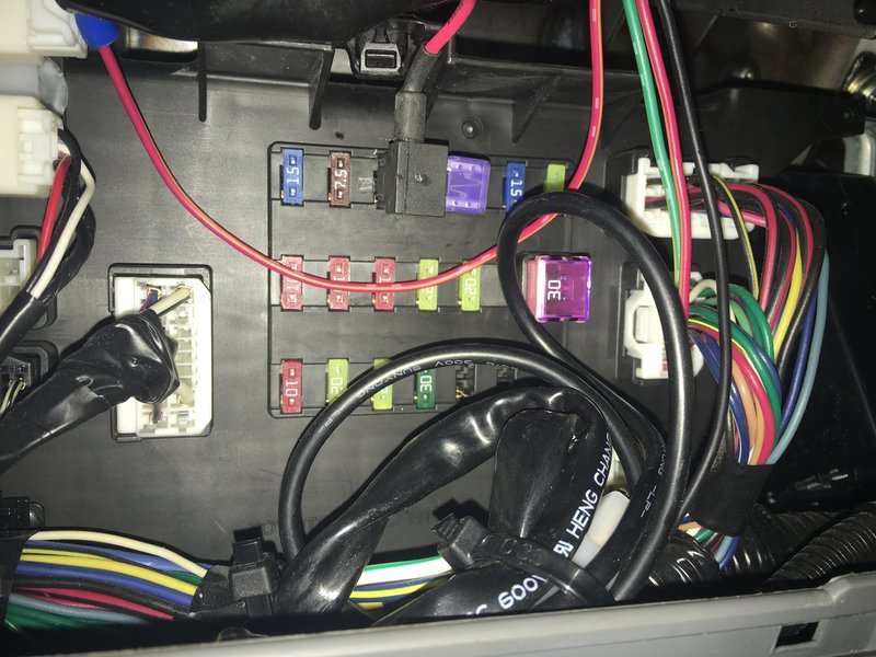

    This was honestly very easy to install. If you buy a mictuning switch, I found it to be the easiest to get a "Add-a-circuit" fuse so that your "LED LIGHT BAR" text will illuminate when the headlights are on.
    Top row, 3rd fuse over

    Thanks for sharing the pics! The 4D is the spot only so it's a reach out and touch something LED. You aren't going to see a lot of light around the outside of your truck. It looks like it's aimed a little low, are you trying to use it for flood lighting?
    Also, to get a better idea of how good the LED works, find a spot where you can see a lot of things. I have a road near my house that has buildings down the entire road and I know approx how far away each of them is. Having them as a reference I can see just how far these LEDs will reach out and touch. When its a field or flat space it's hard to get the effect.
    It takes me about 3 or 4 times out before I am happy aiming my LEDs as you have to do some offroad night driving and then adjust, repeat, repeat, repeat in order to get them in the perfect spot.

    I wasn't trying to use it as flood lights but i realize now that it is aimed a little low. I was waiting till dark to see if I could get it in a better position.
