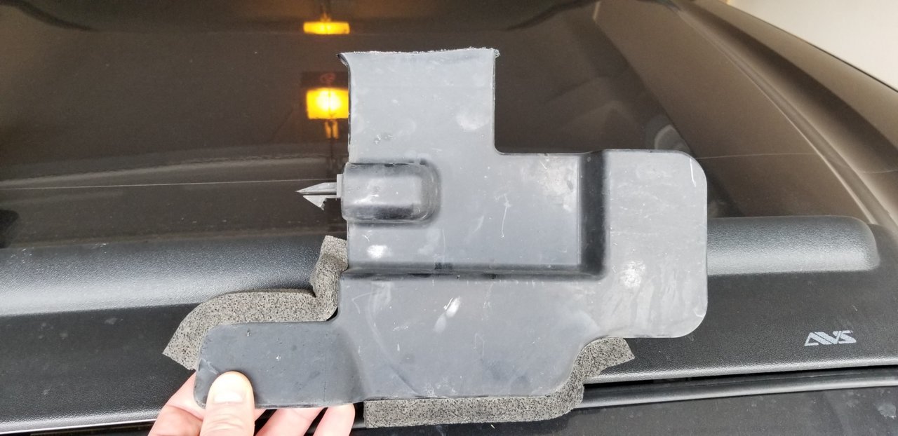

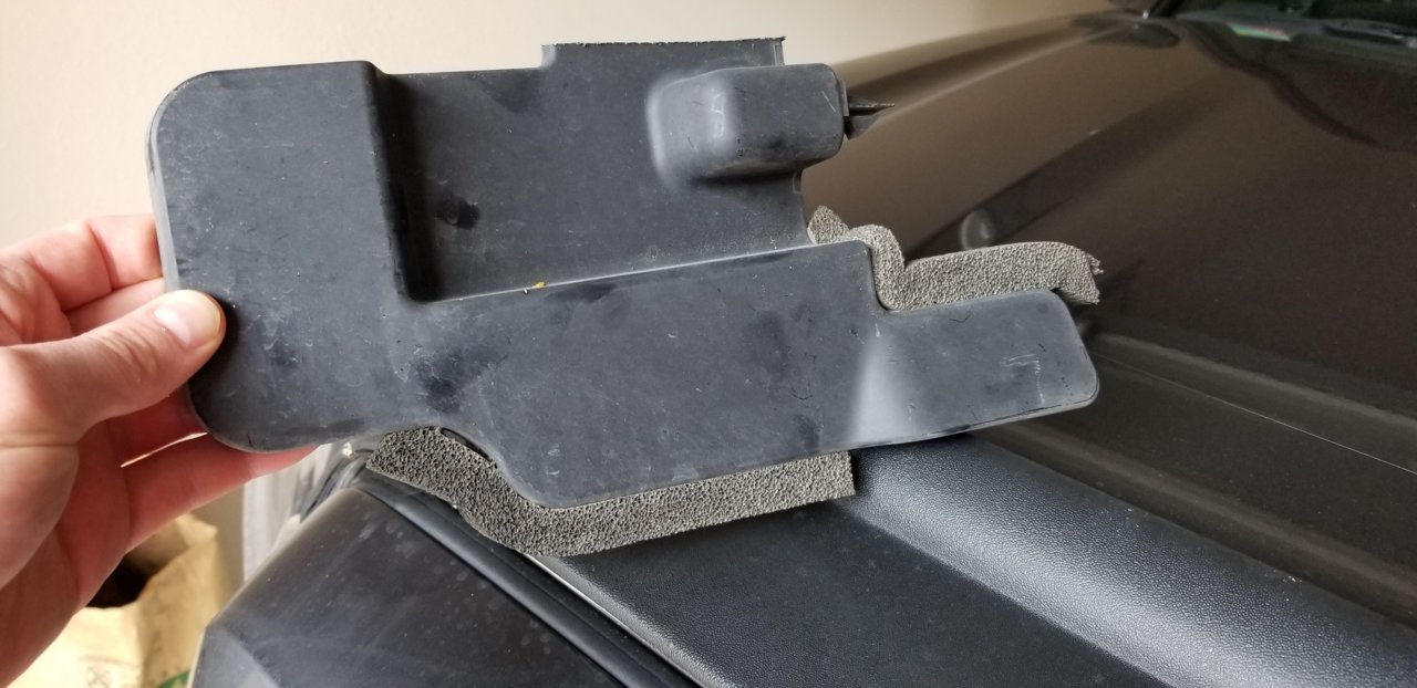

    I'll get some today showing where on the plastic pieces I trimmed to clear the brackets. Gotta find a dremel / angle grinder to work on clearance-ing the hood latch support bar behind the light bar. Hope there aren't any welds I have to grind through that I would then need to have re-tacked...

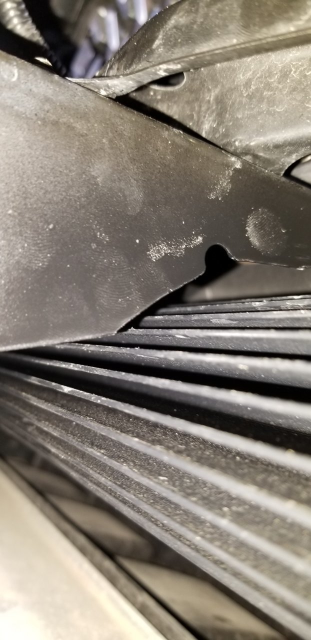

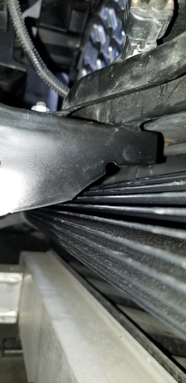

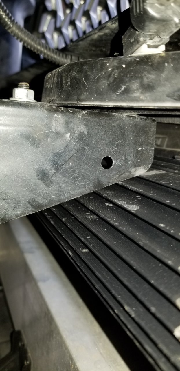

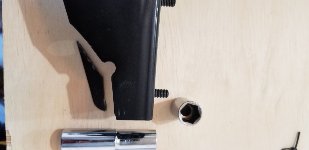

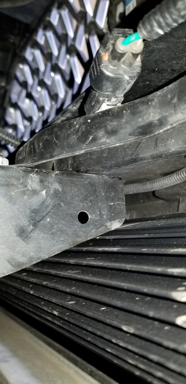

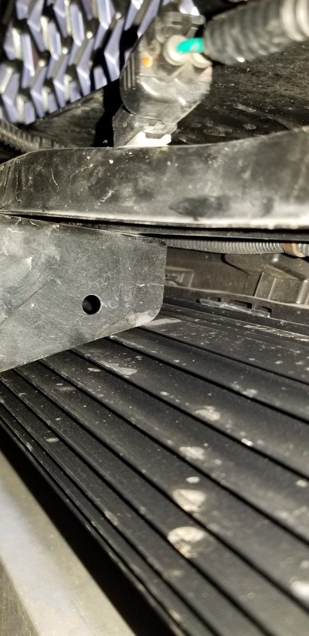

    Here are the pics trimmed off pieces, the others bolted in place, and the lower hood strut bar contacting the light bar 20191017_155351.jpg20191017_155359.jpg20191017_155452.jpg20191017_155440.jpg20191017_155629.jpg20191017_155604.jpg 20191017_155600.jpg 20191013_173755.jpg

    The reason why the contact with the hood latch bar is important, is the light is currently aimed too high, and I cannot adjust it any farther without notching that bar for clearance.

    Here is how much I trimmed up the lower support bar for clearance. Hit it with some black rattlecan afterwards for oxidation protection...

    Is this a common occurrence for the light bar installation? This is the first I have seen or read about trimming the support bar.

    i did not have to trim the support bar on my 19 TRDOFFROAD. I did however take the plastic parts out.

    Depends how high up you want the light bar to sit in the OEM opening. For mine to sit square and flush, I had to remove that material.

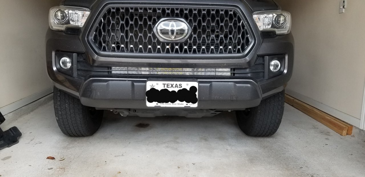

    Installed my light bar on New Years Day. Hardest part of the install was tightening the light bar bolts. I ended up removing the fog lights to properly tighten them. Hard wired the lights to my high beams utilizing and add-a-circuit to the left high beam fuse. Using the provided wiring harness: Black to ground, blue to the add-a-circuit, and white taped off. I have the combo beam and the light spread and brightness are great. Highly recommend.
