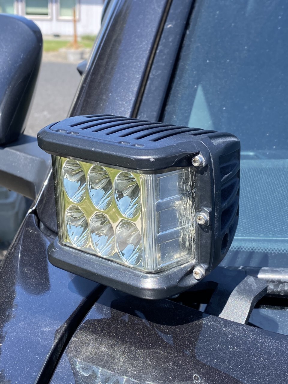

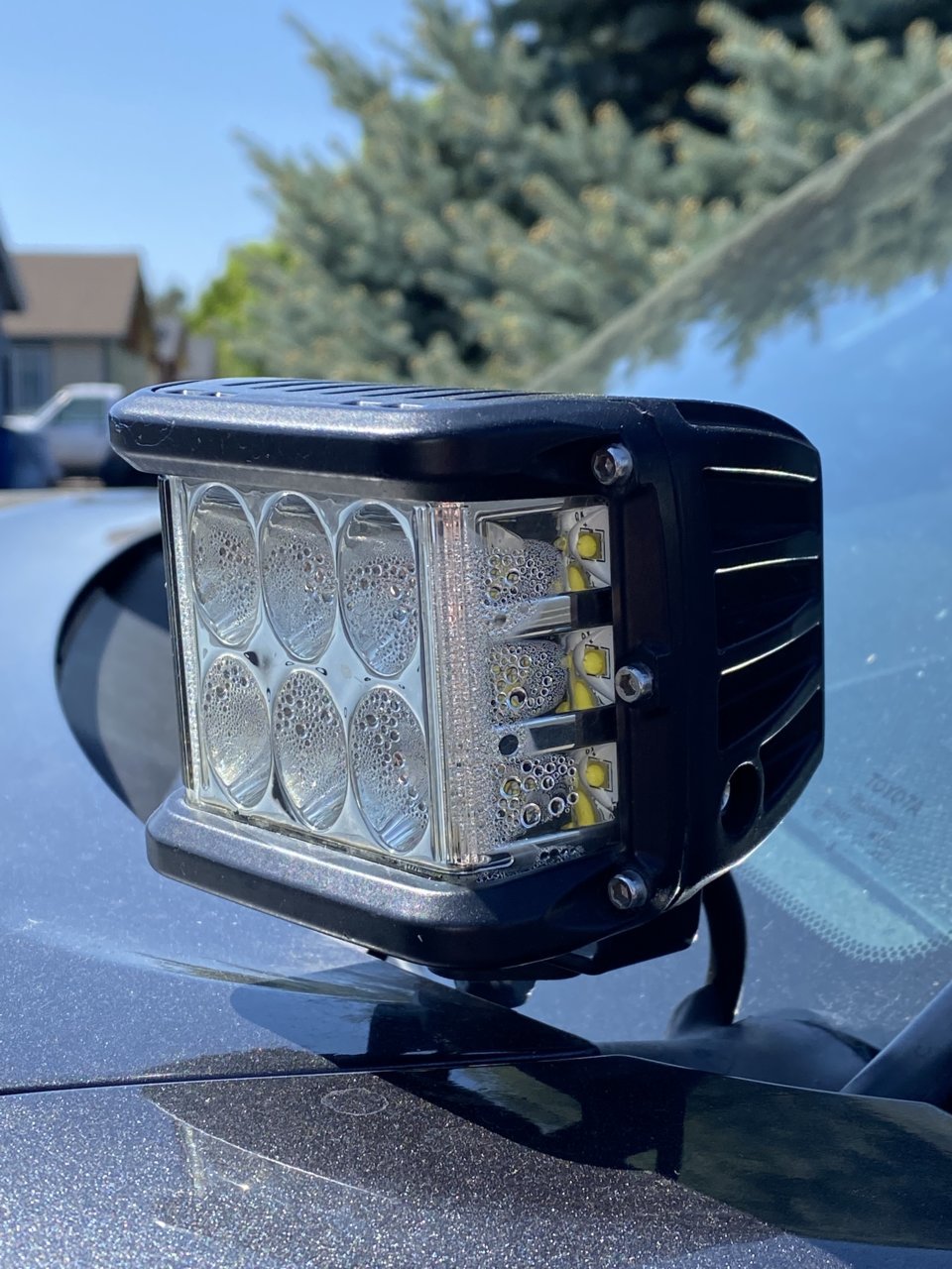

    I recently had one of my CR ditch lights take on water after about a year on the truck. I also noticed the other side beginning to crack aggressively. CaliRaised was very quick and easy in assisting me with their warranty process and within a week sent me replacements.
    While I appreciate their efforts, I see why it's worth it to wait and spring on more reputable brands. I don't want to have to replace these once a year after use.
