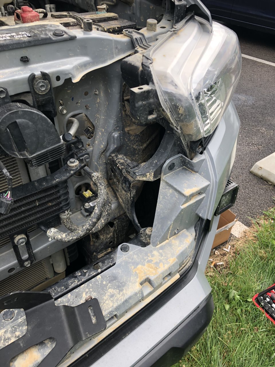

    Having trouble installing these brackets for my 32in light bar in the grill. Its the brackets for the grill (not the lower bumper), and I cant seem to find any install vids or descriptions, and no instructions came with it. Does anyone know?

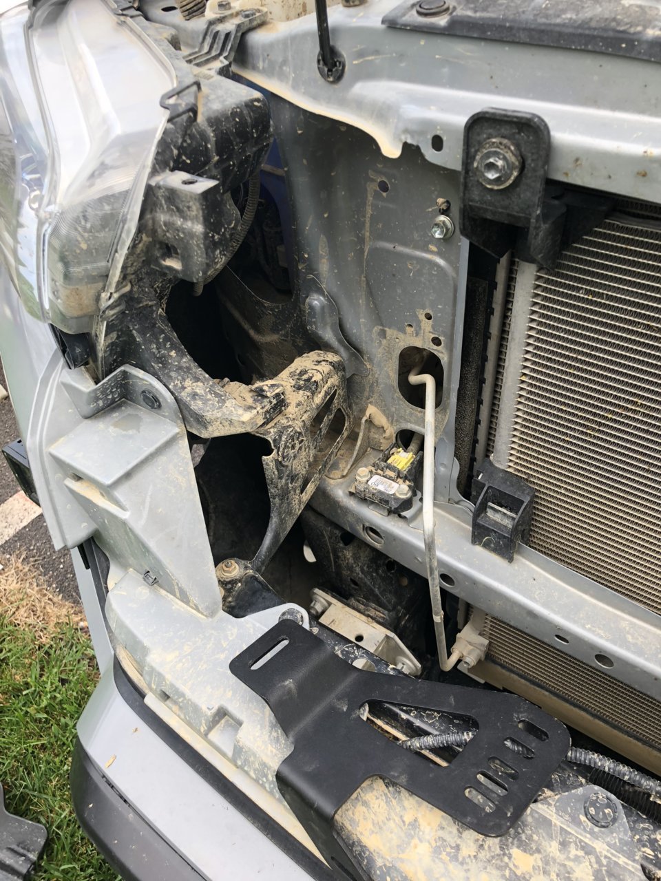

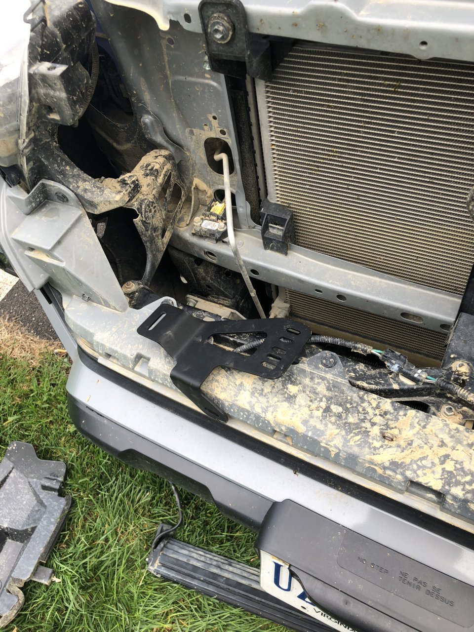

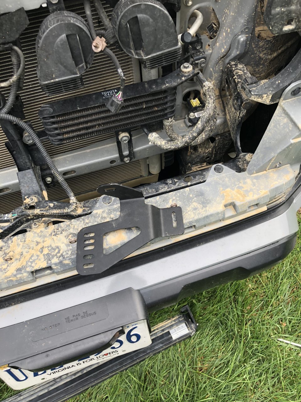

    We are currently scheduled to shoot the install video for this product next week. Here is an install guide for you in the mean time.
    I have circled the two holes on your picture where the mount goes so please use that as a reference.
    1. On the bottom mounting hole take the factory plastic clip out.
    2. Set the mount into position.
    3. The smaller 1/4" hardware and spacer are for the top mount. The larger 5/16" hardware is for the bottom mount.
    4. For all the hardware, install lose, do not torque right away.
    5. Starting on the bottom it goes as follows Bolt -> Washer -> LED Mount -> Plastic Bumper -> Metal Cross Bar -> Washer - Lock Nut
    6. On the top mount it goes as follows Bolt -> Washer -> LED Mount -> Aluminum Spacer (if you don't have our lower bumper kit) -> Metal Core Support Bracket -> Washer -> Lock Nut
    7. Once those are in place, you can now put the LED up. There are various holes for different grills. I noticed in your profile pic you have a 2018 grill so you can use just about any hole you want to get the desired height. We will put the LED on then set the grill in place to see where the height is and if we like the placement.
    8. New LED hardware is included and goes as follows Bolt -> Lock Washer -> Large Washer -> LED Mount -> LED
    9. Now that the LED is where you want it, tighten the bolts on the LED.
    10. Tighten the bottom and top bolts
    11. Wire it up
    12. Re-Install the grill
    If you have any questions please let us know. Sorry for the missing video. We have a plan next week to do a whole bunch of video and we are also going to start including paper instructions with our mounts soon as well.
