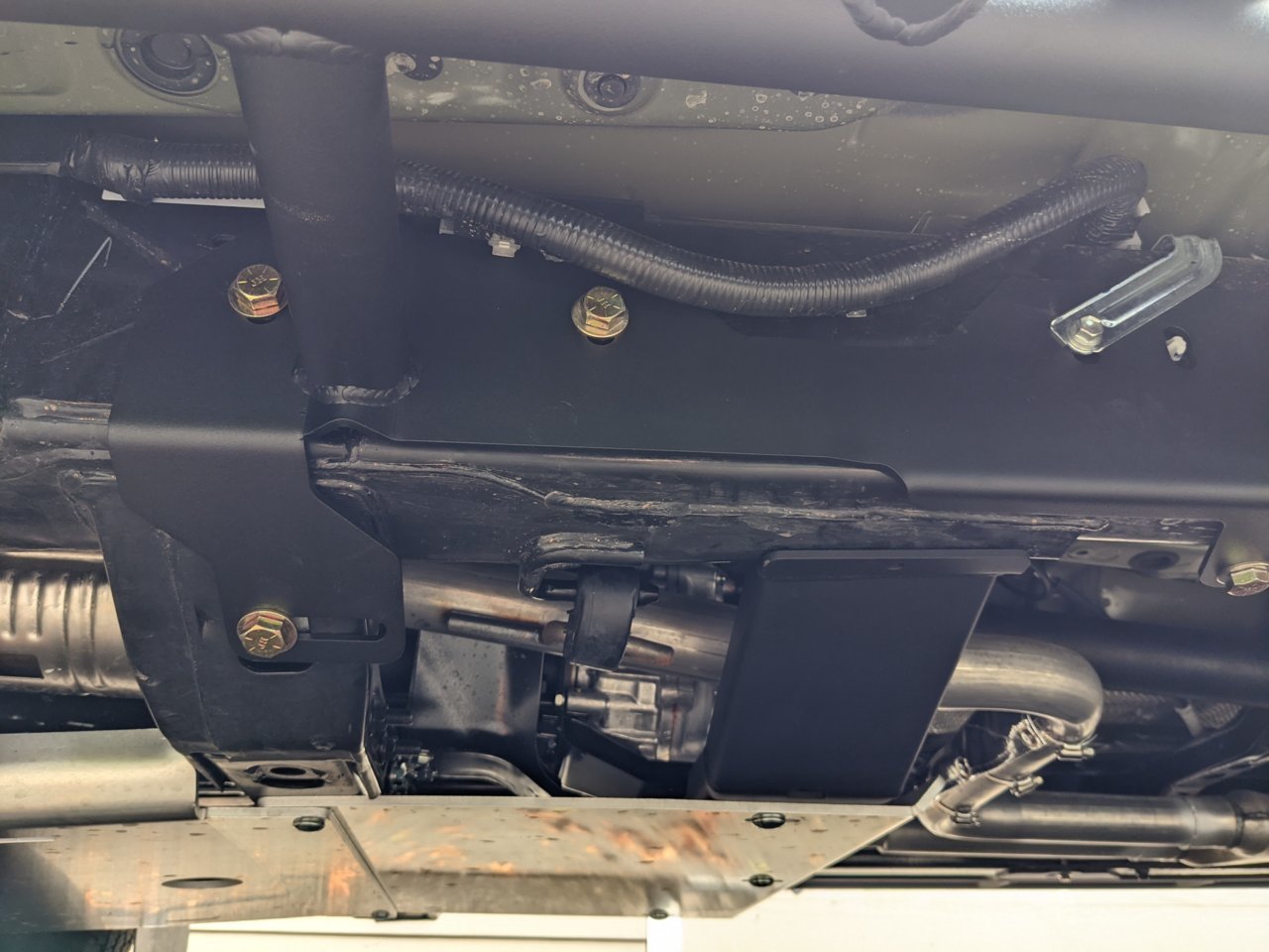

    Hey everyone,
    I tried to search for this but found nothing or missed it.
    I'm planning to get Caliraised 100% bolt-on Zero Deg rock sliders with Kick-outs and Full front, mid, rear and gas tank skids plates (don't know which brand yet).
    My concern is, will the mid or rear skids interfere with the how the sliders are installed on the frame?
    Does anyone have the same setup I'm trying to get? If so, which skid plates did you get?
    TIA

    Update: Ordered the CaliRaised Sliders
    Anyone knows if the RCI Full Skid plates will interfere with the Sliders, specially the rear (Transfer Case)? Thx

    Did you ever figure this out? Running into the same question now.

    In case anyone comes looking for the same answer, they fit together fine on 3rd Gen DCLB.

    I have this exact setup plus fuel tank skids and everything fits together just fine.

    Do you have photos you can share?
