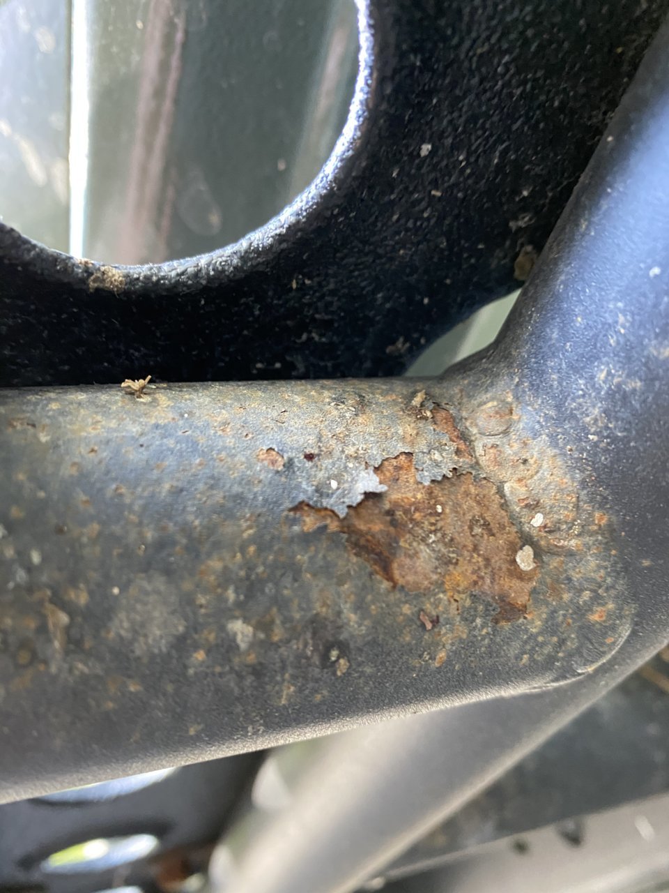

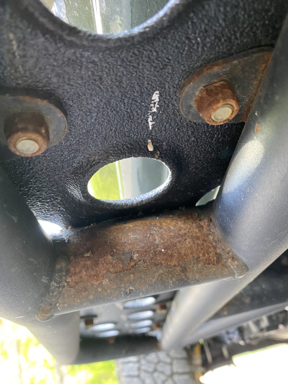

    Mine aren’t that bad but after a winter i do see some rust spots starting

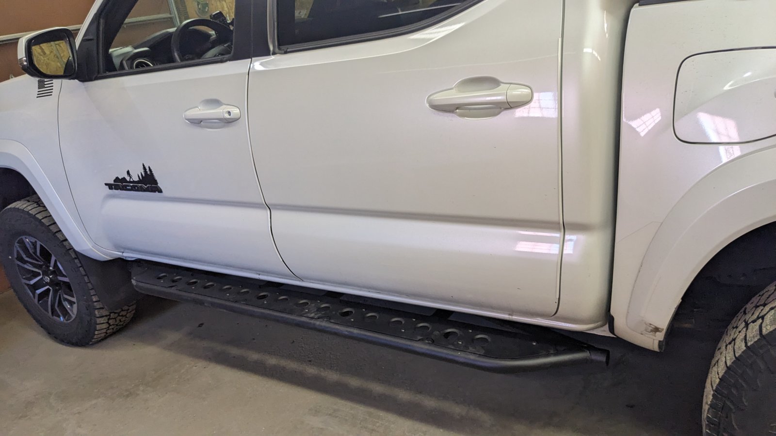

    Well, I got these installed. I have a 2021 TRD Sport, MT, and, although this says a roughly 2 hour install-it took me almost 6.
    I used my dads garage, and he helped as much as he could (I didnt want him to, he is in his 80s, but he is stubborn as hell, has a garage full of tools that makes a mechanic shop look unequipped for the job, and simply cant say no to my dad).
    When I bought the truck new, I had it undercoated. This proved to be a a little bit of an issue, as getting the plastic tabs that clip the brake lines to the frame were coated, and took some coaxing.
    We did the driver side first.
    The prep took about an hour. When we started to mount the sliders onto the truck, we ran into two issues:
    First, the 14mm bolt hole does not line up at ALL under the truck. Not sure if its different on the Sport model, but it was off by 3" at least. I opted to simply remove that bolt, and not worry about it. My dad insisted I call them, to make SURE it isnt needed (I mean, there are 3 bolts going through the frame, 3 clamps, the front diff bolt, AND the handle bolt thingy-but ok), and, according to whoever I spoke to, he said its fine if it doesnt line up. Done. Took it out, and tossed it.
    Second issue on that side I ran into was the holes in the slider not lining up to the bolt holes for the plastic box on the drivers side. They were about half obstructed. So, took the slider down, drilled out bigger holes, then called it a day. Problem solved.
    After over 3 hours of that, we moved the truck, and got to work on the passenger side. All was going fine, for the prep, until the 14mm bolt. Again. Attempted to take it off, it stripped, so we simply burned it off. Problem solved. The rest of that install went fine.
    All in all, the sliders look fantastic. They are well secured on there, solid, and beefy. I have no doubt they will do exactly what I need them to do, which is provide protection to the bottom of the truck. And, being 0 degree steps, they make it much easier for those of us who are vertically challeged to get into the truck :).
    Here are a couple of pics, installed (didnt take any while installing, as it was just me, and my dad offering his sage advice.
    Above, this is the passenger side done (this side, barring the cutting off of the 14mm bolt, took less than an hour)
    Above, the PITA install of the drivers side. These are staying with the truck, when I sell her in 20 years.....too much of a pain to remove!!!
