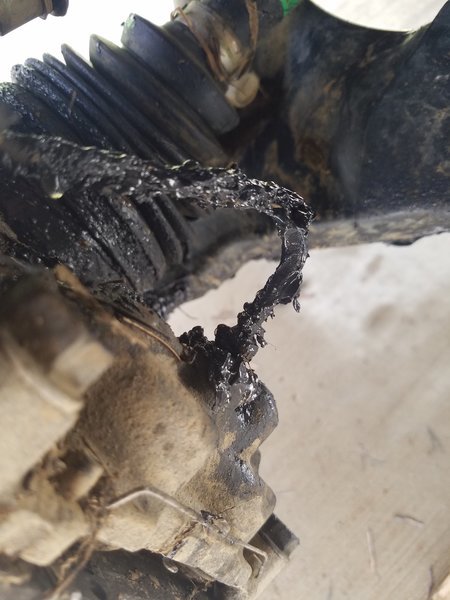

    Alright mechs. Do I need to be concerned? Took her off road. Stretched her suspension out finally. First real off-road adventure. Everything is tight and the tubes connecting are intact. 20170416_140557.jpg20170416_140606.jpg 20170416_140555.jpg

    You have a torn boot slinging grease.
    It needs to be fixed.

    Grease on the outside means less/no grease on the inside.

    CV Axle is caput. You'll want to replace that. Go to cvjreman.com and hit those guys up. Great parts.

    Nah man warranty. Toyota will pay for it. Didn't fucking do that much. Shouldn't of killed it with a few bumps.

    You kids and your warranties... I actually have 2 CV axles sitting at my place to replace mine again.

    Yep, CV boots are pretty fragile really & I see some wire wrapped around it trying to keep shit straight haha, but regardless need to be changed...

    So the CV boot clamp fell off. Nothing to worry about. Got some grease, screw clamp and bam! 20170419_201826.jpg 20170419_201819.jpg

    So far so good. No sign of leaking grease or movement of the clamp. I'm going to consider this a temp fix still. Toyota will repair the faulty clamp that snapped off.
