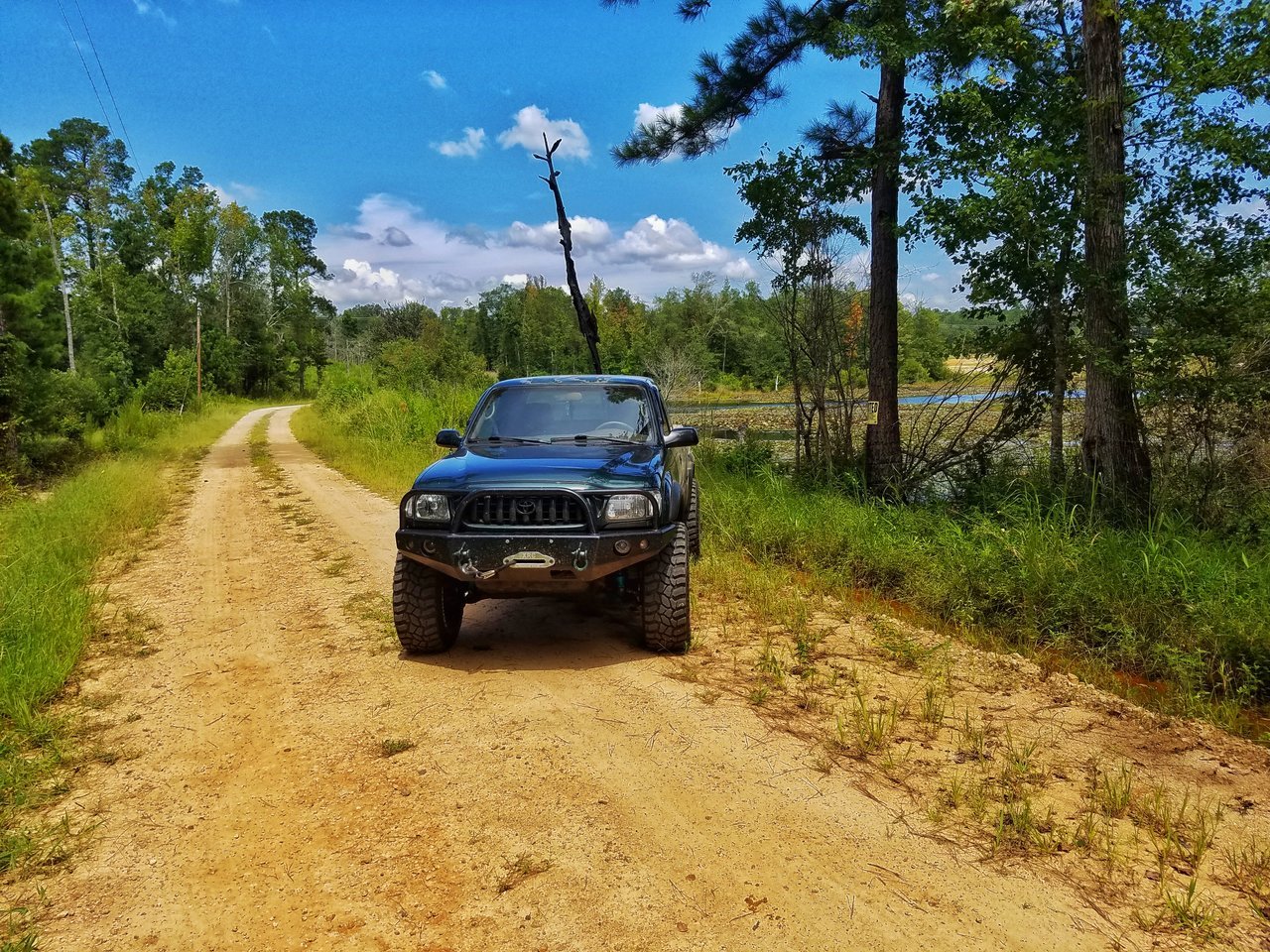

    I've got the same truck, put on a set of 5100s with OME 881's and gained around 2 inches or so. I'm sitting at 24" I believe from Hub to fender. I'm happy with the ride.
    One thing to keep in mind with the eibachs is that they are 620 pound spring rate, which is damn stiff. They'll probably give you at least 3" of lift but with no weight up front the ride will be roughhh. OME has a few different length coils with around a 500 pound spring rate (883 I believe).
    Here's a pic of mine, its settled a slight bit since then, but I'd say 2 inches is accurate. Also have a AAL installed

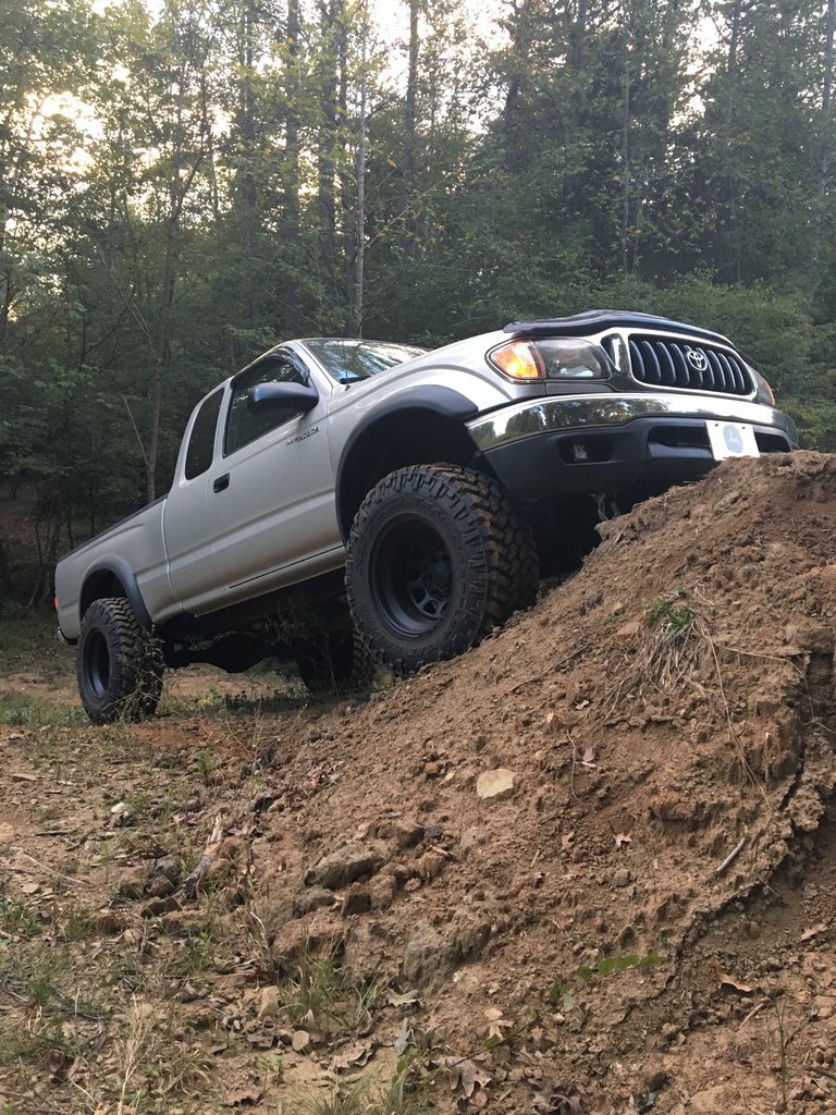

    I'm just running a top plate spacer for now, plan to upgrade soon. But I did gain 3 inches in the front with that and I'm running a 32x11.50 on 16x10s 4 in bs. Also on the fence on what coils to go with whether the eibachs or 883s. Don't have measurements off the top of my head.

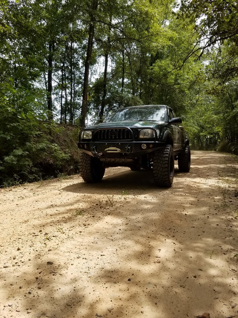

    I'm on kings with 650lb coils, overkill for a 4 banger but maybe I'll be dropping a new motor in
    Kings set at what ever they usually are and a 1.5" lift shackle in the back on 275/70r18 33.4x11.320170826_135005.jpg

    I'm on 650lb kings and the ride is a bit stiff but I am pretty sure I have more than the 2.5" kings are usually set at

    So I got measurements of ~24" up front, and right around 24.5-24.75" in the rear.
