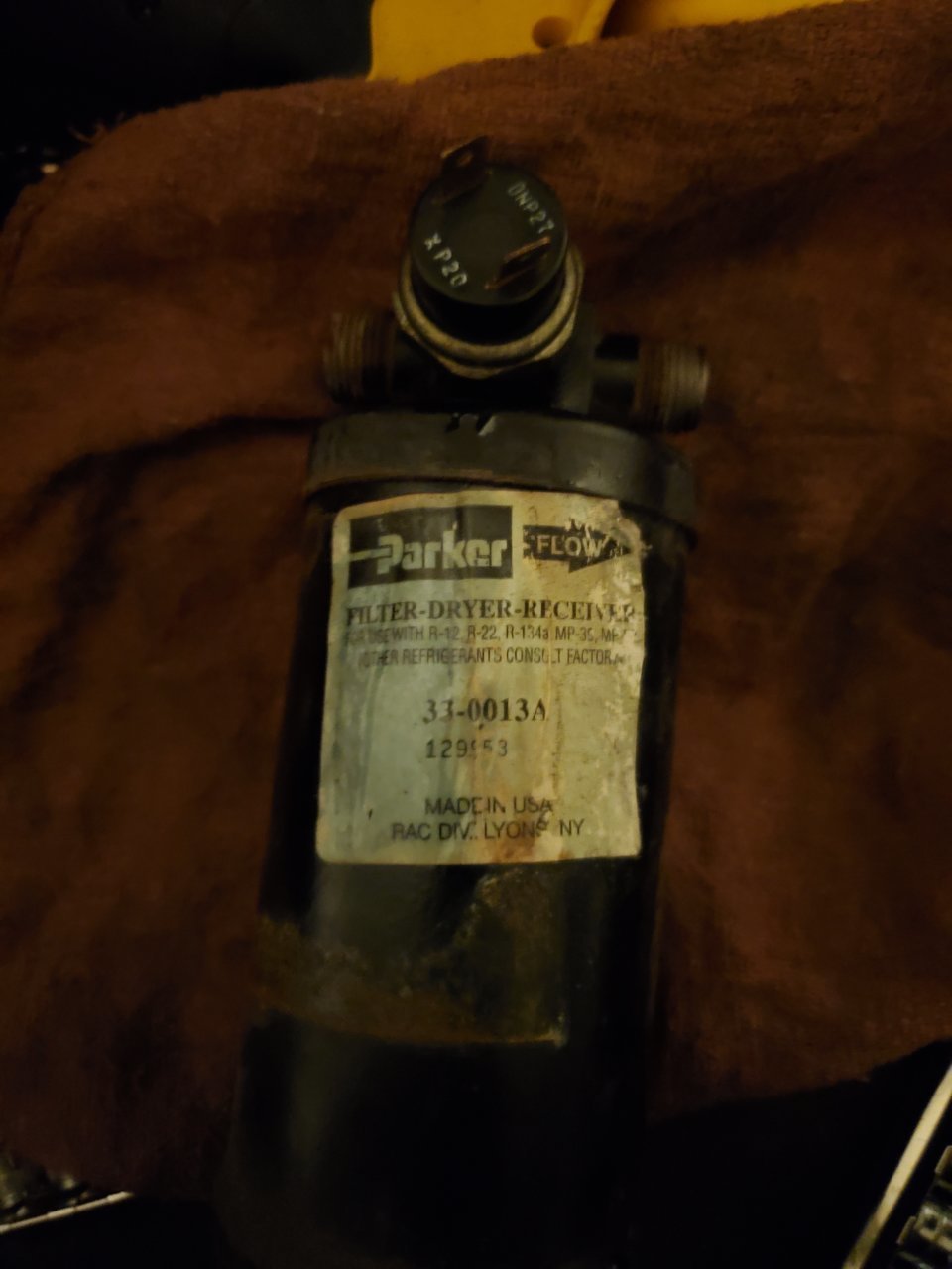

    Ok, I have a 92 pickup with a aftermarket R134 a/c system. The a/c works and gets cold but the compressor won't shut off, the high side will surpass 300psi, I suspect the high pressure switch on the dryer is bad but the dryer is obsolete and I can't find one anywhere.
    My question is, if I can find a different dryer with the same fittings and a high pressure switch attached to it, can I use it?

    I dont suspect the dryer is bad, I suspect the high side pressure switch located on the dryer is bad, but since this is a old system, I cannot find a new pressure switch or even a new dryer with the switch on it. That's why I'm asking if I can use a different dryer/pressure switch. I say dryer because I'm looking for a dryer with a pressure switch attached to it like the one pictured.
