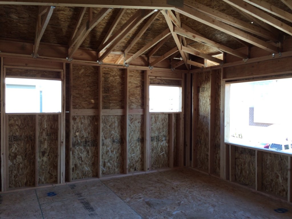

    If you notice the walls in the garage (in the right of the pic) they are 2x4s with spacing of 16" apart but the rest of the home is the 19.2" apart even the load bearing walls. The outer walls are using 2x6s while the interior walls is using 2x4s. Neighbors house is 2x6s using all same spacing of 16" apart but the interior walls are 2x4s with the same 16" span.

    Interesting. I wouldn't have any concerns about the 19" spacing with 2x6's, but i would definitely ask the builder what the reasoning is. Are both houses the same size and similar designs? I'd most certainly say the neighbor paid quite a bit more to get 2x6 at 16" and 2x4 @ 16" throughout his house... When you talk with the builder, post his response here...i'm curious.

    I did a little research also and people have questioned the spacing also because of structural integrity. Here's another shot of top floor in master bedroom...the spacing under the window is wide as hellfedc75c029d70b3fe129d4b8d1589b5d_8bc3fc033d9f784308a6d7fc36ec26f702f506ca.jpg

    Studs
    2x6 walls @ 24" OC is a standard framing assembly that generates less thermal bridging than studs @ 16" OC

    24" OC studs are better from a thermal efficiency standpoint and will support the same vertical loads as a 16" OC framed wall unless there is some specific point loading . The only advantage to a 16" OC wall is resistance to bending due to wind loading but that is generally only a consideration in taller rake walls
