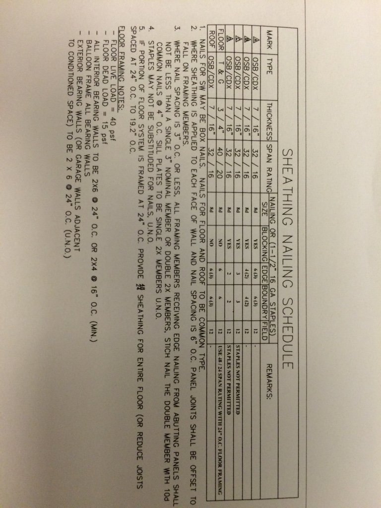

    I'm sure your builder understands what your local code is with respect to stud spacing and I would not be concerned about it judging by the pictures you posted
    Does it not state a stud spacing on your approved permit house plans ?

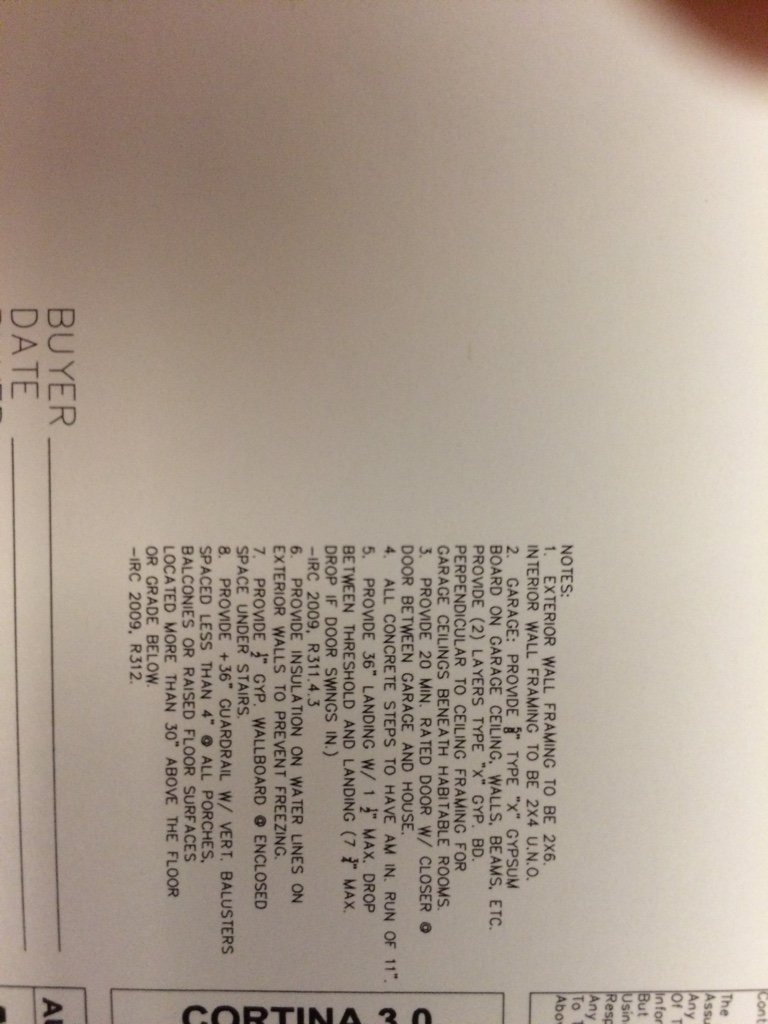

    Yea it's Hardi Plank. Is that good siding? Here are a couple pics of building notesde0fbf83ff71328361ff13b1286ee1da_f809f4772d9fe4f88550b467bb1eb2d9cad0fbc5.jpg04654954e1375862a28dc51bac80b5f9_e62b1f903f99f022f2684faa255f5ae29e16680b.jpg

    Sorry for pics coming out sideways

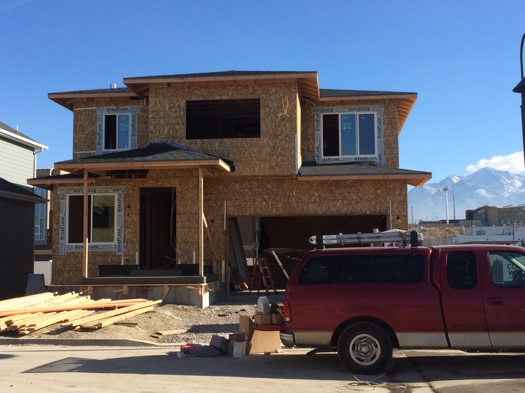

    Here's a pic of the house and roofing line...as you can see it's not a tall roof so R-50 will be a challenge but they offered it as a option and took it.9430f136270caac0da3b0c3e0ed9c3f1_408b00461f8d60d01866edce69bf6b275e7b80f7.jpg

    Vaulted trusses generally have enough depth for R50 except maybe at the heel , it depends on the inside pitch versus the roof pitch
    You could do something like stacked high density R28 batts
  20. Dec 7, 2015 at 11:40 AM
    #60

    that would definitely be more economical than the spray foam option.......also friendlier to the shingles lol
