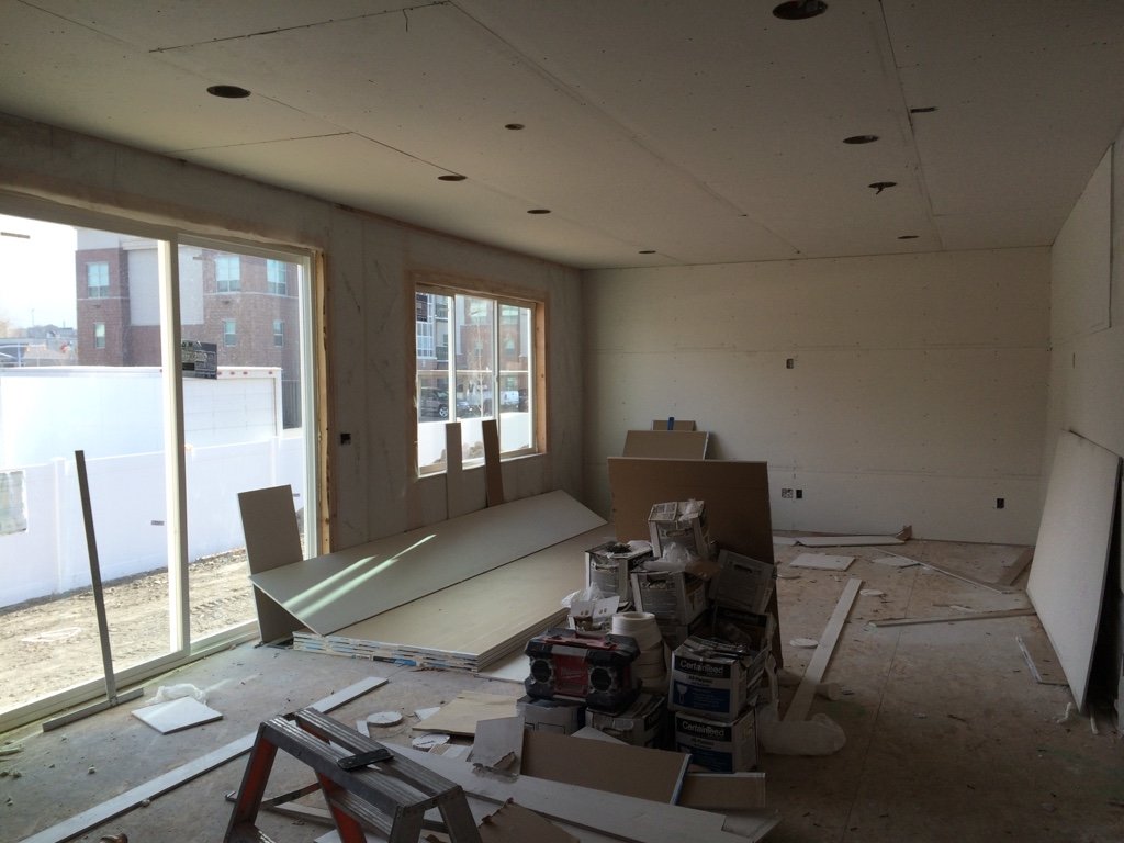

    Might as well make this my house build thread lol here is a update as of this weekend...they ran out of material so they had to stop didn't think that would happen2b0c3e7fcd9ce42677fc414560aae55a_569f76a16dec202559628ce80deab76a270d3f44.jpg
