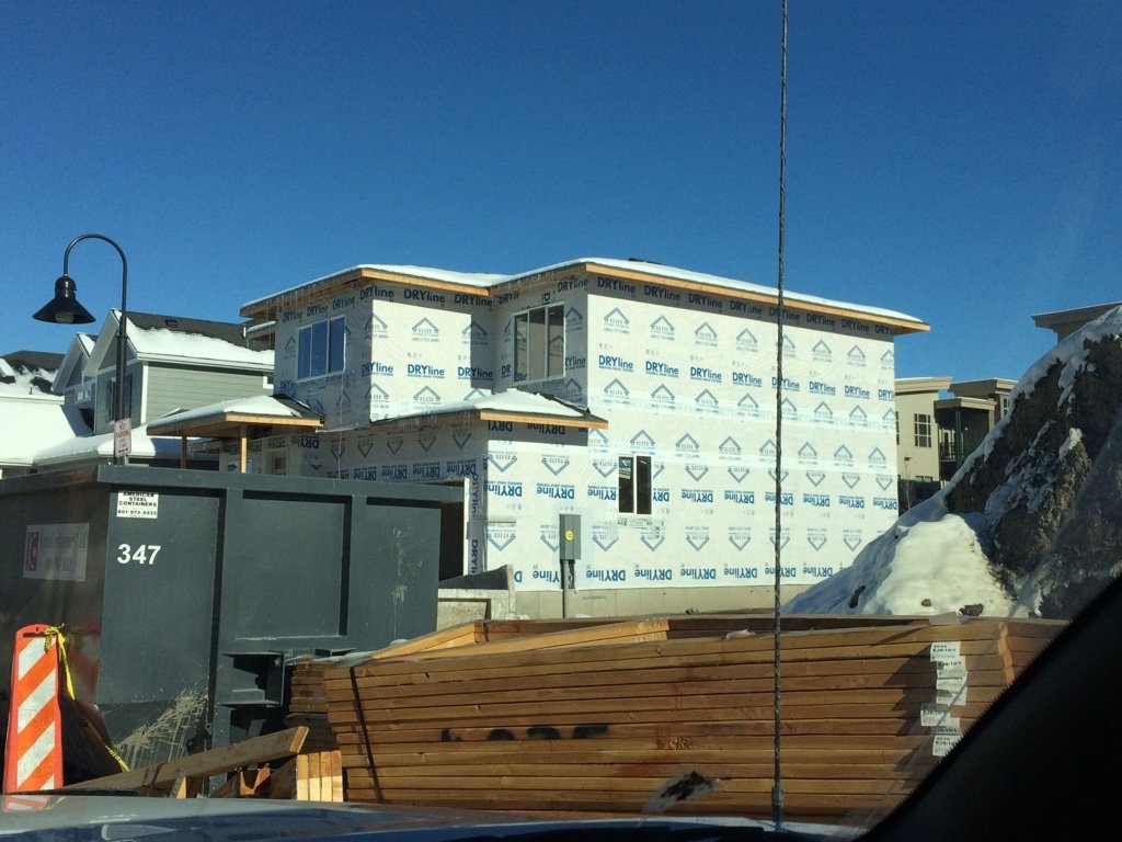

    Congrats on your purchase this is my first as well. I'm using 2x6 and 24"OC along with DRYLine house wrap and hardie board for the siding. My walls are upgraded from R-19 to R-23 and my ceiling is upgraded from R-38 to R-50 and also had the garage insulated from nothing. My floors in my house look like 3/4 sheathing i could be wrong.

    Thanks for all your reply guys. As this is my first brand new home i worry about integrity and life span of home along with durability during storms and high wind gusts. I know my house has about 8 hurricane straps so that good I guess but the 24' OC is my only concern. The efficiency of the home is very good as I upgraded to blown in insulation and Lennox 96% effciency heating unit. As OZ said I have less thermal bridging with 24" OC vs 16 OC" with more insulation in the walls the wood.

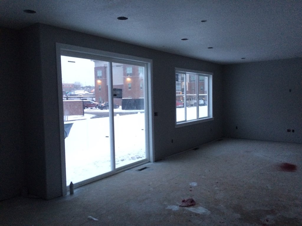

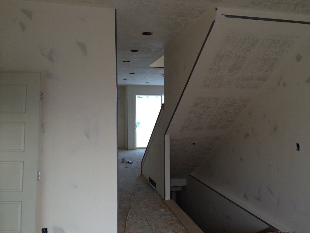

    Here are updated pics, I have a crap load of can lights in the ceiling. I might of went over board lol1b9e19e50268638d020c38d7e51dddd4_e042498eaa6eaefdd087063b2eceb1f6bef09040.jpg7facf307e7aa20f863f7d6028f2345b9_a6a9573bdfbdb162b2fb90ca79c269b1c6d5077b.jpg4af7f55e7dfa42cc00c10bb01f7be9aa_fb877effcd4673cb07bf370b96d5472cf415829b.jpgb8b47d59135418c6c775b55ccf6c9e71_40da2acc5e23f19aa34687ba46cf1f15f698cec3.jpg The Hardie Board will eventually be painted and also the door

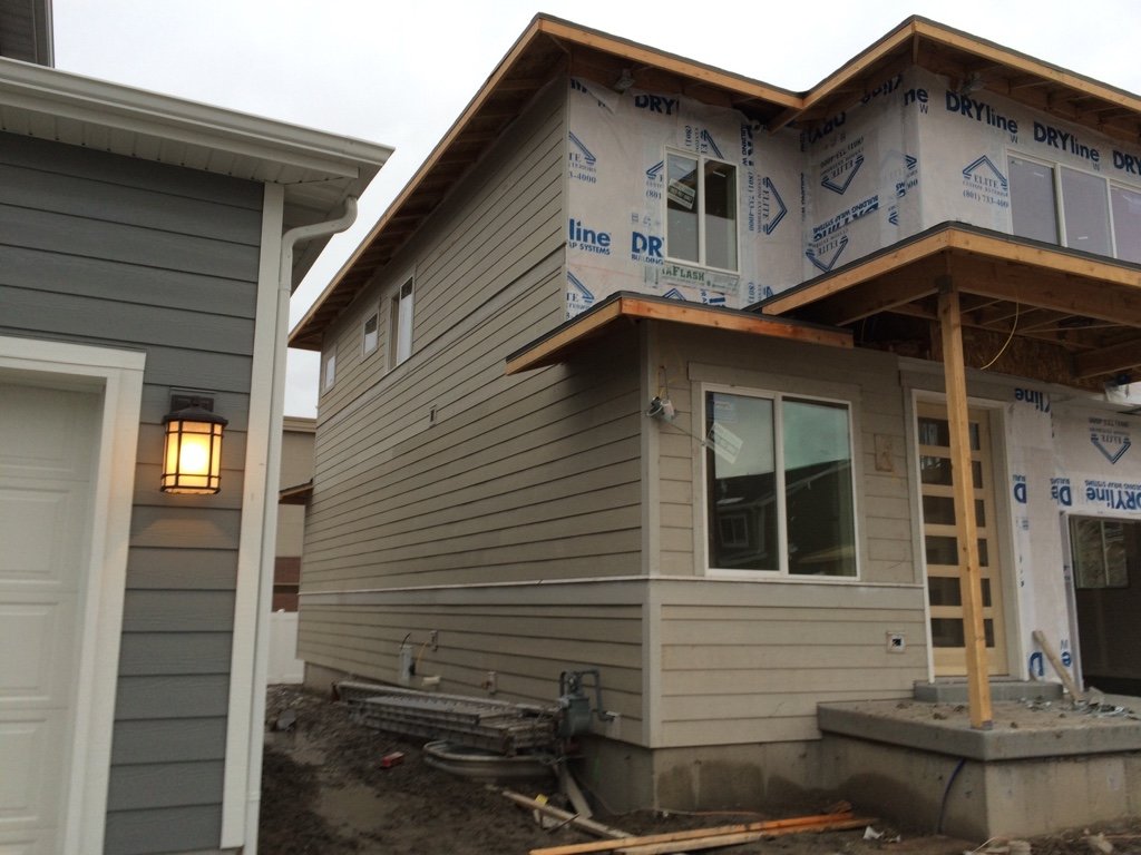

  17. Jan 15, 2016 at 1:12 PM
    #157
    Gincoma
    Gincoma [OP] Special Edition Member
    Nov 14, 2010
    #46179
    2,117
    Salt Lake City UT
    RIPieces 2005 Tacoma, adios 2011 :'(
    Factory Monster Truck Package with reverse gear.

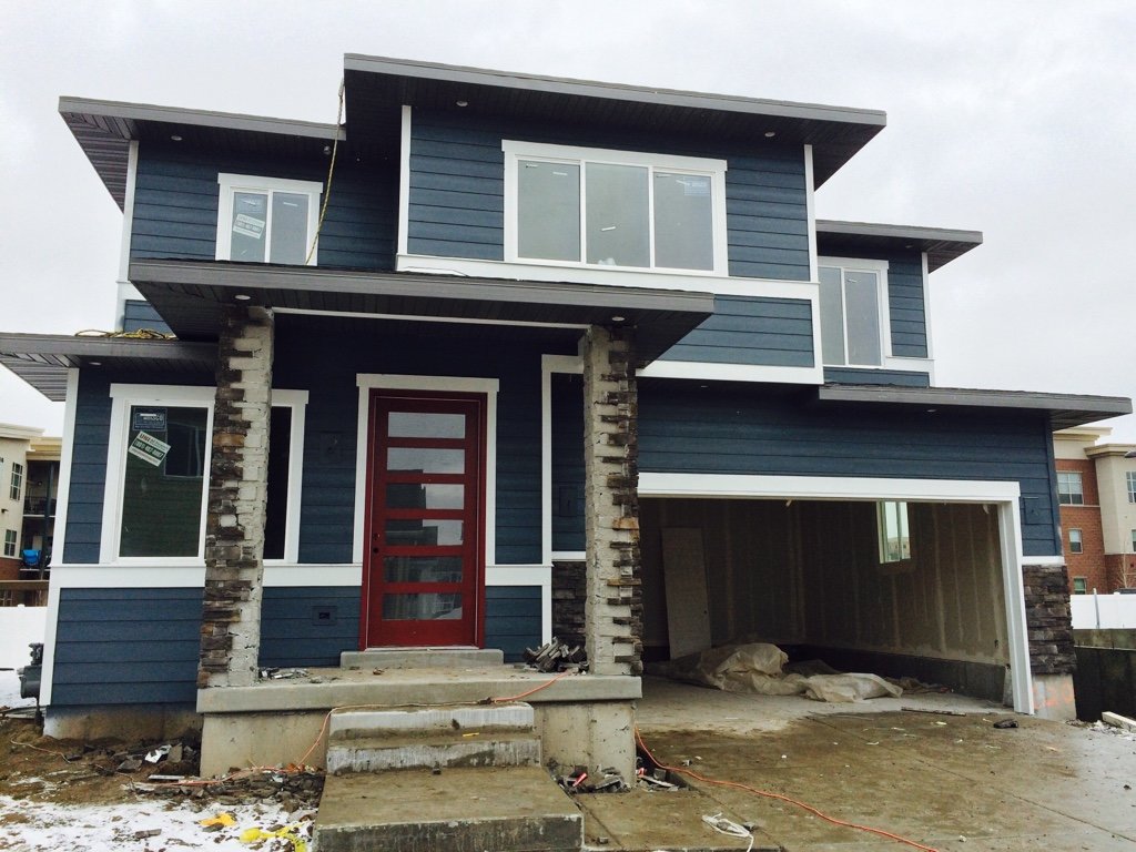

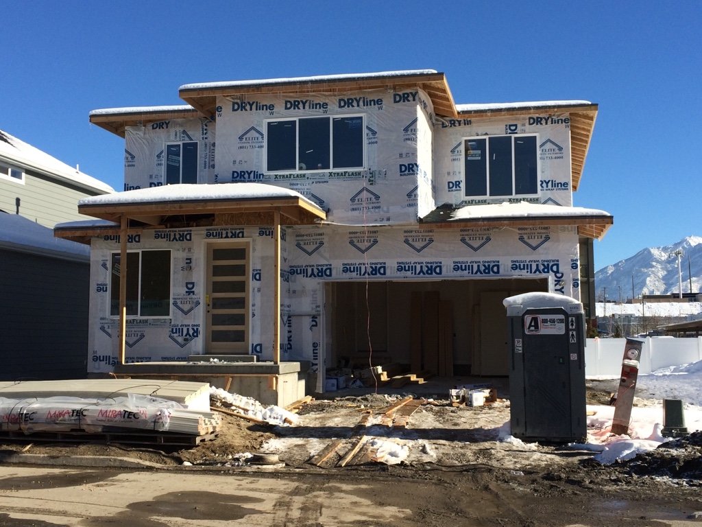

    Just wanted to share the outside of the home...it's almost done on outside they just messed up with the pillars and they are taking out the grey soffits to put white ones in...not sure where they got the grey from but nonetheless I'm happy f01ef8373b37df76835086740e9a37ee_b948c870318b62ecced1154dcdeff210eec08ab9.jpg
    Biscuits and DrFunker like this.
  18. Jan 15, 2016 at 1:28 PM
    #158
    OZ-T
    OZ-T I hate my neighbour
    Dec 15, 2009
    #27584
    50,585
    Peter North
    British Columbia
    Why is the living area stepped up from the garage elevation ? Is that due to site conditions or just a design choice ?
  19. Jan 15, 2016 at 1:37 PM
    #159
    Gincoma
    Nov 14, 2010
    #46179
    2,117
    Salt Lake City UT
    Most homes are like that in that community some higher then others depending on location. I think it has to do with the water table im not 100% sure on that
  20. Jan 15, 2016 at 2:19 PM
    #160
    OZ-T
    Dec 15, 2009
    #27584
    50,585
    Peter North
    British Columbia
    Is it a crawl space under your living space ?
