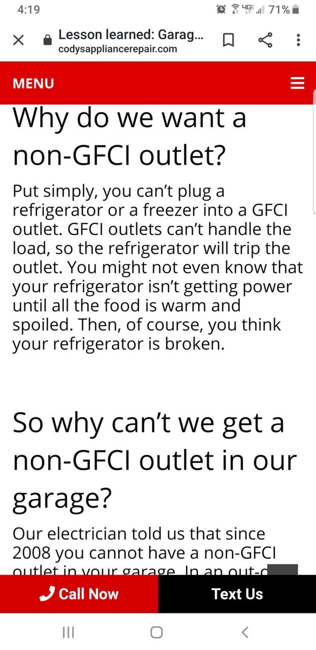

    Just bought a used fridge for garage, trips all gfci outlets in garage but will run on inside house outlets no problem. Can I just replace gfci outlet with normal duplex or will it still trip? House was built in 2019

    Yes I run a deep freezer and and a tv without issue. I read an article that fridges cant be ran off gfis?

    Gf is tripping because it is detecting a difference in the current going in and the current going out on the hot and neutral wires. Meaning, there's something in the fridge letting current go out the ground pin on the plug, and so something metal on that fridge might have voltage on it. Fix the fridge, this is why gfci outlets exist.
    I'm not sure I buy the bit about freezers being too large of a load. But maybe it's and inductive load thing. Hnmm

    Here’s what I found on “Why”
    When a refrigerator is plugged into a GFCI there are a few reasons it may keep tripping the outlet.
    Nuisance Tripping
    Most refrigerators with vapor compression have what are called inductive loads.
    When an inductive load is switched off, it can produce electromagnetic interference (EMI).
    The interference can, and often will, trip a GFCI outlet.
    There are deceives known as snubbers that can be installed to eliminate, or at least reduce the effects of the interference.
    If you choose to go this way, the snubber will need to be installed between the GFCI deceive and the refrigerator.
    If you want to keep the fridge on a GFCI outlet, you can try replacing the breaker in the box with a GFCI breaker.
