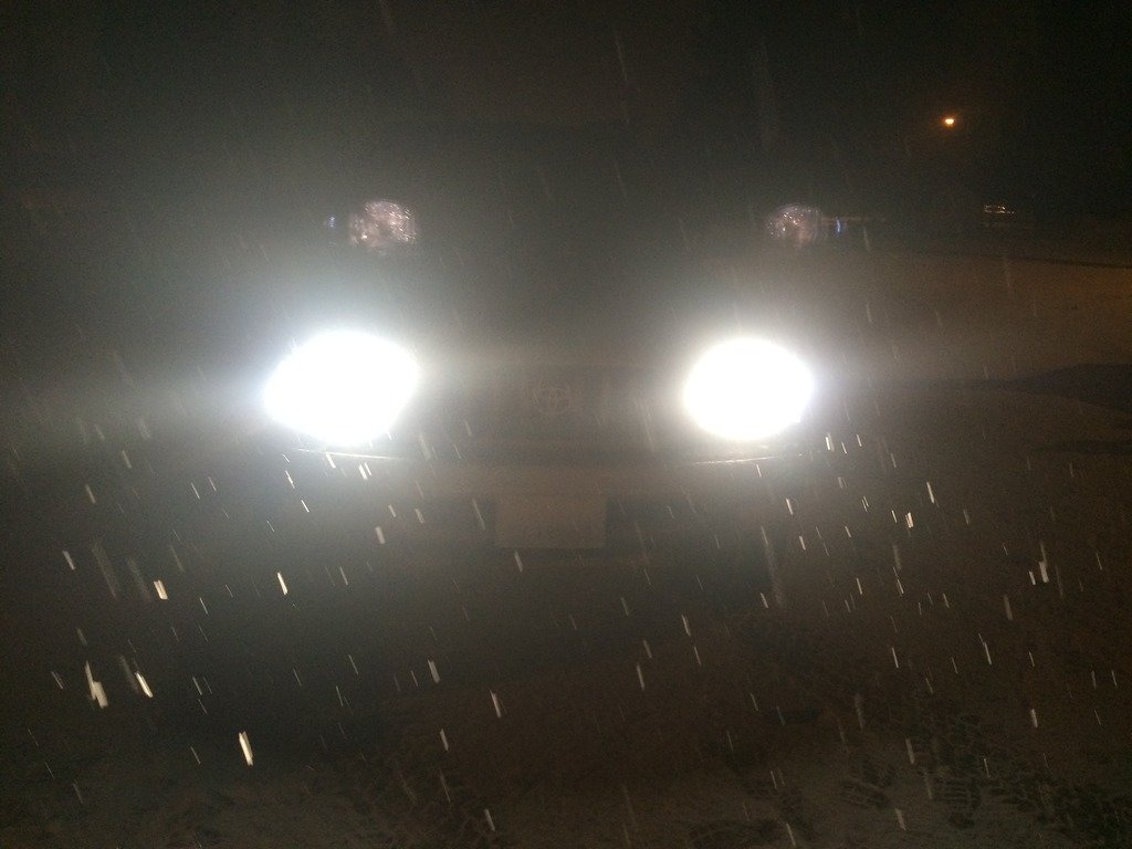

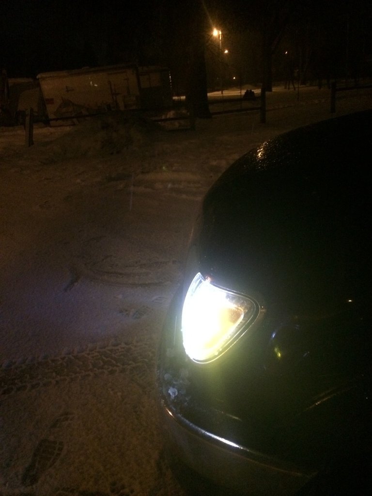

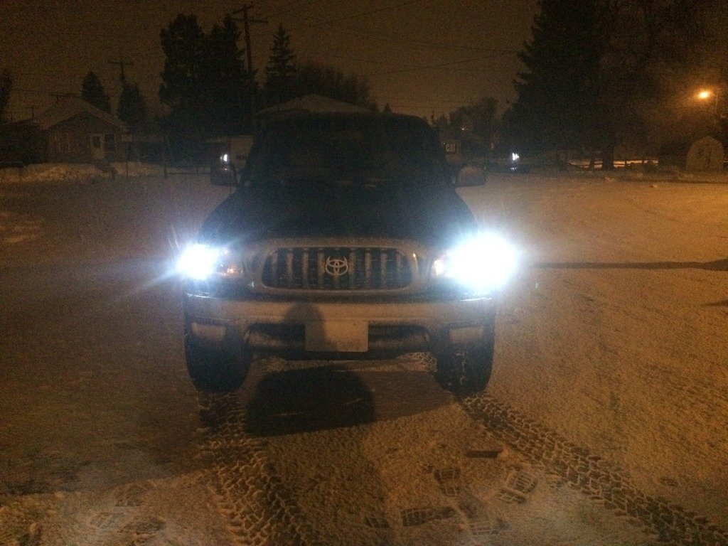

    2004TacomaSR5
    2004TacomaSR5 [OP] Nemesis Prime
    Apr 28, 2011
    #55722
    5,081
    Jon
    Montana
    2004 Tacoma DCSB & 1980 Toyota Pickup 4WD
    Tacoma is stock and staying that way, Pickup is TBA as of now.
    Took some pics of how they look at night.
    No idea why the one on the right appears brighter in the pic but they are both the same.
    Side view
    With headlights on.
    FirstGen Jer likes this.
