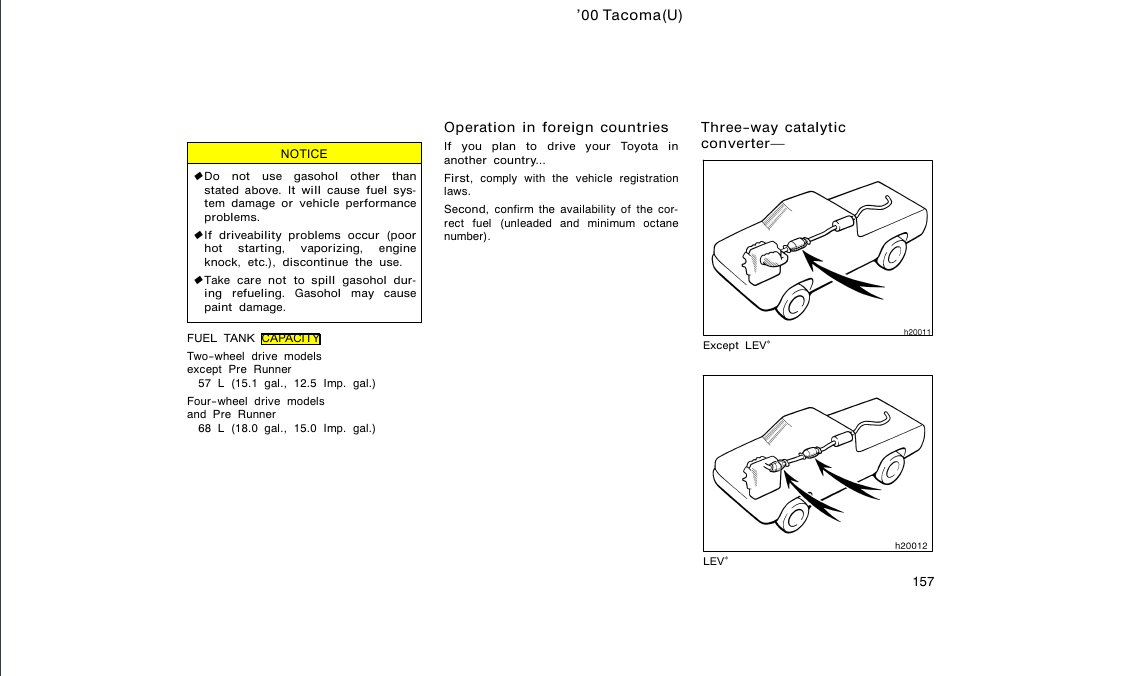

    Only 4WD models got the 18 gal tank, according to my owner's manual.

    Seems like the manual is making it sound like all 4wd models come with 18 gallon tanks

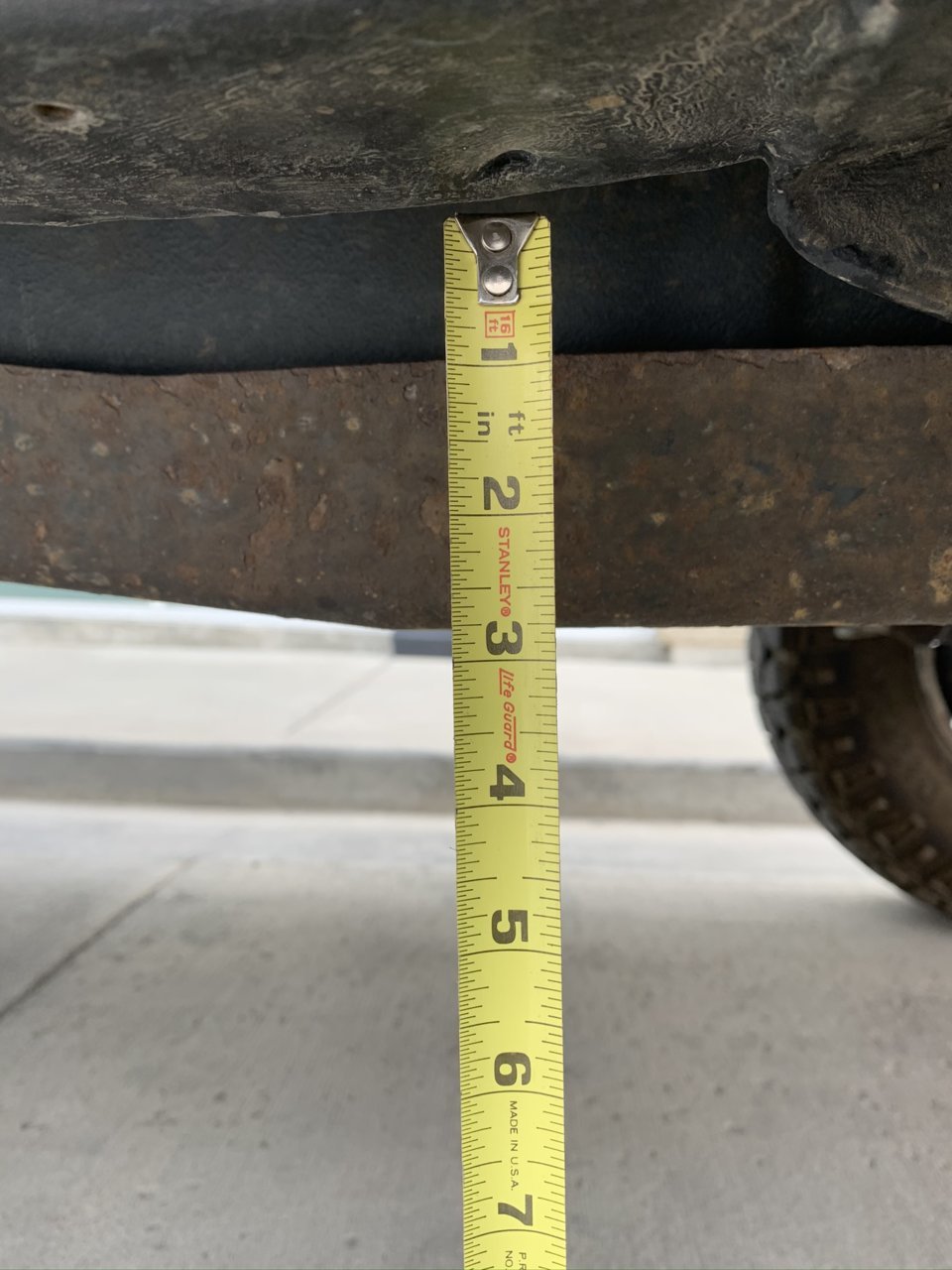

    Mmm, my skid plate for the tank is the same,
    I just called my dealership with my vin number and it’s defectively a 15 gallon tank,
    He said for my year 1997 that was the only option,
    So maybe a larger tank 18 gallons was added later so where

    My 15 gallon tank skid plate sits an 1.5” below the bottom frame rail

    Well hot damn. Mine is ~3 inches below the frame at the forward spring mount. Maybe the older reg cabs did have the smaller tank.
