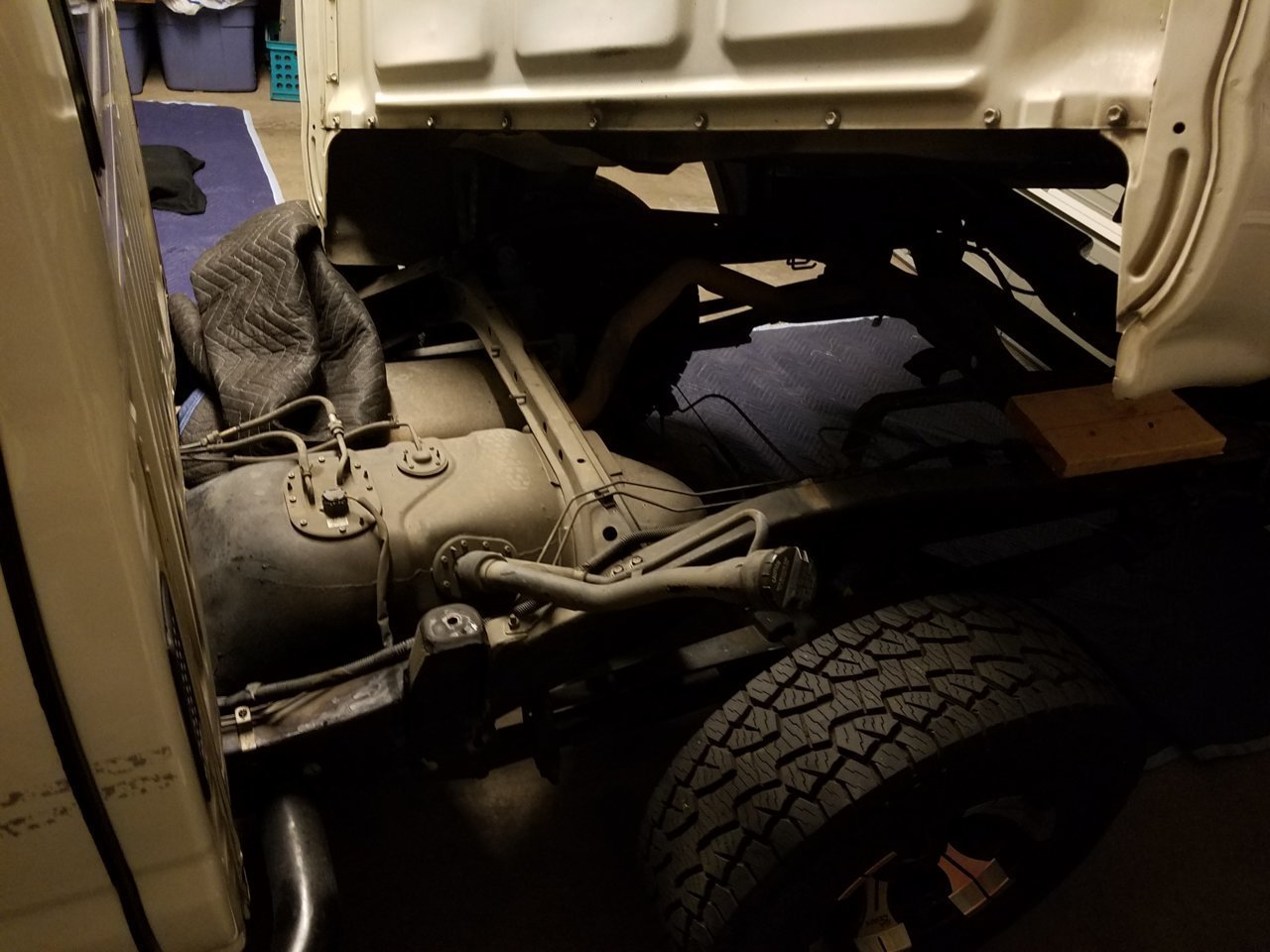

    Did you remove the bed or drop the tank,
    This is my 15 gallon tank when I did the fuel pump

    It's hard to see any difference between the 15 and 18 from the top. I than removed the front 4 most bolts and loosened the back 2 bolts then tilted the bed up.

    with it being a bit deeper, will he have issues re-installing the fuel shield plate underneath exactly how it was or have to mod it?

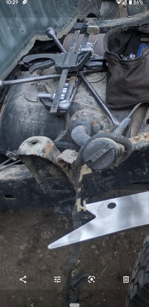

    drop the tank and re-install quoted at roughly $277 here
    looks as though the filler neck needs to be undone to drop it from under?!?

    so the fuel tank would be removed completely out of the way with the neck still attached?

    The filler neck is sorta just stuffed up there, I've pulled the bed a couple of times and as long as you take off the gas cap, it just pops out.

    Yes no reason to remove the filler neck. Just take the cap off. Also if you remove the filler neck trim off the bed it gives you more room to move the neck around. Only thing is the little screws like to brake pretty easy if your not careful.

    from john's picture it just looks like the neck goes over the top of the frame rail a bit far for the tank to drop straight down (neck still attached) with no issues and no need to tilt the tank awkwardly to wiggle it out without taking the whole thing apart :notsure:

    Yes but there is a 12mill bolt holding the neck to the bed mount on the frame. You need to be able to get to it and remove it or when you drop the tank down it will be hanging by the neck off the frame. You can also get to it easier but removing the wheel well plastic trim.

    yes, i have located the bolt holding the neck that @Tour991 speaks of
    i've spent an ample amount of time over the past month cramped underneath staring at stuff!
