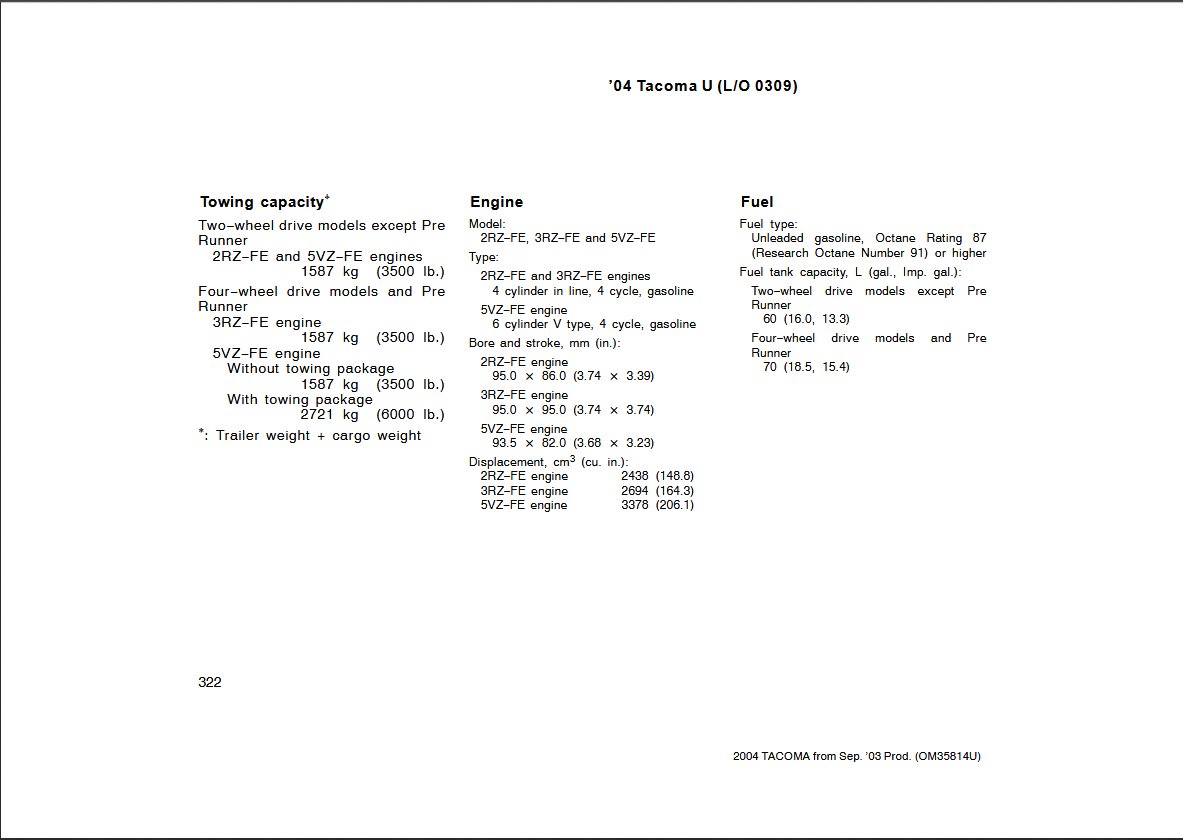

    Yeah so I'm pretty sure the later first gens (maybe late 01 to 04?) had an 18.5 gallon tank. Manual and everything mentions it. I've filled my tank up more than 15 gallons like some people with 18 gallons have said.

    no, 2wd trucks (except Prerunner) still had the smaller tank (upgraded to 16 gal), according to the owners manual and parts stores. And you can see that 2wd tanks are still shallower thant 4x4 fuel tanks

    I was talking about 4WDs and PreRunners. I see a lot of debate on here that all trucks without a 15/16 gallon tank had an 18 gallon tank. I'm just mentioning that our fuel capacity seems to have bumped up for the 4WD/Prerunners half a gallon later in production.

    ah yes, well, they indeed upgraded to 18.5 gallons in 2001
    I guess it is the top bump that allows for this extra 0.5 gallon ?

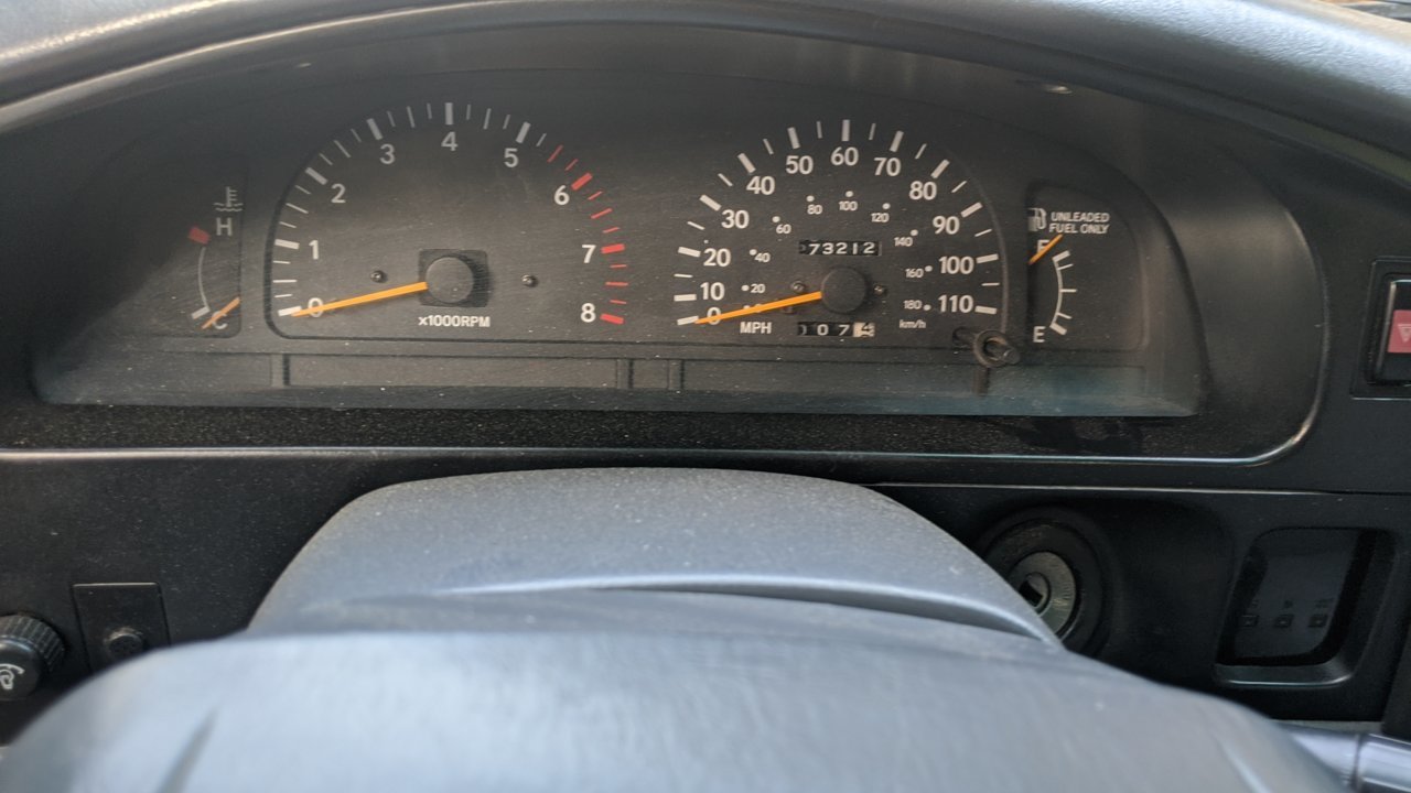

    Just went and filled up. The gas gauge was below empty. Almost to the point of me getting nervous. I know for a fact I have a 18 gallon tank and I filled it all the way up to the top of the filler neck. Got just under 15 gallons.

    Maybe you have a 15 gallon sender unit instead of a 18 gallon sender?
    Or the level arm is bent giving you a faulty reading?
    That’s how much I put in my 15 gallon tank is 14.5 gallons When or if I test my gauge

    I think it's just my guage. It goes way over full as you can see in the picture. I know the sender unit is correct when they are out of the tank and side by side they are easy to see the difference. I think I may just run it dry some time with a gallon tank in the bed just to see what milage I get.
