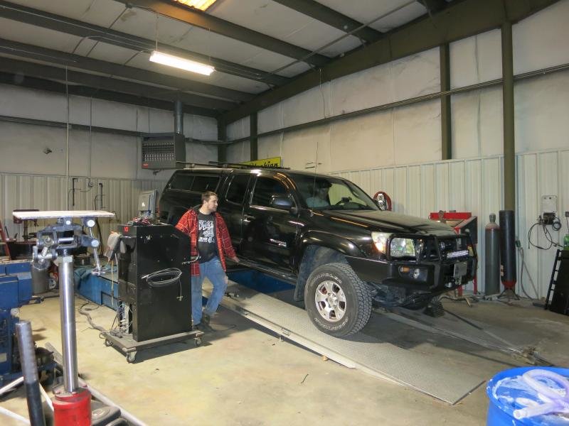

    I've got an ARB bumper with Warn XD9000 and wire cable on it and I run the 886s on my Access Cab; no packers although I have them at the house. Truck also has steel sliders, camper shell and some camping gear in the back so it's not a complete lightweight. I plan to install them whenever I get around to changing the UCAs. LT265 tires and only minimal rub at full lock.
    No measurements as I'm not in the States right now but you can get an idea of the lift in this picture.

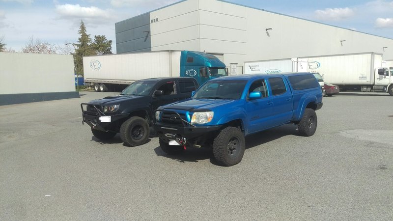

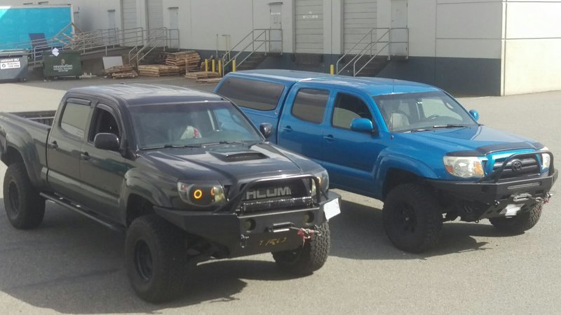

    Okay here we go.
    I can't get any measurements, just a couple shots of our trucks side by side.
    His is the sick black one.
    gracianoh[OP] likes this.

    Exactly what I'm looking for I got access cab too. I'd highly appreciate if u can get measurements

    I'm not in the US right now; not sure when I'll be back. The truck is stored at my folk's place.
    Here's an older pic though from the other side. The sliders aren't on it in this picture but there's a DRZ400S on the hitch hauler (OME Expedition springs on the back). Note that the ground is uneven in this picture so it's not sitting level. Best I can do you right now, sorry.

    looks like your friend with the 886s is a bit taller than yours am I right?

    Yeah I think he also put some spacers. His tires are also a lot bigger
