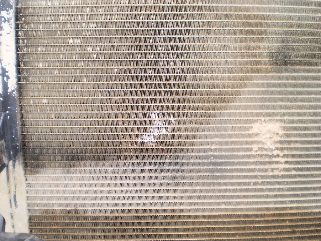

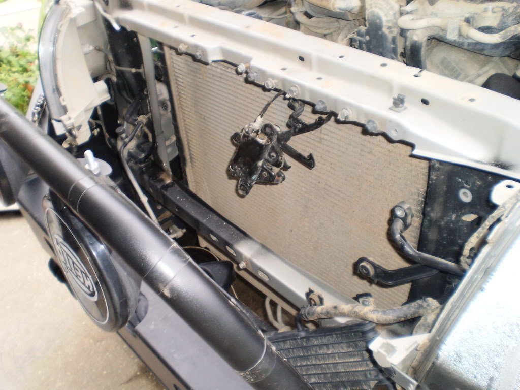

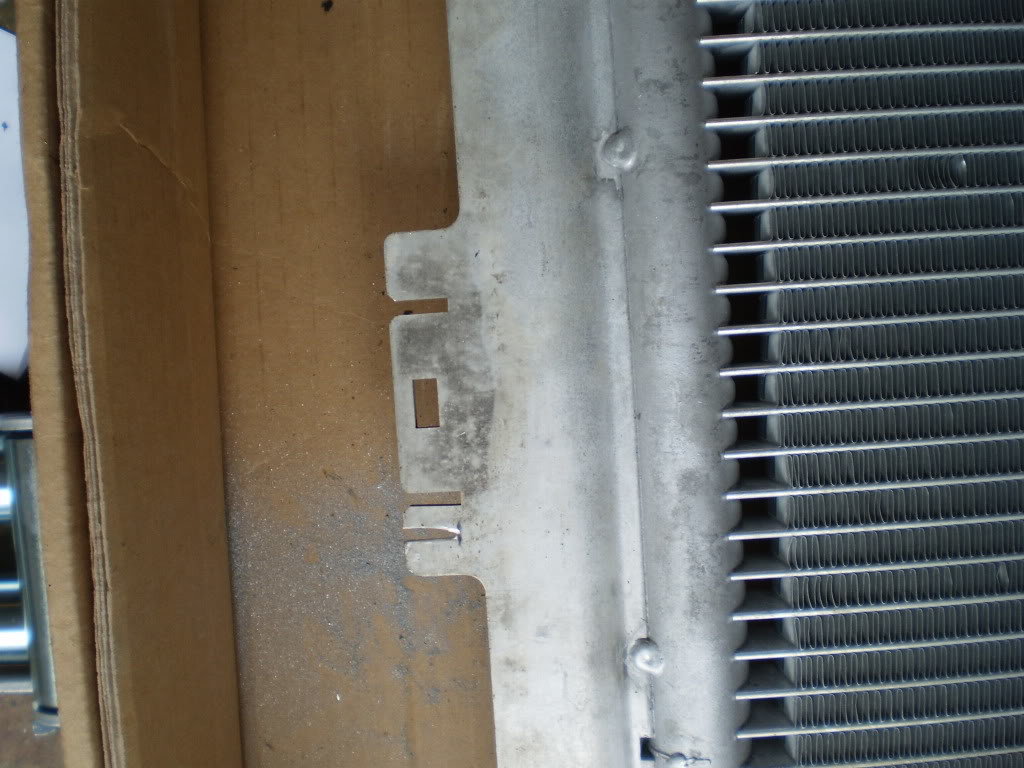

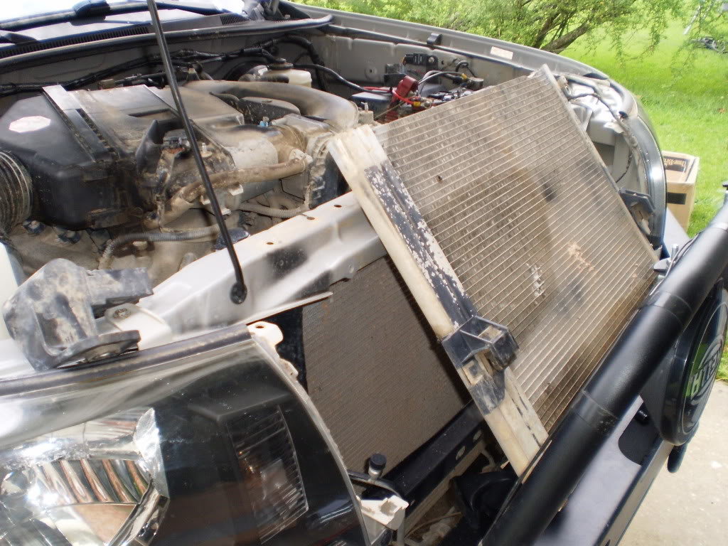

    Had the pleasure of putting in a new ac condensor today. Put a hole in mine yesterday, expensive screw up I will being paying for. New condensor 171 and 134a will prob be about 100 bucks. The aftermarket one didnt line up at all. I had to cut the oem braces to fit on the top of the new one, and the side mount had to be cut for the oem side mount. I give it about a 5 on the hard scale. loosen the Radiator and pull it back and slide condensor out and back in.

    Im not going to tell my secrets, was kinda stupid. I managed to put a gash in it.
