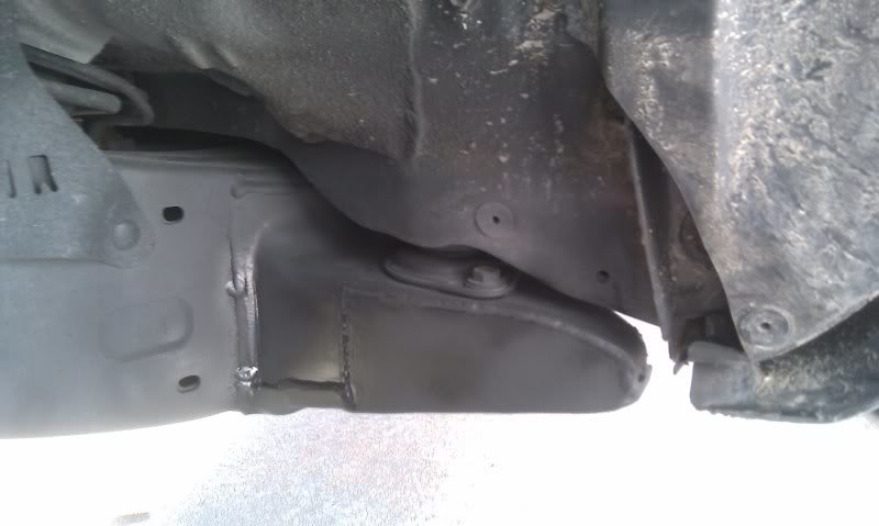

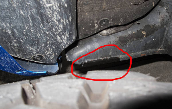

    After installing Icon coilovers and TC UCA's my front tires are rubbing on the lower part of the fender and on the frame beside ( see photo ) when I turn sharply going over bumps. I have had an alignment. Any suggestions?

    Cab mount chop. Talk to el tacorojo he can do it for u for a fee

    Anyone have any pictures of a cab mount chop?

    search around. He did mine for me a quite a few other people's in this thread too

    You can also get your alignment redone and have them push your caster out to 3.0 and just trim the front of your bumper a little bit.

    I have a brute force plate bumper so I should be OK in the front. Can I gain any more clearence from the coilovers?
