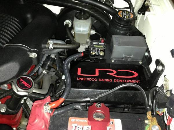

    OEM Quality and uses all weatherpack sealed terminals

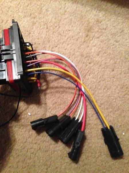

    before loom with weatherpack connectors
    I like not having to worry about my wiring, so I used all OEM connectors/terminals/seals, nothing to vibrate loose, and no connections to get wet and corrode

    if you buy a fuse panel and then 5 relays, you would be in the same ballpark on price.
    Its gets expensive when you start buying wire and connectors/terminals, but I did all my stuff as plug and play ( I can unplug any light, the compressor, without messing with the main harness)

    Where did u get ur connectors? Both female and male? I'm thinking f replacing all connections with thise

    And did u need special tools for the pins rather it being crimpers or tools to insert and depin?

    All of mine are weatherpack, and the best price I found was Amazon honestly, you can get a connector with male/female terminals and shrouds with seals.
    http://www.amazon.com/Delphi-Packar...10028&sr=8-1-spell&keywords=weatheepack+2+pin
    They come in all kinds of configurations, I use two wire, but they make 4, 6, and singles
    There is a special crimp tool and release tool that you can also get off of amazon for about 35 bucks.
    http://www.amazon.com/Delphi-Packard-Weatherpack-Crimper-Tool/dp/B002CCAEJ6/ref=pd_sim_auto_4
    if you are going to do alot of connectors, you can get an assortment from Summit or McMaster, but for low volume Amazon was best

    I used that tool to crimp 12 ga as well with no issues
    Just FYI
