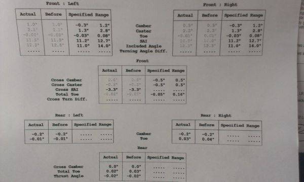

    Can't see fo sure since im on my phone but that looks like alignment numbas. Glad you have competent people to do it :Banghead:

    Were not even off that much but I can tell there is a huge difference especially below 45 mph. Had Yota do it at the dealer :anonymous:

    Soooo your caster is at 2ish* mine is at like 3*...wondering how much of a difference that would make...I has 5 years worth of alignments ...might try that 2* area...

    Stay closer to 3.

    That's the spec I heard over and over again so thats what I am at now...
    I am at almost exact 3 with 0* camber. It brought my wheels deeper into my fender with the new UCAs and that caster spec. What do I lose by doing 2*?

    It' gets slight more squirely. Lower the caster on these trucks makes the steering wonder more
