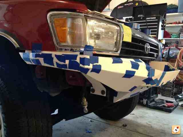

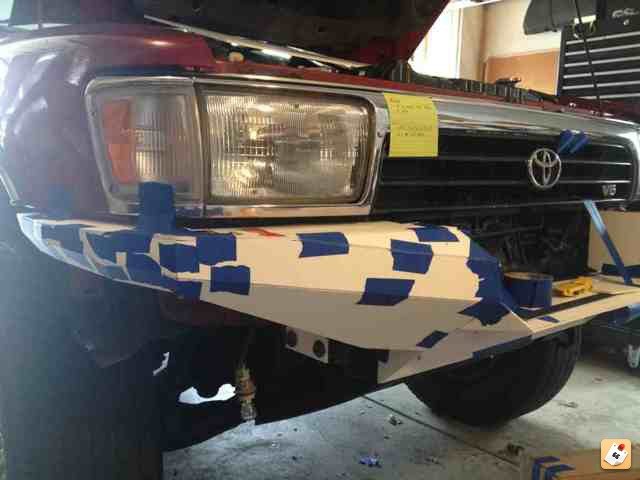

    Task of the day:
    Finish this bumper fab mock-up

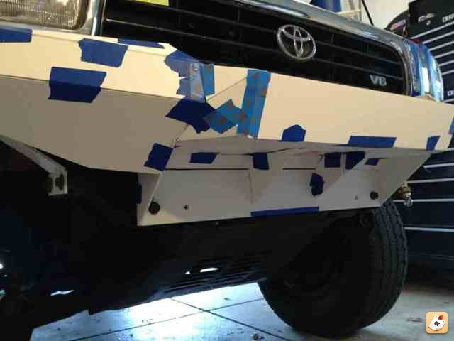

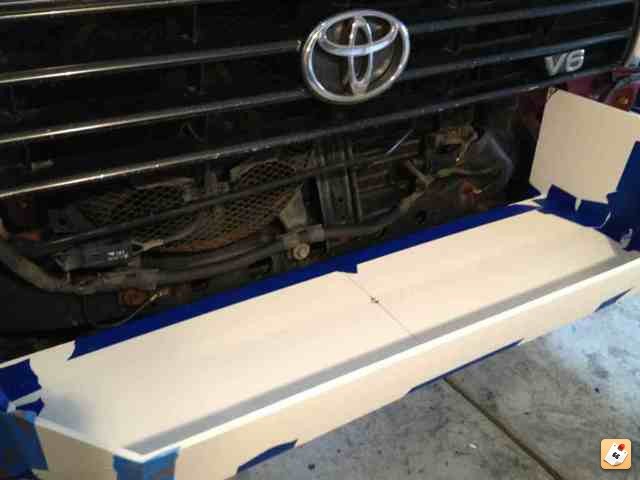

    I like the fact that you are running the winch plate out! Nothing sucks worse than having to pull the bumper off to fuck with the winch! Gonna be a nice bumper!

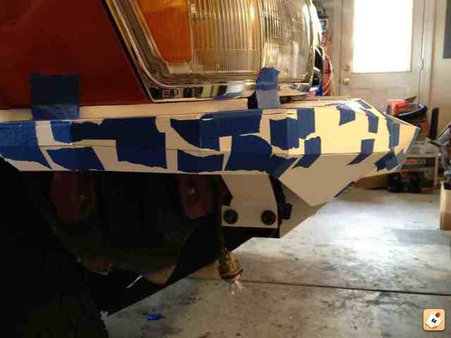

    I pretty much had to... They screwed me on behind the bumper space. Without going lower than the stock skid and killing approach angle, out and up top was the only option. ydydyzam_2550ecbd79ae33037e7b46a15cd365ff9a9c4261.jpgu8ebe7e4_cbe790234a8a3fa9ab244429e86babc5fbec20e9.jpgyramydab_d35f31ddbc2345bd7a22fe2d6daed9067ed079e2.jpgme8e6egu_78227f4b547ff05ec4d2cd54af6152eee12bd8e1.jpg
    Edit: before anyone brings it up... The vertical piece below the corner light is just a spacer for clearance during mock-up. There will be plenty of cab flex clearance built in.
