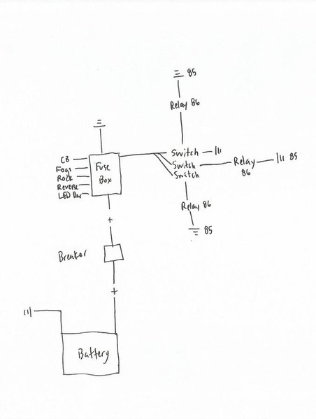

    CB
    fog lights
    led bar
    rock lights
    aux reverse lights
    eventually retrofit
    compressor
    locker switches
    winch switches
    thats all the extra stuff I can think of. But I'm still kind of confused, I know the switches need power so could I run the switches to the fuse box or to a relay together?

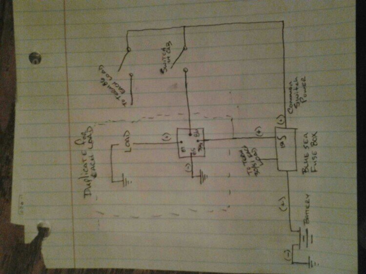

    1st gen/2nd? Didn't take the time to look. If 2nd pm me.
    You could run one power to switches and individual grounds to each relay input, and then common ground all legs of relays. Then each load has +12v to terminal on relay from fuse box, then lead to load and ground on the negative terminal of the load. I'll see if I can scrounge up a schematic.
    Like this:
    So a blue sea box has 6 or 12 fused circuits. If you run one common power to the switch panel you can have 11 relay controlled loads.

    :spy:
  17. Jan 21, 2014 at 5:52 PM
    rbraddock
    rbraddock Well-Known Member
    Jul 15, 2013
    #108314
    1,216
    Randy
    Hampton, VA
    13 DCSB
    6" ProComp lift from the dealer, slow build in progress
    No
    Like this
