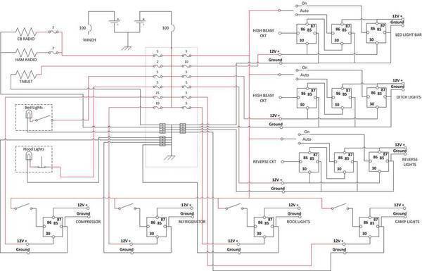

    Need to tune the CB and then start prewiring for lights.
    Randy can you send me that link to Barlowers multipoint switch array?
    Going to have 4 leds in the walls of the bed 4 on the bars of the rack, a strip on the awning, and then either the 2 duallys on there somewhere or possibly on a mast.
    Need to be able to control the rigids and the bed lights from inside the cab and from a switch panel in the bed.
    Probably leave the awning light control only in the bed.

    Here is my interpretation of his plan
    I will need to find the post on ExPo for barlows original design, but it is effectively the three relay setup shown in my schematic for each load you want controlled Auto-On-Off. I'll edit this post when I find his original.
    Edit: Here http://www.expeditionportal.com/for...Expedition-Tacoma-Build?p=1232897#post1232897
    and here http://www.expeditionportal.com/for...Expedition-Tacoma-Build?p=1235660#post1235660

    Holy wiring schematic batman. I'm tempted to pay someone to do all that shit.

    Not hard just time consuming.
