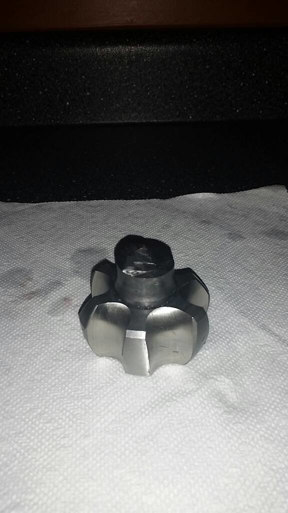

    Need to press the remnant of the axle out of this. There is an internal c clip in there that you have to break with the press.

    He's working till 5:30 ish tomorrow. Press is in his home garage

    I'm going to see if they have a press I can use at work at the motor pool. If not I'll owe Ron a case of beer...I'll let you know. Thanks mang

    I didn't know it was gonna be such a pain, didn't start on it til last night.
    Honestly not much to doing these.. I was nervous because the total chaos instructions have all sorts of warnings on the difficulty level. It's been more annoying then difficult. If your just doing boots it will be an easy job.

    The toyota parts kit comes with new clamps/clips, boots and grease packets. You may be able to get new bearing for the tulips but I'm sure they wear into each other so if the housings are toast it's time for a new assembly. They'd have to be really contaminated for that though.
    Pipe trick was that easy for one of mine. Lol
    Haha cv said SNAP. You have to cut the axle to get the cage/balls out of the outer joint if the slide hammer pipe thing doesn't work.
