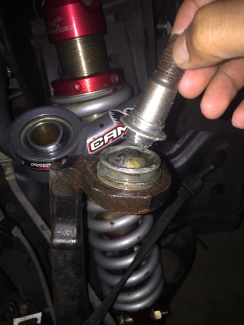

    IIRC, one of the issues was the press didn't sit straight and the ball joint would bind. You need a hammer to keep it straight, striking the press plate.

    I was reading up on it and I saw more than one write up where they hacked the threads off of the ball joint so they could fit a socket in it and that's what I did:
    I just don't think I had enough power to press it out.

    That's what the hammer is for :D

    BFH worked with the press! Thanks a lot for the advice guys.

    After hours of trying to get the fucking camburgs pressed in, @StAndrew saved the day. Fuckers are in now. Thanks man.

    Fuck 1st gen UCA's. Didn't help that the pervious owner probably hucked them through half the state of California and bent the ever living crap out of the snap rings!
    Seriously though, get a small piece of wire and loop it into the two holes on the ends of your snap ring and twist them together. Won't keep them from falling out but will be an easy inspection point to make sure they aren't slowly backing out. The driver side one has me worried. Maybe even call Camburg and get a new set of rings.
