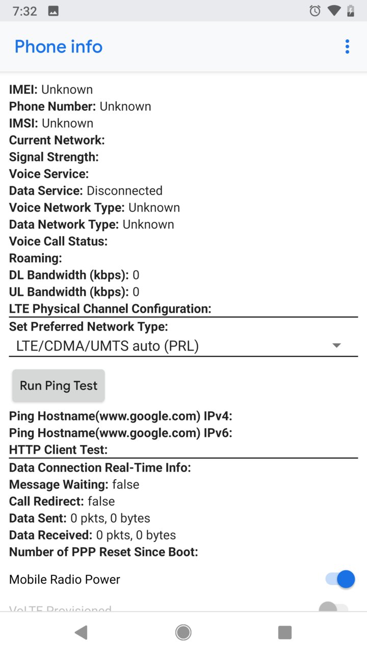

    Ive been a long time Android user, especially the vanilla side offered through Google's Nexus line. Right now I'm on a pixel XL, Marlin, and the phone recieved and OTA update. After it had installed I lost all mobile network connectivity. WiFi and BT work fine. And my sim card works in other phones. I have confirmed with T-Mobile that my imei is not blacklisted, and the phone still shows it in the bootloader when I run the fastboot getvar all command.
    Like I said, the imei is still shown in the bootloader, but once Android boots it isn't recognized at all.
    I haven't tried to downgrade OS from pie back to oreo yet to see if that works, and not sure what else I could try. Pie seems to have broke my phone. :notsure:
    I've reflashed the factory 9.0 image about a few different times now a few different ways with no luck.
    Anyone else had this happen or know of a fix?
    TIA. Much appreciated.

    Yep, the problem ultimately lied with my phone not having an efs partition or rather it was corrupted, and without the info contained in that partition, it wouldn't include my IMEI when installing the OS. Since the bootloader is a sub OS that doesn't rely on android to work, it would show fine in the bootloader, but when Android installs it couldn't recognize or discover my IMEI leaving it unknown after being installed.

    Do make a backup of your current phones EFS partition. Do not try and restore that partition to the old phone. Any chance you still have the old phones packaging? On that you'll find it's IMEI. With a lot of research you can edit that new phones EFS partition to use the old phones IMEI. Then you can restore that edited copy to the old phone.
