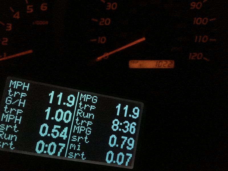

    Currently at 102.2 miles on this OCI.
    8 hours 36 minutes of runtime.
    Average speed 11.9 MPH.

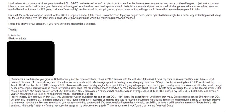

    I sent Blackstone an email and asked them a few questions and they emailed me back right away. Here is what they had to say:

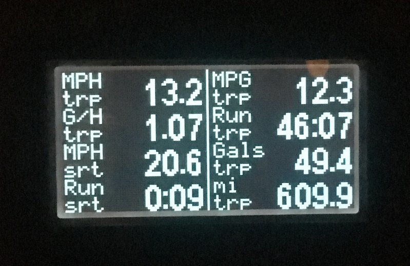

    This is at my most recent fill up: I also added the 'Gals trp' which keeps track of gallons used, I'm not sure how accurate it is, but I took this pic so I can see how much it shows that I have used in comparison to how much my tank holds at my next fill up. I have noticed that there is a slight difference in the trip mileage shown by my ultragauge and my truck odometer, I'm curious to see how much difference there is by the end of this OCI.

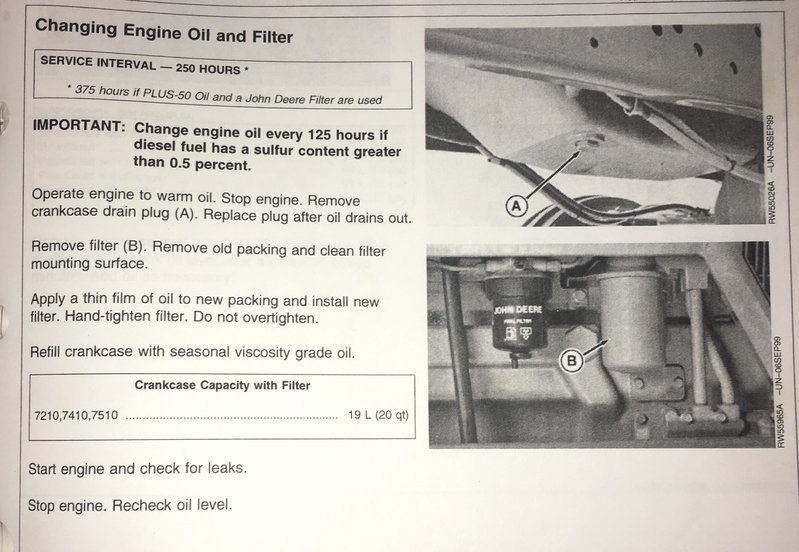

    Also, this is unrelated to the Tacoma but I think it's interesting. I was looking through the book for one of our tractors, a John Deere 7210 that we purchased in 2001 I believe. The service book recommends changing the oil every 250 hours. Below that it states that your OCI can be extended to 375 hours if you use John Deere PLUS-50 oil and their John Deere Filter.
    Then below that it states that you must change your oil every 125 hours if the diesel fuel you are using contains more than 0.5 percent sulfur.
    Now John Deere has what they call PLUS-50 II, they say you can run for a 500 hour OCI if you use their oil and filter. They will warranty your equipment using 500 hr service intervals and I have seen UOA's on Bobistheoilguy that actually show that this oil is actually capable of running longer than that in some applications.
    This is a 6.8 liter 6 cylinder Turbo Diesel engine (PowerTech 6068) that holds 5 gallons (20 quarts) of oil.

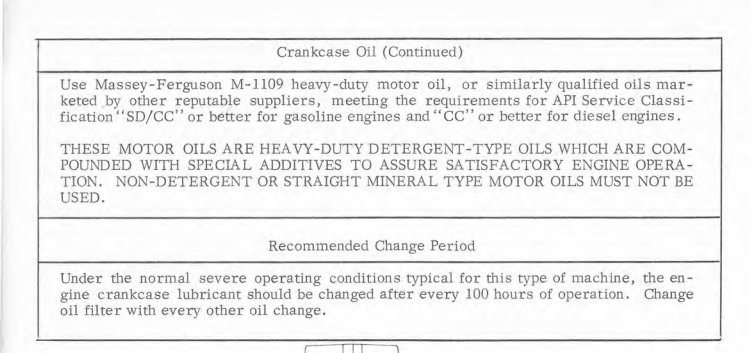

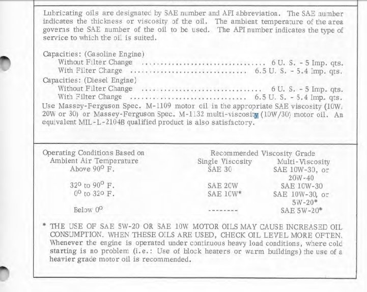

    We also have a Massey (3 cylinder Perkins diesel) with over 10,000 original hours (the hour meter broke when it rolled over to 0 at 10,000 hours). The Massey has been ran on Chevron Delo 400 oil its whole life. The recommended interval on it is 100 hrs I think. When it was new it was changed every 100 hrs (filter at 200 hours), but I think the OCI has been extended out as it has gotten older. The Massey had an option for either a gas or diesel engine and both engines held the same amount of oil... the OCI was the same for both, this was in the 70's though.

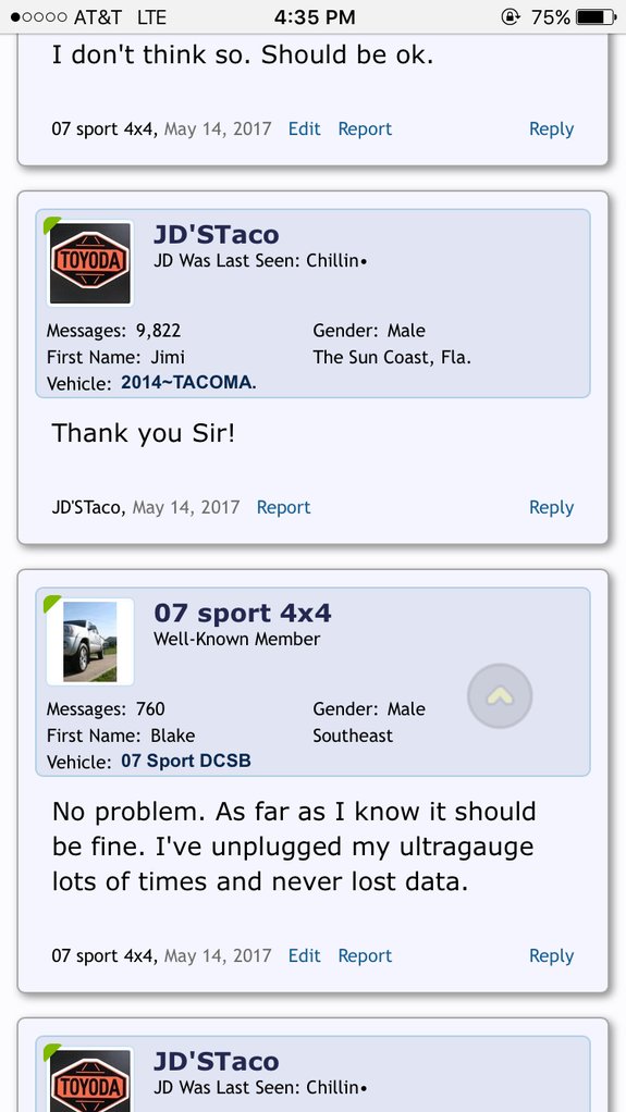

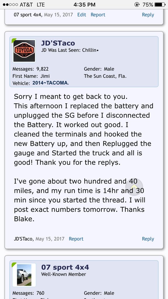

    Does it lose your previous data when you
    Unplug it ? Or does it retain it
  20. Jul 18, 2017 at 1:37 PM
    #20
    07 sport 4x4
    07 sport 4x4 [OP] Well-Known Member
    Dec 24, 2010
    #48165
    1,453
    Blake
    Southeast
    2017 Duramax

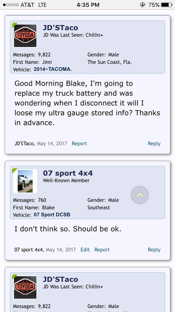

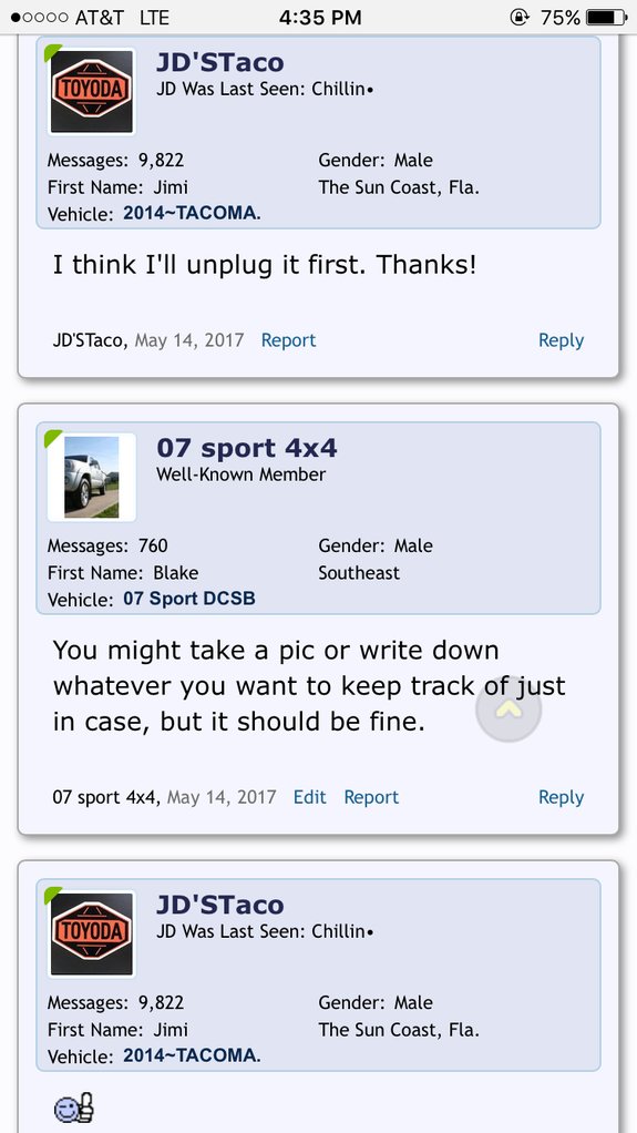

    I've never lost any data by unplugging it, if unplugged for an extended period of time, maybe.... but I don't know for sure.
