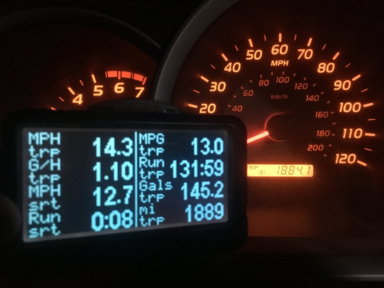

    I'm currently at about 132 hours and 1884 miles (according to the odometer). My ultragauge says I've been 1889 miles...
    This OCI was started on 4/17/2017 (130 days ago), so I'm averaging just a little over an hour of runtime per day and going ~14.5 miles per day. I usually have a lower MPH average, but I've been running around more here lately with various projects I have going. I might run this OCI until around mid October and see how many hours I rack up until toyota recommends an oil change per their 5k/6 month recommendation. I might pull a sample and send it in when I change it, I'm curious to see what the sample @Murphinator sent in looks like on paper. I've got more runtime than him despite having way less miles on this run. I'm running Mobil 1 Extended Protection and an OEM Toyota filter, in case anyone was wondering.
    I've been doing some thinking, Mobil 1 EP is supposed to be good for 15,000 miles or 1 year. If the average person drives an average of 30 MPH, in theory this oil should be good for a 500 hour run?

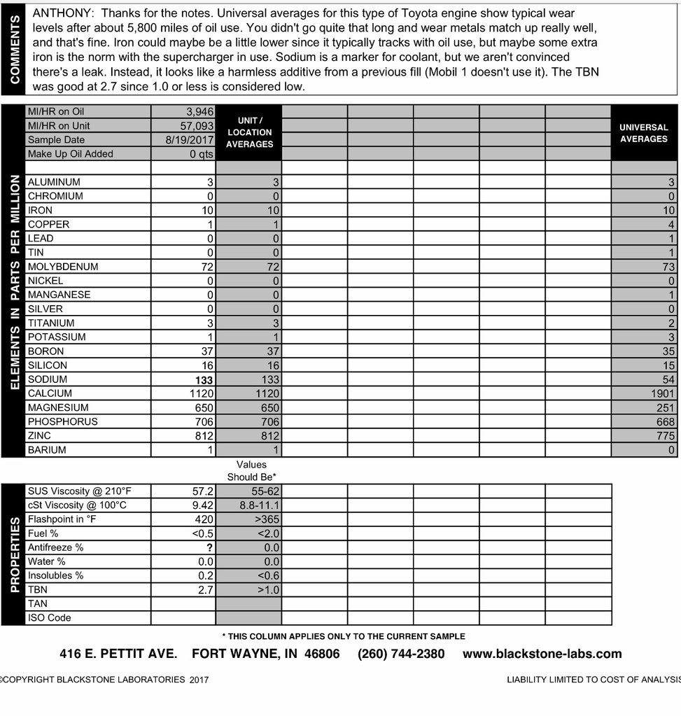

    Very interesting. If I see some in the stores around here I might pick some up. I was pretty hard on my truck that last oil change so overall I'm not too disappointed in it. I was only going to test once a year but since blackstone sent me two more sample kits I think I will test it again next change.

    Hopefully the sodium was just a fluke or something, have you been using Mobil 1 consistently? I'm using the EP version and have been for the last couple of years. Prior to using the EP I was using the standard Mobil 1 full synthetic... but the EP started being the same price and at one Walmart in my area it's actually cheaper sometimes, so why not? I broke my truck in on Dino (Penzoil Yellow Bottle) 5w-30 at 5,000 intervals up to about 30 or 35k, that was when she was new and never left the pavement... now she lives on a gravel road and goes off-road almost daily. I'm tempted to just use a cheap conventional and change it every 100 hours. I'm thinking 5w-30 for the summer and 5w-20 in the winter, especially since I don't usually tow anything in the winter anyways. There was a TSB for these engines saying that 5w-20 was fine to use in place of 5w-30.

    Unforentately I do not know what oil has been put into this truck before the sample I pulled off the mobile 1. Purchased at 47.5k miles (dealer changed oil before I bought it). Then when the super was put on at 50k the dealer changed it as well. Then after 3k i changed that oil for the mobile 1. Right now I am running a mix of mobile 1 EP and high mileage. (Wal mart was remodling and was pretty much out of all their oil, it was the only stuff I could get).
    I just got a work truck recently so now my truck will be putting a lot less miles on. I am going to do my next change at 3,000 and I will send in another sample. Hopefully the sodium drops. Next oil change i kight drop the oil pan and clean it out. Maybe let the truck drain over night. Probably way over kill, but I'd liek to have clean oil. If they still made 2nd gens when I bought my truck I would have bought new. It is what it is. Time will tell.

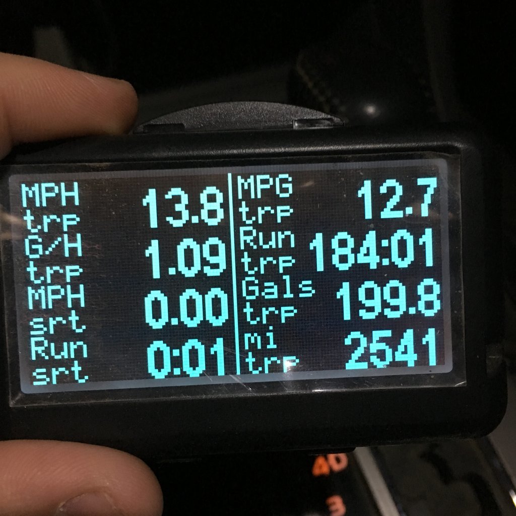

    I hit six months on this OCI yesterday. 2,533 miles according to the odometer.
    184 hours, avg speed of 13.8 mph.

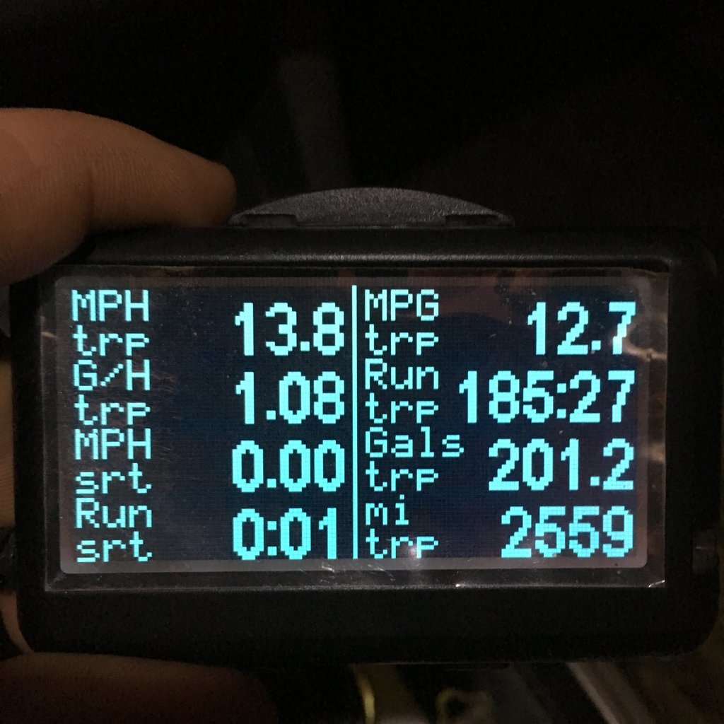

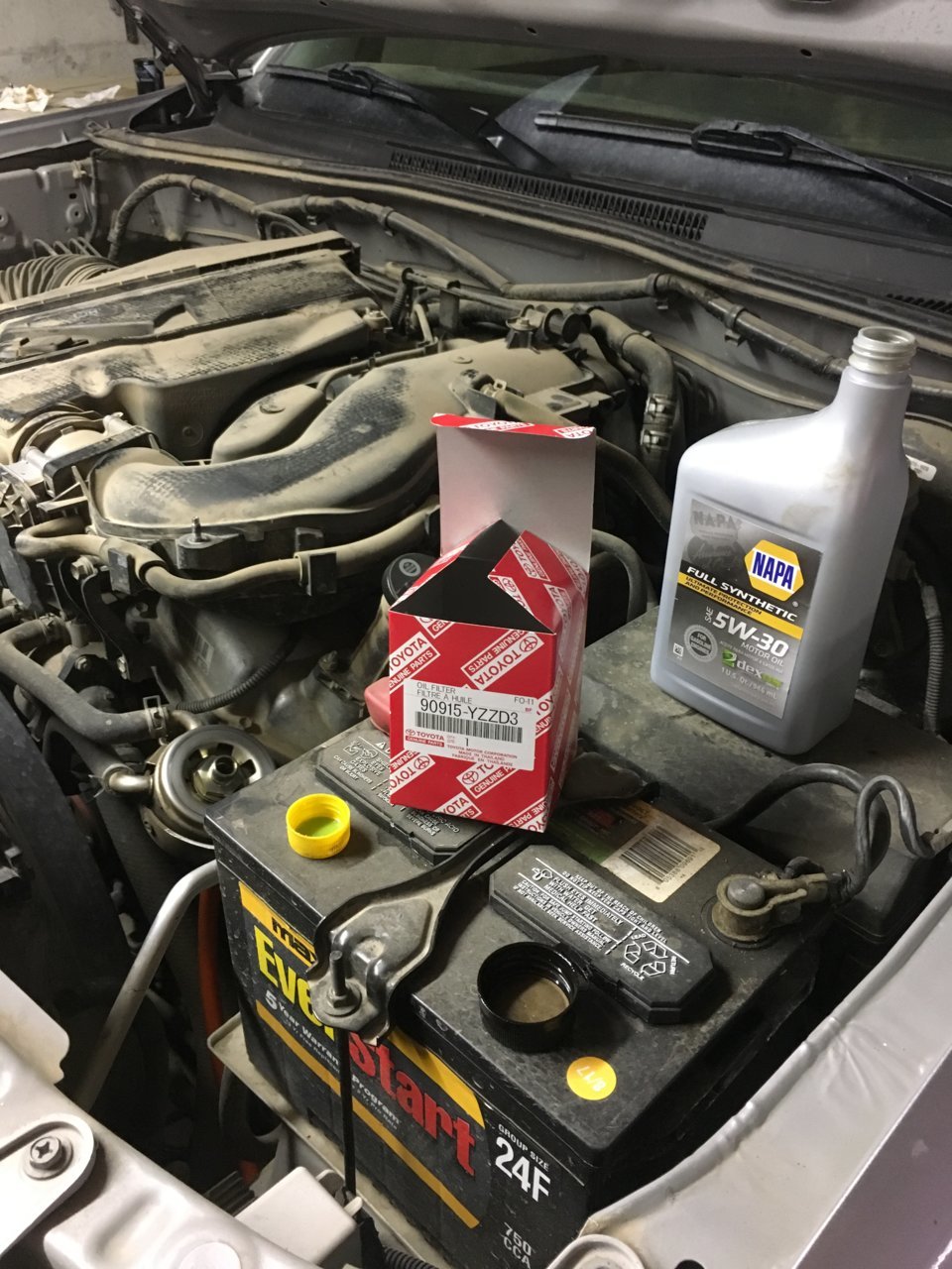

    I went ahead and changed my oil since I was at the 6 month mark. I went with penzoil platinum this time instead of my usual mobil 1 extended protection. Only reason being that I had it sitting on the shelf... bought it for my sisters car and also had mobil 1 already bought... she wanted the mobil 1. I'm fine with that, the platinum gets good UOAs from what I've seen.
