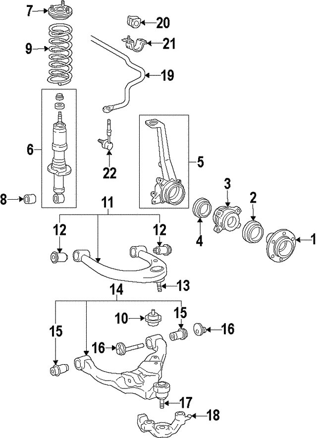

    I have been struggling to find the root cause of a clunk/pop that I am hearing at full lock in reverse and I have found the component that is causing it.
    Yesterday, I went to get an alignment and the tech said my driver rear cam bolt was stripped so I went to Toyota, bought a new one and installed it at home. I tightened it down with my 25" breaker bar and took my truck for a drive. Tested in full lock reverse scenerio and the popping was quieter so I got back underneath the truck and tightened it some more. As expected, the popping was very subtle now. So I got back underneath and tightened a bit more... and i noticed that the nut just keeps spinning with out increase the thread count so it isnt tightening anymore.The cam bolt can move in the tabs with easy now. The passenger side is tight and I physically cant tighten it anymore. The popping is definitely on the driver side so I am pretty confident that this stubborn cam bolt is root cause.
    My questions are as follows...
    1. Why is a brand new OEM cam bolt stripping so easily by hand?
    2. Why is the brand new OEM cam bolt not fully tightening?
    3. Any recommendation on how to fix this problem?

    Part #16 on the provided diagram is the cam bolt in question

    it's not clear that you replaced the bolt AND the nut? maybe the nut is the problem?

    I replaced cam bolt and nut.
    I just installed a new cam bolt, nut, and cam tab. I also hammered in the back side of the LCA mount and straightened up the tabs. SO FAR, SO GOOD. I will report back tomorrow after another alignment

    my guess is that maybe the mount was bent a few degrees and preventing a strong, tight lock on the lca

    The popping is back... I am thinking my tabs have filleted open again. I will reinspect tonight and think about welding a bead behind them

    update - I have welded a bead behind the cam gussets to prevent them from filleting open. I have also rechecked the torque on all the bolts. Since this procedure, there has been no popping. So far, so good!
