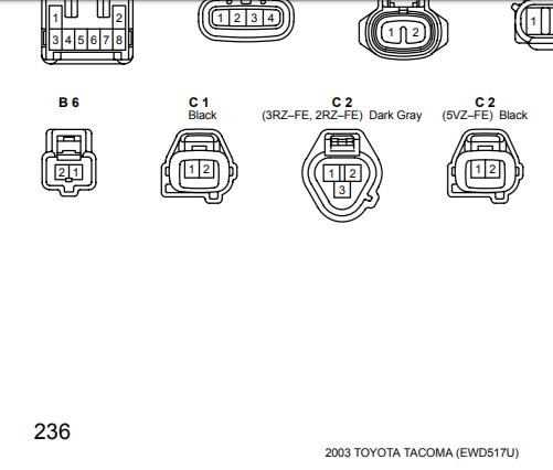

    Yeah, sounds like the waterproofing o-ring on the connector may have gotten dry rot and/or fallen apart. Have you ever pulled it off? Just asking because disturbing ti if it is brittle, you may have set yourself up for some water getting in there.
    This is from the 2003 FSM:
    C 1 Camshaft Position Sensor 90980–10947
