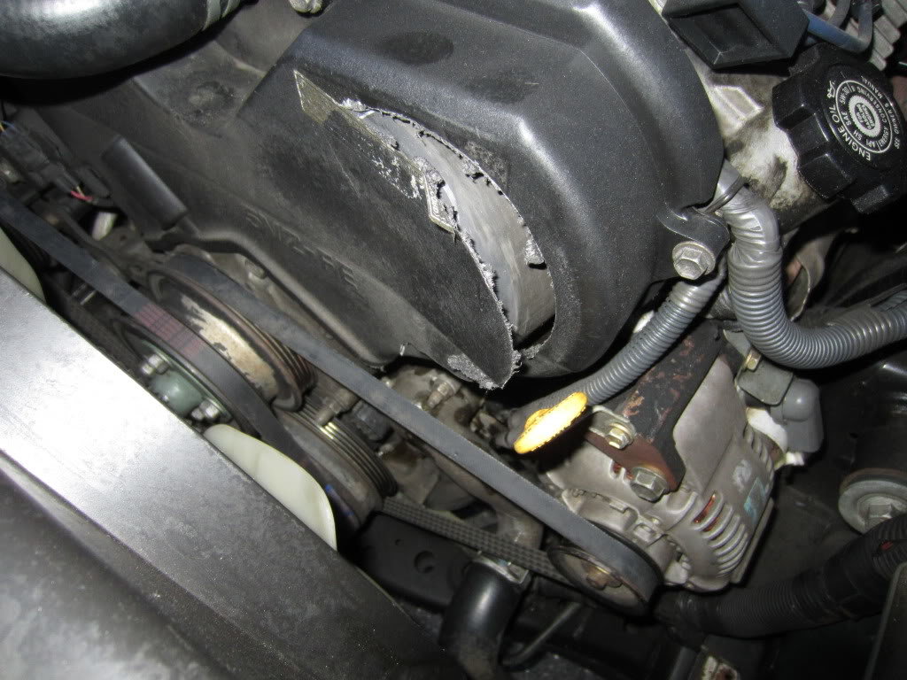

    Hi,
    I'm a brand new member and have a big problem.
    just bought a used 97 taco. On the way home from the seller the pulley on one of the camshaft launched itself half way through the timing belt cover.
    So rather then piss and moan about it or the seller I would rather focus on fixing it.
    Yes the truck had a clean carfax and passed my OBD reader, had the timing belt and w/pump replaced and was regularly serviced @ a dealer.
    It has 96 thousand miles and was an estate sale.

    Could be as simple as the cam pulley bolt failing and separating from the camshaft.

    Oh shit dude, the pulley set screw cam loose and it came of the cam shaft. You will have to re-clock the cam, and retighten the set screw, as long as none of the valves got hurt. Not sure if the 3.4 is non-interfering or not.

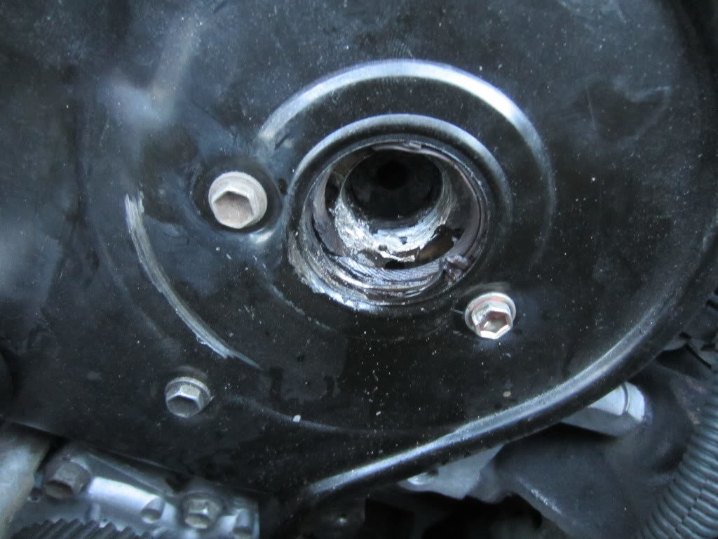

    Here's what it looks like in back of the cover:
    I recommend going to the dealer. Find out when was the last time the owner had the timing belt changed. Supposed to be done ever 90k

    The guy that worked on it last didn't tighten the bolt that holds the pulley on and it fell off. You should be able to get a new bolt and maybe new pulley. Worst case scenario is it needs a new cam due to messed up threads.

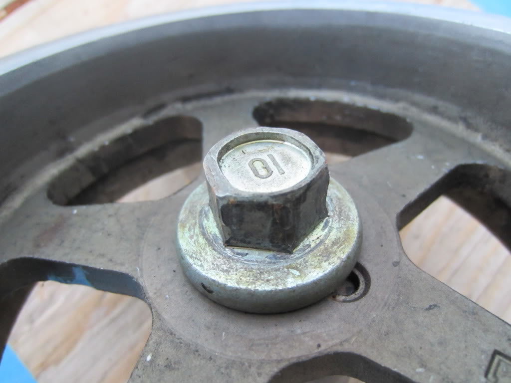

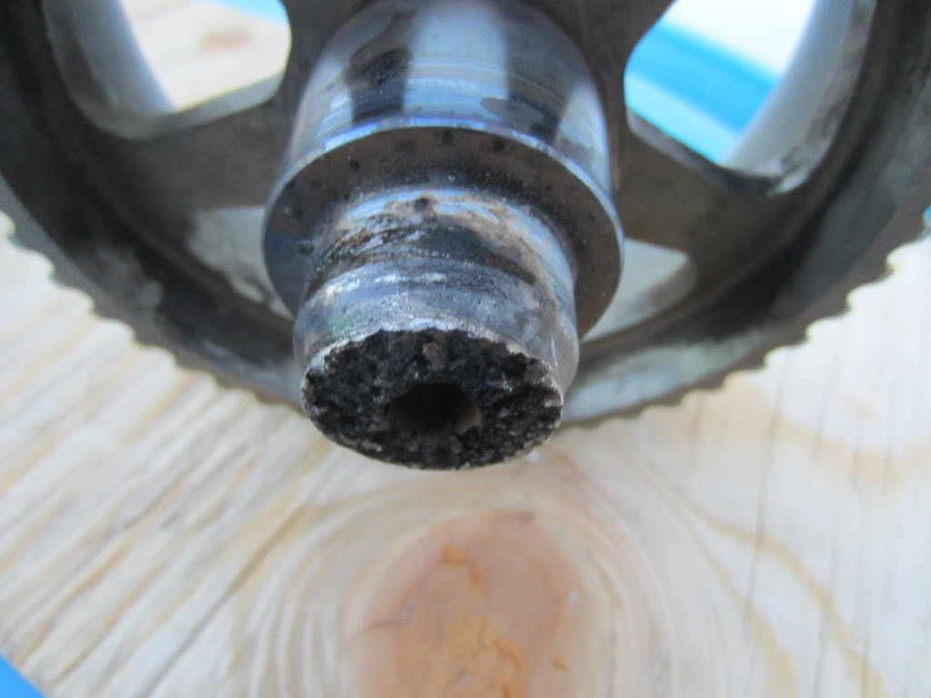

    Got it home yesterday and proceeded to take it apart.
    The thing that caught my attention was the damage to the cam pulley bolt, looks like a bit of force was used on it.:eek:
    I guess its on to removing the heads now.
